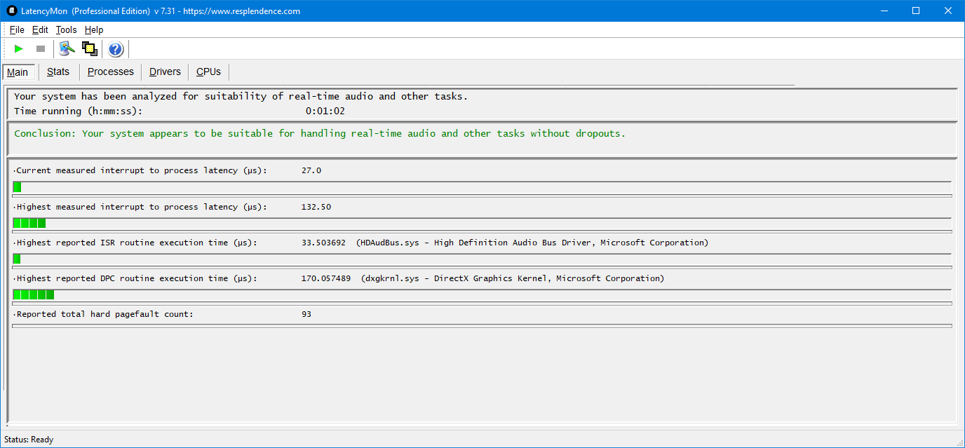

This particular kind of mouse "lag" is the same one I've been dealing with for the past 4 years.
I don't want to call it "lag" because, strictly-speaking, this isn't a latency issue, but it seems to be a variable sensitivity and/or variable movement report-time. This happens with a variety of mice too, and on a variety of computers (all affected machines have Intel CPUs, I have an unaffected machine with an AMD processor; all machines are running Windows 10 22H2).
I know that moving the mouse very slowly (e.g. 1 mouse-unit per second) will result in MouseTester reporting very slow frequencies - but I get this 250Hz and 125Hz (and oddly, ~167Hz too) when I move my mouse at a reasonable natural speed which should always be reported at 500Hz.
I am aware of XHCI moderation, but the minimum moderation interval is 250ns - but 250Hz is 4ms (quite a few orders of magnitude higher!) - but also because I purchased a StarTech USB 2.0 PCI-Express card (USB 2.0 is EHCI, not XHCI) and I can reproduce the issue when my mouse is plugged into either the USB 2.0 card or my motherboard's USB 3.0 ports.
I cannot reliably reproduce this on-demand, but it tends to happen throughout the day, then be fine for a few days, then reappear again.
Obligatory list of things to mention:
  • Issue started affecting me around October 2019
  • It happens regardless of the mouse model I'm using (Razer Basilisk V2, Logitech G400, Logitech MX518, some random no-name mice, and interestingly, also it feels like the PS/2 touchpad in my laptop is affected too)
  • Affected computers of mine:
    • Intel NUC 11 (with Intel i7-1165G7) built in 2021
    • ASUS Z490-E (with Intel i7-10700K) built in 2020
    • ASUS X99 (with Intel i7-6850K) built in 2016
    • Dell XPS 9560 (with Intel i7-7700HQ) built in 2017
  • Unaffected computers of mine:
    • ASUS X570-E (with AMD Ryzen 7 2700X)
  • Issue is reproducible in both USB 2.0 ports in a USB 2.0-only card (this card from StarTech) and in USB 3.0 and USB 3.1 ports on all affected machines.
  • Issue happens with Intel CPU-integrated graphics, and with NVIDIA GeForce, AMD Radeon, and AMD Radeon Pro GPUs.
  • It definitely is not EMI or anything like that (because it also happens on my XPS laptop when I'm in the outdoors, or anywhere)
  • LatencyMon Pro 7.31 shows nothing unusual even when I can reproduce the issue
  • The older dpclat.exe seems to think there's a 1000us latency, but given the age of the program ("DPC Latency Checker V1.4.0" is from 2015) it predates Windows 10 entirely and I understand MS made changes to how applications can access system timers since then.
  • I have fiddled with EFI and Windows boot settings (e.g. HPET, UsePlatformTick, DisableDynamicTick, and the rest, to no effect, and I'm familiar with this article too).
  • Disabling/removing all networking hardware made no difference (so the first person to say "bufferbloat" unironically gets a stabbing).
LatencyMon Pro 7.31 - max 170us.png (30.19 KiB) Viewed 7723 times

you have a high dpc / kernel timer spikes. But try to use another mouse (1000hz).
show your msi v3 tool screen.

I forgot to mention in my post that it also happens regardless of the model of USB mouse I'm using (Logitech, Razer, a few random no-name models, etc).
Slender wrote:
24 Sep 2023, 22:34
I hadn't heard of this tool before, but I gave it a try just now, this is what it shows me:

TooManyPixels wrote:
24 Sep 2023, 22:45
Slender wrote:
24 Sep 2023, 22:34
Slender wrote:
24 Sep 2023, 22:34

try to enable all checkbox and reboot pc
edit: im see you use bloated windows, try to install ggos (if you dont play faceit), or use latest revios 10.

I've done that just now (and rebooted) - it does not seem to have made any change at all.
After rebooting.png (1.38 MiB) Viewed 7616 times
I would like to hear your explanation of why the older (2015) "DPC Latency Checker 1.4.0" seems to think I have 1000us DPC latency when LatencyMon (rebuilt for Windows 11) says the opposite (even worse: the 2015 program is a 32-bit x86 program, so it's already running under WoW32 on an AMD64 environment, so it can't possibly be showing accurate data.

you need to change option in latencymoon to check Kernel timer latency, because dpc lat.cheker check it.
Dpc lat. use timer call from driver, that is reason why when dpc lat open your kernel timer latency is decrease. Anyway, your problem that be cause by bios, or windows. Im highly reccomended to change your os to ggos, and test it, if same - that 99% about your motherboard (bios/settings/hw issue, etc).
my 8000hz mouse have same problem on 8000hz (it drop to 4000-2000-1000), but if im use 1000, or 2000 - problem is resolved.
you have same behaivor on 1000hz?
try to disable amd gpu driver.
