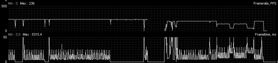

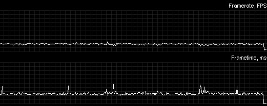

Long story short, the worse or more sporadic the frametime performance is in a game, the worse the near-black OLED VRR flicker will be.
The only way to avoid this on current-gen LG OLED panels during VRR operation is to use an external limiter like RTSS to set an FPS limit that can be sustained 99% of the time in the given game.
I.E. you want the RTSS limit to be the framerate's limiting factor the majority of the time. As long as it is, RTSS will stabilize frametime performance, which should reduce the near-black flicker to a minimum.

I'm saying the causes and nature of VRR flicker are different for OLED than they are for LCD.KanjiEater wrote: ↑04 Feb 2023, 13:52Thanks for the responses. I think this is the near black level flicker. Are you saying black level flicker and LG Oled vrr flicker are different?
You had said "brightness" flicker, which is more common on LCD, whereas near-black flicker is typically exclusive to current-gen OLED, but it now sounds like we're talking about the same thing in this case (near-black flicker), so it was just semantics.
Again, for OLED, you need to ensure rock solid frametime performance to reduce its particular form of VRR flicker. It's what I do on my LG CX.
The fact that you weren't seeing the flicker in some games just meant they had above-average frametime performance out-of-box, like Horizon (which I also own), where the developers have prioritized pre-compilation of shaders and minimal asset loading stutter during traversal.

As I noted previously in this topic, with current-gen OLED, this form of flicker will happen during VRR operation whenever the frametime performance is sporadic enough. It's not directly framerate related.pzkY wrote: ↑30 Mar 2023, 08:39When you boot up Hogwarts Legacy, the first thing you see is "Preparing for shaders" with a black background. Which flickers already.
Afterwards, it's in the game as well if your fps are low enough compared to your set refresh rate (my PC runs the game at 50-60ish).
The only solution I found so far was lowering the Hz to 60, which then feels the same, or even worse, as without G-Sync at 240 Hz.
You'll need to determine your 99% sustainable average framerate (per game) and cap just below it with RTSS to ensure steady frametime performance during VRR operation, which should mitigate the near-black VRR flicker to acceptable levels.
We OLED gamers have been dealing with this issue since the release of the LG CX TV in 2020 (where VRR support was first officially introduced on OLED).
Your old model didn't exhibit the near-black VRR flicker because it wasn't an OLED panel.
As for the G-SYNC module, it has no control over this issue, since it's an OLED panel operation limitation. The module is only responsible for general VRR, LFC, and HDR operation on OLED.
