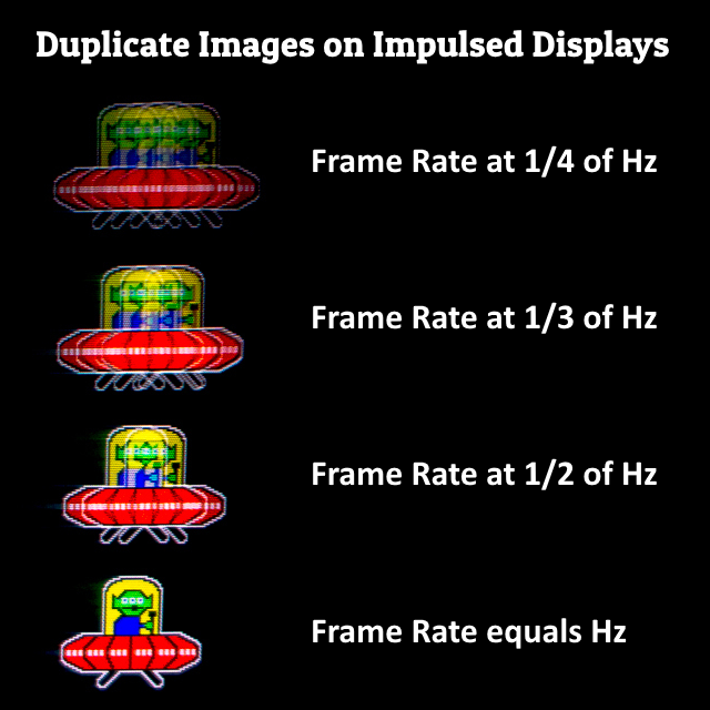

As for why you'd want the framerate to match the refresh rate on impulsed/strobing displays I was able to find this chart explaining that it's to reduce "double-image" artifacts that while observably similar to crosstalk artifacts when using blur reduction tech on LCD's aren't necessarily the same (for sake of this discussion we'll focus on persistence as reducing crosstalk when using blur reduction tech on LCD's is a separate discussion altogether)
This actually a photo of a CRT.
But it's exactly the same for short-persistence strobed backlights.
Doesn't matter what impulsed display (plasma, CRT, strobed LCD, BFI'd OLED etc) but if you view the coverpage of www.testufo.com you will see similar effects. You may get more/less motion blur per strobe.
Correct. That's why you want framerate=Hz to keep framerate=stroberate to avoid duplicate images.
For LCD, double images are caused by frames being visible more than once per flash, for multiple independent reasons:
1. Non-strobe-crosstalk reason: Frame being flashed multiple times
2. Strobe crosstalk reason: Frame visible because LCD GtG was longer than one refresh cycle.
3. Both of the above simultaneously (even worse; usually a triple image effect since crosstalk is a lagbehind effect on the most recent flash).
