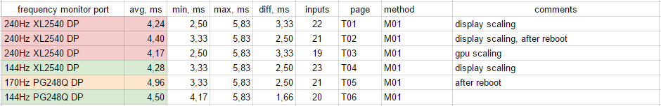

I have done some tests with my new method with BenQ XL2540 and Asus PG248Q. Simple directx9 app (thanks blurbuster flood a lot!), vsync off, high fps. dunno why but I get only 6000-6700 fps depending on refresh rate.
Left mouse button changes screen color to black, right to white. raw mouse input. Camera captures black to white transition and LED at right mouse button.
Results are:
I highlighted only same refresh rate.
app source: http://pastebin.com/XyfhU5nE
1200fps videos: https://drive.google.com/file/d/0B_8ge_ ... sp=sharing
Next step is to make tests on both monitors at Quake Live. Quake Live because I perform much better at PG248Q at 170Hz than XL2540 at 240Hz. Values will higher for sure. max fps 250 is one of the reasons.
May be Quake Live engine (not directx9) works wrong at such high refresh rate. May be almost same full input lag (mouse button to pixel latency) affects my aim and overall feelings. May be I need to unbox and try GTX 1060 instead GTX 950...
Any ideas?

Q83Ia7ta wrote:dunno why but I get only 6000-6700 fps depending on refresh rate.
to get 16k i run at 800x600
But yea, the results are very weird. I felt like if the monitor was made correctly it would have less latency.
Can you please send me the compiled windows version of your build, i would love to see if i can get that low latency with my mouse click, you using rinput or something?

Q83Ia7ta wrote:Next step is to make tests on both monitors at Quake Live. Quake Live because I perform much better at PG248Q at 170Hz than XL2540 at 240Hz. Values will higher for sure. max fps 250 is one of the reasons.
Any ideas?
Maybe its because of ghosting that you perform a little less with the benq I read in the hardware.info review that some pixel transitions took longer then 4ms. I think the asus also had a similar problem if you would run it at 180hz instead of 170hz. Could be if you tinker with the refresh rate or the overdrive it plays as well or better then the asus. It would be very strange if the monitor refresh rate influences a game that is not run with vsync and I have never heard of such a case. Skyrim and fallout behaved wrong with high refresh rate screens because they depended on vsync as their fps cap but quake does not care about that as far as I know.

nice work Q83Ia7ta
please keep us updated if you find out why you are doing worse on the 240hz
from your tests it doesn't seem to be related to input lag since that panel is still the fastest, i'm surprised it's such a small margin compared to a 144hz monitor, by the way did you also test the korean 220hz monitor ?
Q83Ia7ta
Posts: 761
Joined: 18 Dec 2013, 09:29
Re: Measure button to pixel full input lag
Post by Q83Ia7ta » 23 Dec 2016, 08:31
dhaine wrote:from your tests it doesn't seem to be related to input lag since that panel is still the fastest, i'm surprised it's such a small margin compared to a 144hz monitor, by the way did you also test the korean 220hz monitor ?
I didn't test it because i dissasebled monitor and used panel with ZisWorks 240Hz DVI board.
