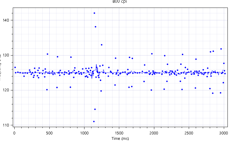

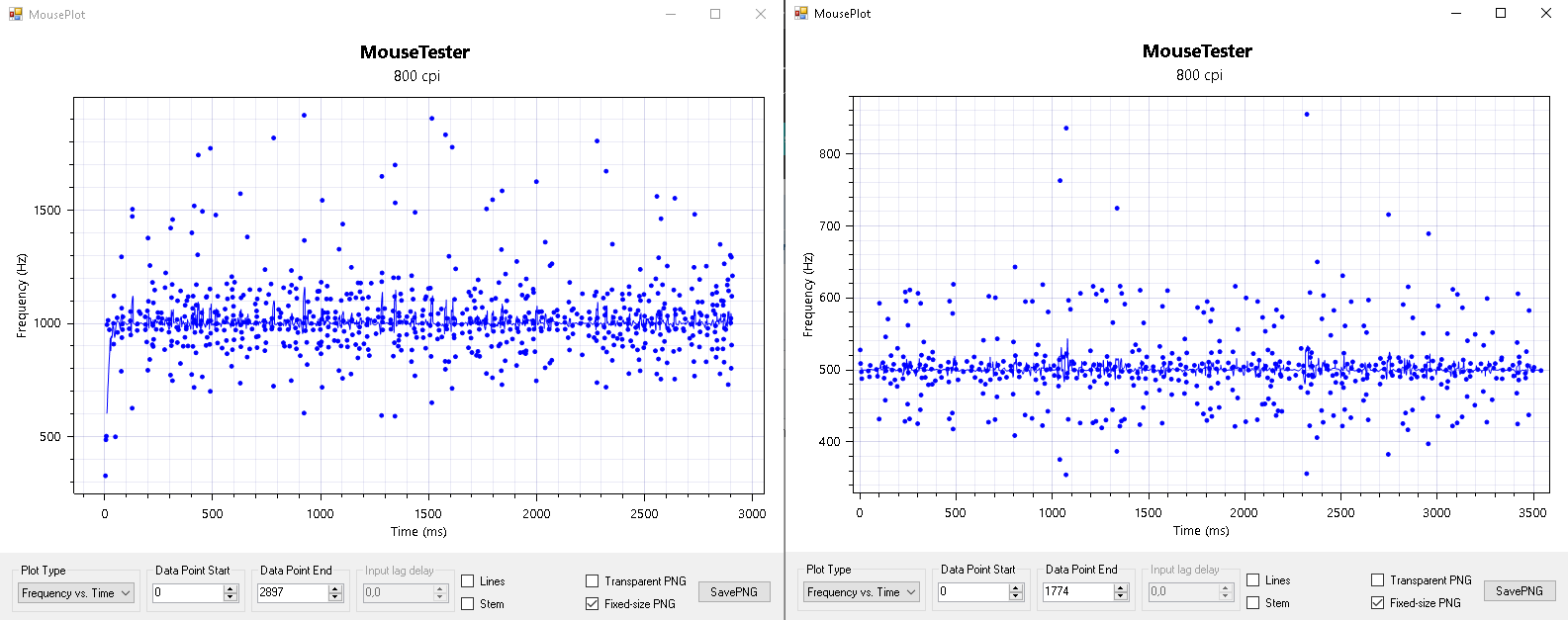

My mouse polling rate is jumping all around on different mice. (FK2, GPRO, MZ1, VIPER Mini) With all of them results are similar. Results attached below i consider "good", becaue they were achieved with everything on the background complietely disabled. Under load it can be much worse, with moustester showing spikes to 3000-10000+hz(how is that even possible?)
125hz looks like this

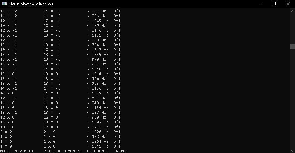

here is how mousemovementrecorder looks

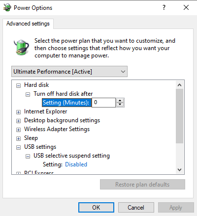

I didn't see any mention of your power plan settings, so make sure you're using windows built in high performance or ultimate performance (you have to add this plan via powercfg/cmd) plan. Go into the plan's advanced options and find 'USB Selective Suspend Setting' and make sure it's 'disabled.'

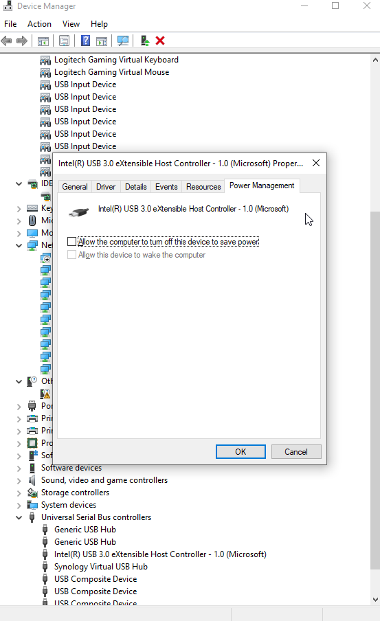

I also recommend disabling all power saving on USB devices which is done in device manager. Go to device manager and disable power savings for 'Universal Serial Bus Controllers' and 'Human Interface Devices.' Right click on every device and disable power savings for the ones that allow you to disable.

- USB SELECTIVE SUSPEND.png (18.5 KiB) Viewed 18641 times
- USB POWER SAVING.png (62.47 KiB) Viewed 18641 times

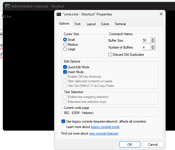

Use Legacy Console mode will show stable 1000 hz

- Screenshot 2023-09-06 224842.png (33.38 KiB) Viewed 15125 times
