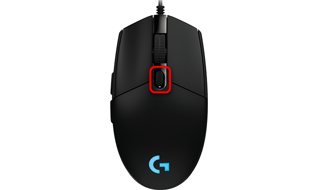

Hello. I've run into an annoying problem and have been struggling with it for a few years now.
Your mouse has several dpi values. Let's say 400, 800, 1600. You are playing at 800dpi.
After starting any game, I switch the dpi on the mouse with the button 3-5 times, then return to my dpi (800) and my mouse becomes sharper (input lag decreases). The mouse becomes sharper and more responsive at the same value of 800 as before.
Why is this happening?
I have tried different mice, logi, razer, zowie and see this effect everywhere.
I also tried different processors, intel i7 11700k, amd 5600x and everywhere the same effect.
I can't figure out why this is happening?
Each time after changing the DPI and returning to its value, the mouse works faster and sharper.
Can you test this on your mouse and computer?
