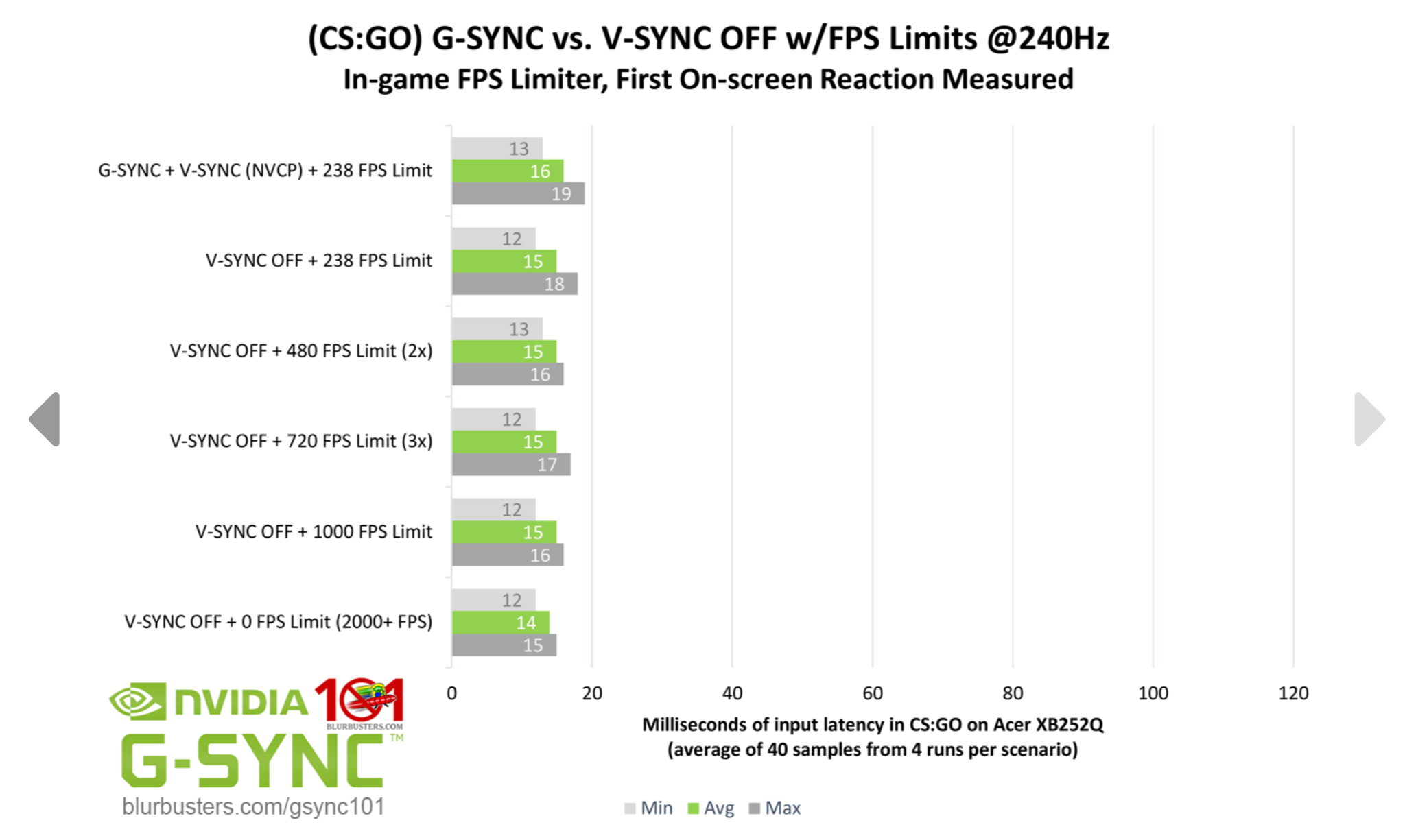

Strictly speaking to doubts of how low button-to-pixels lag can become....
I've seen mousebutton-to-photons latency of less than 10ms in CS:GO in some setups. Older Quake can be even less, given their capability to go 1000fps+.
Private conversations with multiple parties such as NVIDIA confirmed this can happen on the system side. So system is capable of becoming closer to a rounding error now. Even the older GSYNC 101 tests with uncapped VSYNC OFF got several 12ms button-to-photons latency results with the 1000fps high speed camera.
The video files are accurate on disk and single-frame-steppable, but when uploaded to YouTube, frames can get decimated. IIRC 40 samples per test for this graph (over 200 high speed video clip-segments made this specfic chart!).
So system part of lag can be nearly a rounding error in some highly optimized situations.
Web response-time speed tests are invalid due to Windows VSYNC ON compositing and browser framebuffering, so ignore web-based response tests, which will have far higher reaction time numbers than the well-oiled pipeline of older Quake-engine/Source-engine games which are capable of achieving subrefresh latencies in "several frameslices per refresh cycle" situations.
far in excess of refreshrate, can lead to subrefresh latencies nowadays in these older engines, especially at lower refresh rates. One can use peripheral vision to notice stimuli like full-screen injury-flashes that appears at other parts of scanout. So single-dot measurements are invalid here, as pro players already respond to stimuli away from gazepoint.
Remember, our video lag tests used "first-anywhere-on-screen" reaction, and not "first reaction at THIS pixel". So that lowers the numbers, and players have peripheral vision.
So thanks to VSYNC OFF, seasoned players reaction time clock trigger to an earlier random frameslice far away from X-hairs (like the first time something is flashing of a full screen explosion or a red-flash of an injury -- or even perhaps long vertical beam of a ray-emitting gun). So, there you go, subrefresh latency factor!
For those unfamiliar with scanout lag, see http://www.blurbusters.com/scanout
Current esports TN panels are capable of syncing cable scanout to panel scanout, for subrefesh latency at the display side, using only a tiny rolling buffer (few pixel rows) for processing and DisplayPort micropacket dejittering (microseconds league). And players eyes begin getting photons early in the GtG curve, e.g. 10ms GtG often have pixels visibly transitioned early in the curve, as per VESA response time computation - GtG does not need to be 100% before the human reacts to the pixel. So the reaction time clock can start to be triggered before full GtG. Now, the faster GtG, the less error margin this is, but this is mentioned for completeness' sake.
So, those are knowble error margins, and some games are now indeed confirmed capable of sub-refresh button-to-photons latency if you think carefully about all the above.

BTW, on my system, I was able to run Tearline Jedi -- with a Direct3D-drawn rectangle under the cursor in VSYNC OFF mode. I moved the mouse arrow while running at 8000 frames per second on the buffer underneath the mouse.
The mouse arrow lag (relative to Direct3D-drawn rectangle underneath) varied massively depending on how high on the screen the mouse arrow was -- indicating that the Windows mouse arrow behaved as essentially a VSYNC ON sprite that updated position only once per refresh cycle, with the underlying graphics capable of a beamraced-like workflow (VSYNC OFF frame slicing with tearlines). The lag varied as much as 16 milliseconds!
At 8000fps VSYNC OFFthe top edge, the software-draw was in perfect-sync with the hardware sprite cursor.
At the bottom edge, the software-draw mouse cursor was moving AHEAD of the Windows mouse sprite cursor (indicating that the Direct3D was lower lag than the Windows mouse cursor!!) Soft-cursor AHEAD of hardware-cursor by as much as a SHOCKING ~16ms at 60Hz (yoo hoo, lag scientists!) --
And that is an AORUS GeForce GTX 1080 Ti Extreme Overclocked. Not the kind of card you'd expect a hardware cursor to be more laggy than VSYNC OFF.
The software cursor was as much as 16 milliseconds AHEAD of the Windows mouse cursor, when at the bottom edge of the screen.
Also, not all drivers / not all GPUs may use mouse-sprites. Your driver/system/etc mileage may vary.
In an actual game, runs in rawinput mode so all 1000Hz is available much more freshly to the game, than is available to a browser. I've seen browsers do 1000Hz mice only once every 1/60sec, so a click can be much more lagged in a browser than in a game.
Even the new PointerEvents HTML5 API will often batch the 1000Hz samples in roughly 60 groups of approximately 16-17 events each, on a 60Hz system, so even those 1000Hz browser mouse events are somewhat lagged.
So....to zeroout system latencies as much as possible,
(A) Direct3D or OpenGL VSYNC OFF
(B) Framerates well above Hz
(C) Mouse raw input mode at 1000Hz with atomic non-batched events
(D) Software cursor or software mouse response (lower lag than hardware cursor in "fps above Hz" VSYNC OFF situations).
Or void, full stop, period.
To get subrefresh latencies AND avoid all the error margin shit that browsers do, and mousesprites do, etc.
Besides, even the LinusTechTips video with the SloMo guys, was as low as ~130ms in some of the samples. I confirmed that their test meets my A+B+C+D criteria, so I believe it, based on the information that I know, and my last few replies.
Certainly the territory outside of the system can be full of some unexpected error margins (e.g. network lag, human "predicting" behaviours, etc) -- and readers can easily misunderstand, misquote or misuse statistics -- which may have happened. Yes. That happens.
Olympics athletes can react faster at the starting line, AND there is already achieveable sub-10ms button-to-photon latencies in some real world game engines (old Quake engines, old source engines). The Olympics benchmark is a 100ms false start. Add 10ms to that given the known button-to-photons errorband can manage to get that tight in some situations. You've got 110ms. The 130ms numbers of the streamlined system (VSYNC OFF + fps>hz + software-cursor/draw + rawinput, OR ELSE) is well within this window, given the existence of both visual+aural stimuli.

That said, I think we need more esports research that factors.
- scanout and understanding how VSYNC OFF becomes accidental beamracing
- first-anywhere vs first-singlepoint
- stimuli differences (visual flash vs audio gunshot) and multi-stimuli that often leapfrog each other (flash, movement, audio, direct-gazes, peripherals, etc) in ways that low-end scientific equipment is not always measuring.
- the hyper andrenaline factor (esports gamers are often really pumped like a skydiver at their peak)
- researching unexpected predictive factors (identifying unidentified earlier stimuli that may be occuring before the stimuli, such as onscreen ammo number decrementing before gunshot flash, etc)
Etc.
