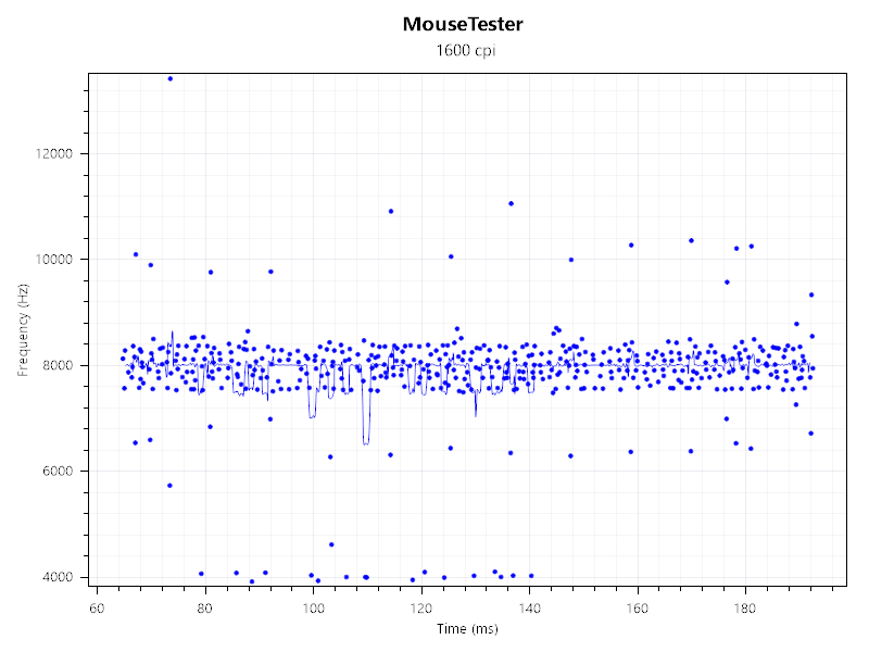

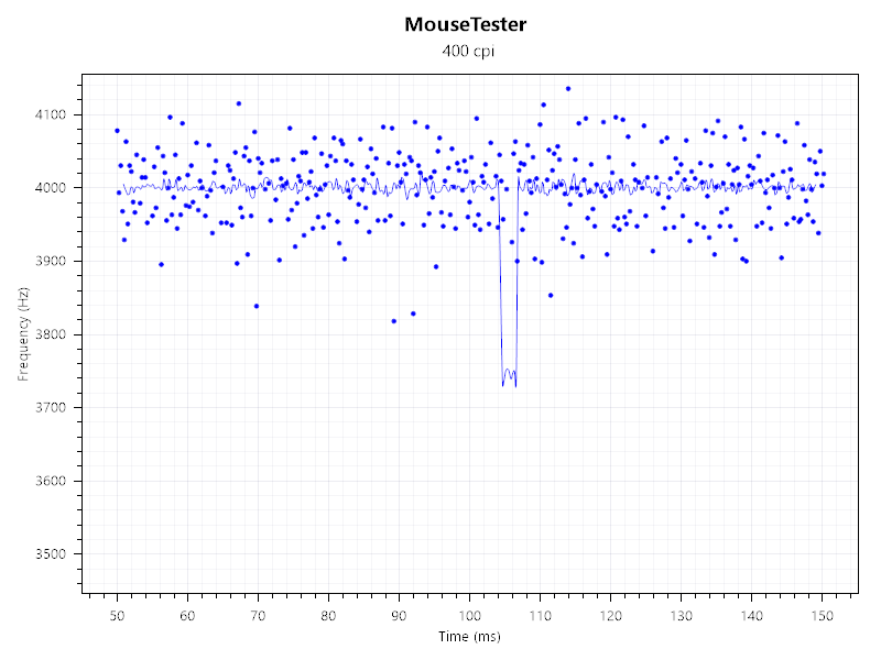

Here are the results of mousetester 1.5. On the OLD SETUP.
Old situation: Razer Viper 8K mouse straight to the Asus TUF GAMING Z690-PLUS D4 Z690 motherboard on the 3.2. Gen 2 USB port and the Razer Huntsman Tournaments 1000hz keyboard on the 3.2. version Gen 1 USB port:
4000 pollingrate 1600 DPI:
4000 pollingrate 1600 dpi alleen muis en keyboard. muis onder.png (59.08 KiB) Viewed 6090 times
8000 pollingrate 1600 DPI:
8000 pollin grate 1600 dpi alleen muis en keyboard muis onderlrechts en keyboard bovenrechtgs.png
8000 pollin grate 1600 dpi alleen muis en keyboard muis onderlrechts en keyboard bovenrechtgs.png (64.22 KiB) Viewed 6090 times

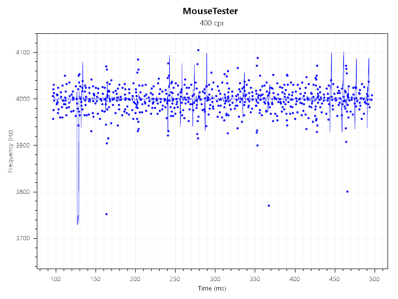

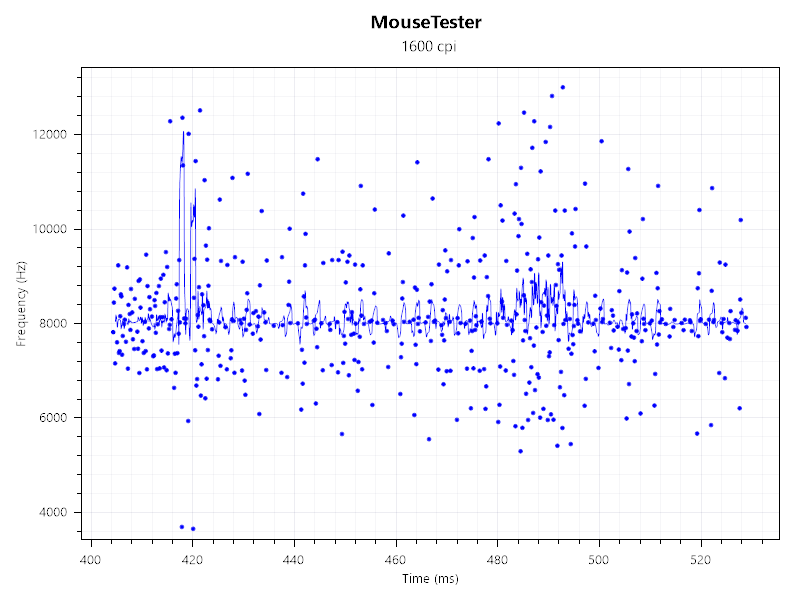

NEW SETUP : with the Razer Viper 8K mouse on the new PCIe Fresco Logic fl100ex chipset card & the Razer Huntsman Tournaments 1000hz
keyboard straight to the Asus TUF GAMING Z690-PLUS D4 Z690 motherboard on the 3.2. Gen 2 USB port.
4000 pollingrate 1600 dpi alleen muis en keyboard muisoprodekaart.png (47.41 KiB) Viewed 6088 times
8000 pollin grate 1600 dpi alleen muis onder op rode kaart keyboard boven.png
8000 pollin grate 1600 dpi alleen muis onder op rode kaart keyboard boven.png (50.87 KiB) Viewed 6088 times
I think the new setup looks pretty good especially with the 8k Pollingrate!! Now its time to give this setup a go! If u like to drop some feedback or advice: More then welcome! Tnx all! ( and tnx Chief especially! )
