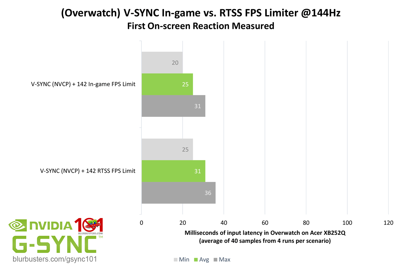

So yea, very curious for me! How accurate are this frametime readings? Because I remember seeing the article about Gsync - Input Lag on the site and on the tests it seems RTSS had more output lag then the ingame limiter: https://www.blurbusters.com/wp-content/ ... s-rtss.png
But with this tests.. RTSS on 144 FPS, Vsync ON and the refresh rate trick just made the vsync OFF and ON to have the SAME 6.9ms of output lag, which is just crazy oO..
