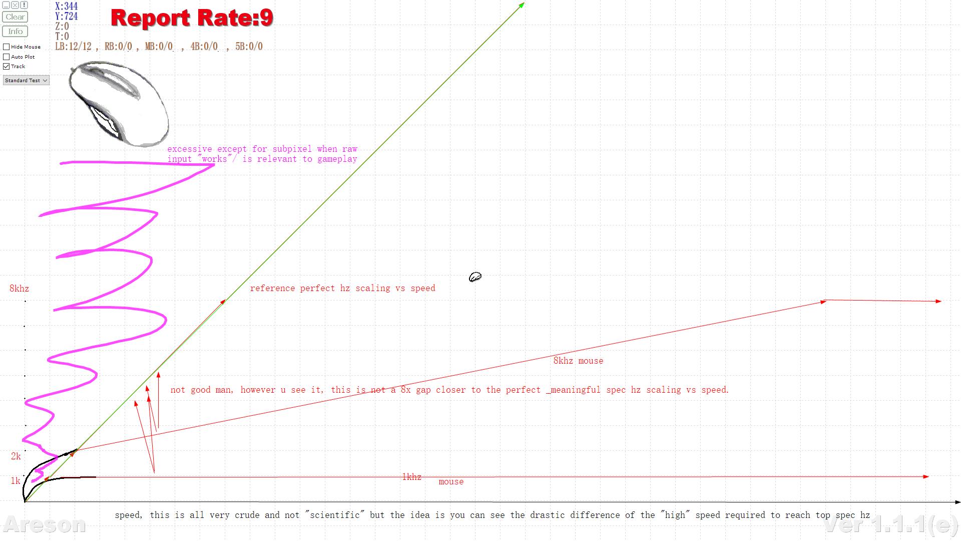

To bring things back on track, here's something less crude than what I drew in my last vid explaining why the hz to speed scaling isn't on par for this 8khz of Razer's
i drew this while having Overwatch in menu on background.
I have not discerned low vs mid vs high speed because that and the whole standard of it all obviously varies depending on user pref/usage scenarios.
Someone in comments added that as long as the left column in Mouse Movement Recorder is greater than 1x then "the hz is not high enough". (with 1khz it's easily 3 digits while 8khz is around 2 digits in high speed, While this graph is extremely digressive, that graph of counts vs speed would conversely be extremely progressive lol, if you already have the 8k try it yourself to see) While the first part is informative, I have to again remark that people's needs are different, and people who swipe a lot will benefit more visibly from a brute high hz, no matter what kind of wonky graph ratio is chosen. But the way it is set up now, the desired gap closing from realistic to ideal is much more apparent on higher speed--that is until 8khz is capped, because obviously the 1khz creature capped out long ago in much lower speed.
If it were all set up perfectly, there wouldn't be ANY ratio difference, since it would all be on the same line, just 8x longer. and then snap to horizontal "mute" again. (yes that would be my heart stopping at lameness because frowning on your own overcapped max IPS vs human capability is so ironic in this context). You see, when the graph curve ratio is wrong, it's not the problem of lack of tech architecture when you can already do 8khz, back then with 1khz you could argue that this digression makes capping out in low speed 'predictable" and smooth, and not too abruptly noticeable, which certainly would help since you want to feel like you are always "up there" even though it's not even needed at 90% parts of the time before 1khz is reached, at the lower lower speeds....well maybe only not for the basilisk users playing pubg since 2017 like me....IF overflowing is beneficial to enough scenarios and users, one might even say that as it stands, on a very limited low speed range, there might be indeed 8x "overflow", which I guess you can call it functional feature...AND in this case it's another aspect of 8khz doing intended work, but again there are many games where raw input is buggy, which may force switching down from 20kdpi to 5kdpi or getting used to a higher edpi all together to avoid lag. If one cannot achieve lag free pixel to mouse skate(see why i worded it backwards here subconsciously? because it should be equivalent!) response without janky accelerations and jitter no matter what, then this is not a problem of dpi or hz anymore, it's an outright broken mouse through and through for the specific discerning requirements. inferior mouse pad users and hand control limits are not supposed to bottleneck a better mouse design for others.
NOW you are SUPPOSED to go mute on the green line. If you have 650 ips you might as well have excessive HZ whatever that can be, so people will laugh at the green line going to infinity when in reality they are laughing at their none robotic arm
I should have probably smoothed out that mid section of 8khz a bit welp not gonna repost another edit..but the end mute is actually very generous here, as capping out 8khz gives around 10 pixels (and counting, but not actually very easy to get 2x 3x larger separation because the speed is already reasonably high u cannot hope to up and double it by swiping a bit faster) of dot read separation, where as on this graph it's like 3-4 times lower than ideal (density where it reaches not more not less than no visible dotting)
