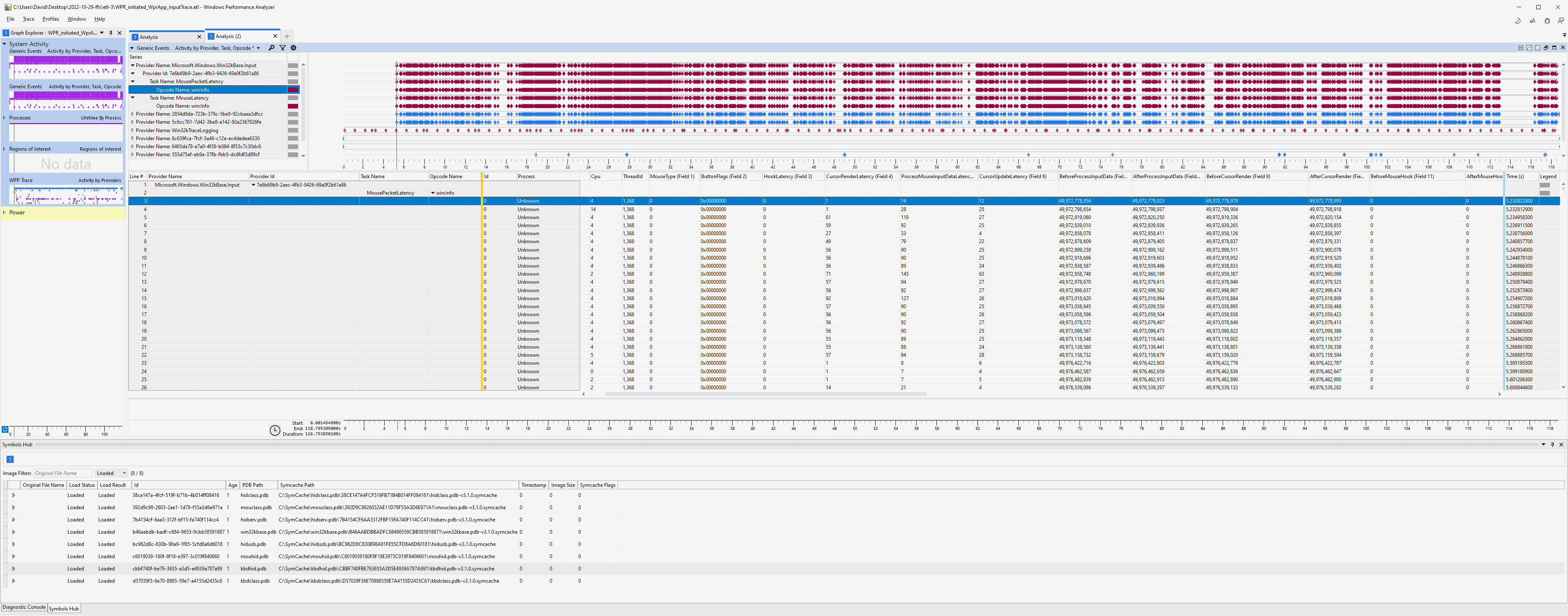

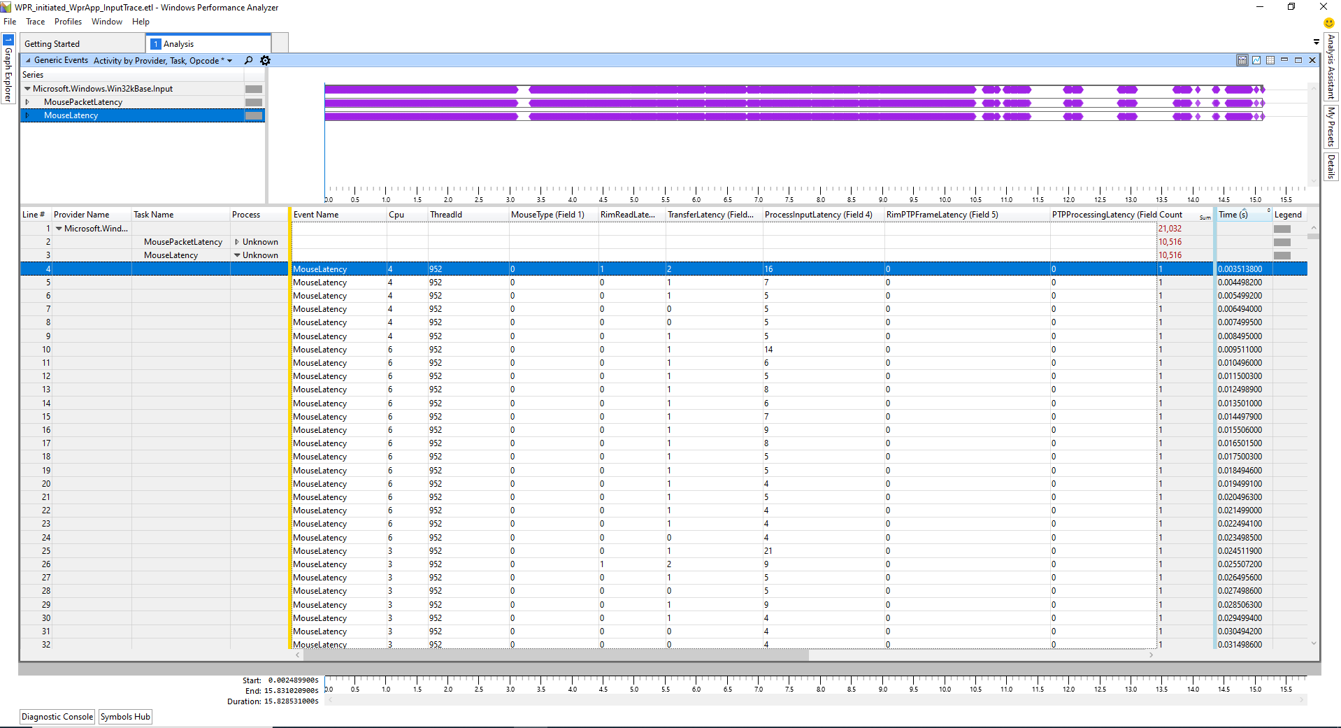

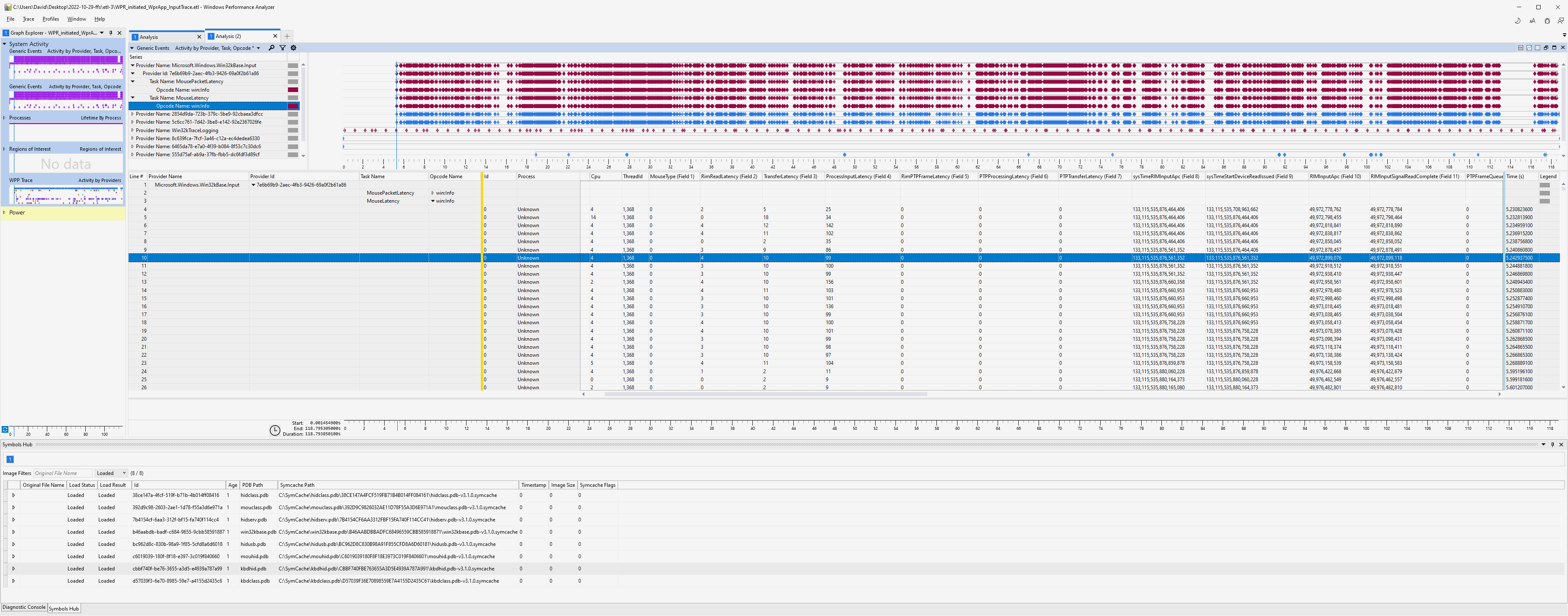

I'll start with my own:
This is what my trace results look like when my mouse is having a "bad" day (but I've had worse):
I have other traces taken on days when my mouse is feeling better (but still has issues); specifically, on good/"better days" the `CursorRenderLatency` values are significantly better than in that screenshot above.
I still don't have a clue as to the actua underlying cause, and I've been having this problem since late 2019 when this problem started without any obvious cause on a completely different machine - though all my machines have certain common hardware (e.g. Intel Core i7 chips made since 2016, all have ASUS motherboards (but different models) with stock Intel NICs on-board - which are also commonly reported by other people experiencing the same issue.
I'm also wanting to find out if it might be an issue or misconfiguration with USB or HID buffer sizes.
I also shelled-out for a very expensive USB 2.0 protocol analyzer which allowed me to figure out that part of the problem is the host PC waits unnecessarily before issuing USB IN poll requests to the mouse whenever the mouse slows down too much, and that unnecessary wait adds latency - but also that the length of the delay seems to be proportional to the mouse's speed right before it slowed down... or I could be misunderstanding things. Fun.

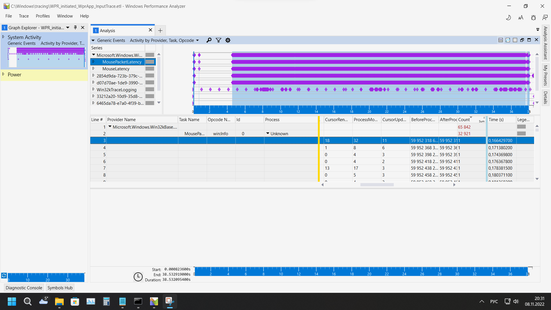

Thanks for the program, it really shows real mouse latency. I took small measurements in the evening (when the mouse feels heavy, about 50% input lag) and measured at night (when the mouse glides like on ice, 10% input lag).
That's what I did:
The first one stopped in the evening at 20.31, the mouse felt heavy, I estimate the input lag at 50% of the possible.
The program shows a mouse delay of 160ms.

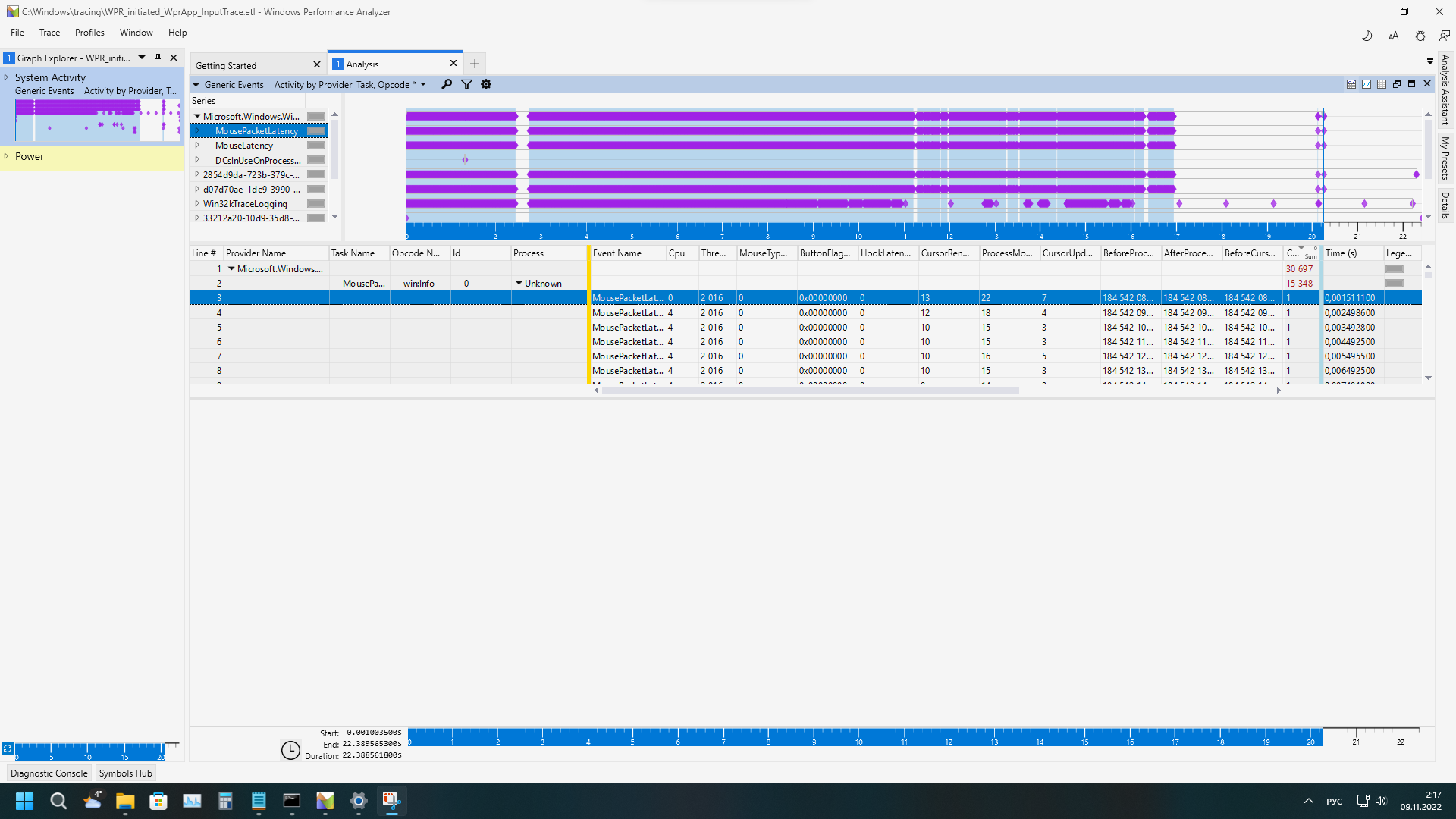

The second froze in the dead of night at 02.18. Usually at this time, the input lag almost disappears. The mouse is very sharp, I estimate the input lag at 15%
низкий инпут-02-18время.png (228.63 KiB) Viewed 9228 times

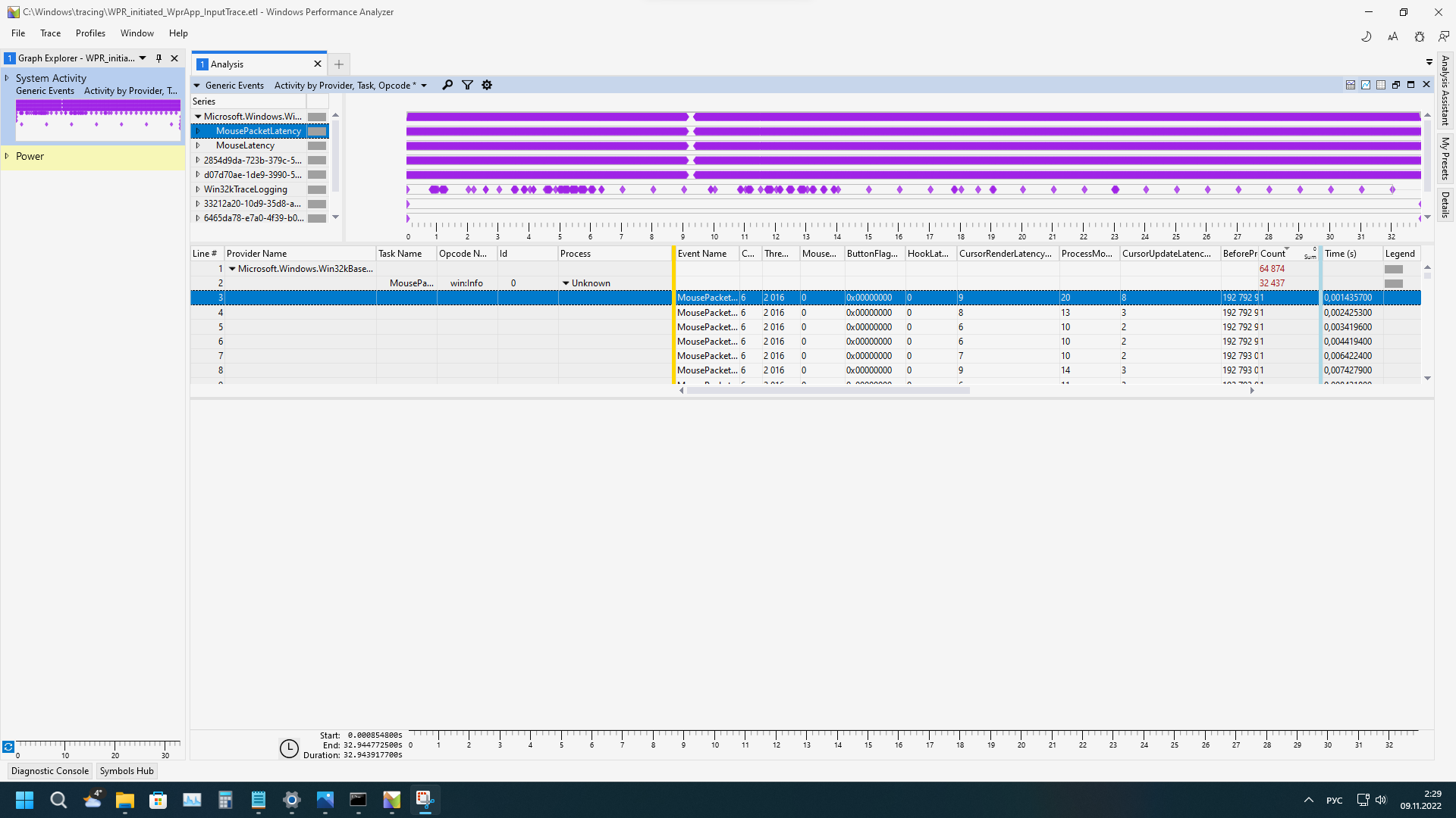

The third froze in the dead of night at 02.32. The mouse feels very sharp, as if sliding on ice. I estimate the input lag at 10%.
очень низкий инпут-02-28 время.png (201.86 KiB) Viewed 9228 times
These are all input lag measurements for today. I plan to take more measurements in the future. The program really displays the real delay of the mouse.
You just look at the difference between evening and night. In the evening my mouse is heavy and it is difficult for me to play, the delay is 160ms, and at night the mouse slides on ice, the delay is 1.5ms.
It's all due to bad electricity. I don't do anything with the computer, but it's impossible to play during the day and in the evening.
