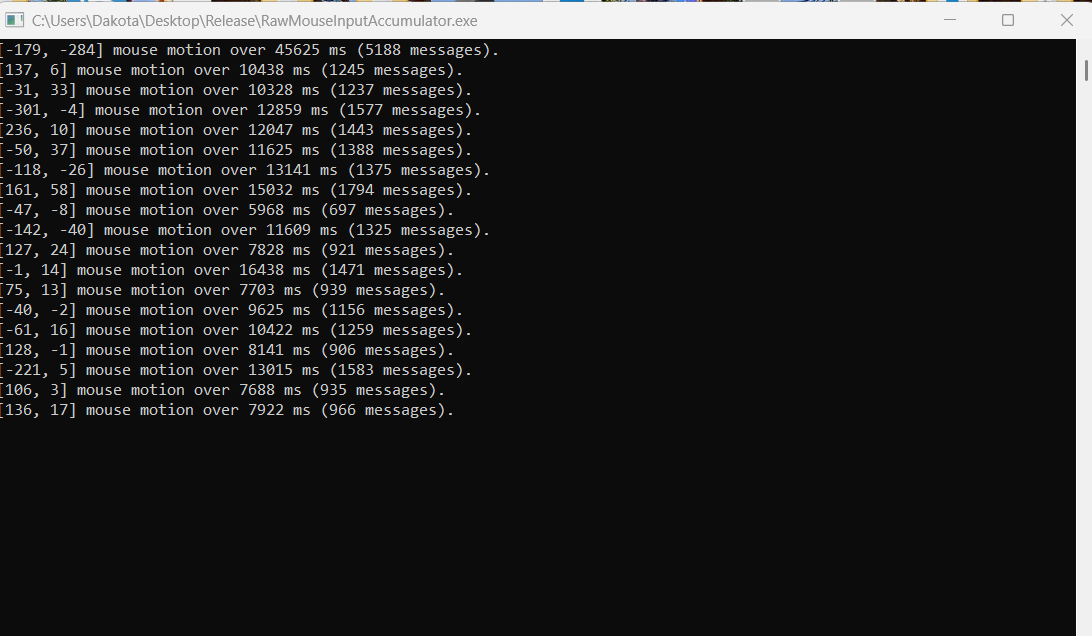

Hi all, I have been chatting to the extremely helpful microsoft engineer regarding the noticeable drifting that occurs due to prolonged movement.
He developed a tool that will gather raw mouse reported x/y until there hasn't been any for one second and then tell you the cumulative distance traveled.
He says “my theory/expectation is that if you perform a mouse motion like the one you did when you sent the trace, you'll see significant negative Y accumulation”, which is exactly what happened - https://youtu.be/rZzu4Qb9v0o
Afterwards, “at this point the issue is the mouse itself - the data that's being logged here are the literal values being reported by the mouse, without any OS processing done (e.g. to turn it into a cursor position).”
“so the question is, why is the mouse itself not fully tracking its y-position?”
Which is where we have concluded for now.

So I ran the tool on a laptop, where the touchpad was experiencing drifting too, but while the cursor drifted upwards, the -y did not accumulate.
Went into regedit touchpad settings, created the dword HonorMouseAccelSetting value 1 and the touchpad drifting stopped entirely.

I got these during tests while idle, moving mouse on desktop and sometimes in game playing Apex. I don't know what they mean.
[490, 113] mouse motion over 17140 ms (14301 messages).
[-4851, 565] mouse motion over 33266 ms (19823 messages).
[227, 221] mouse motion over 10875 ms (798 messages).
[460, -130] mouse motion over 17421 ms (11456 messages).
[-200, -90] mouse motion over 9500 ms (9504 messages).

Re: Mouse drifting confirmed.
Means very little due to the nature of your test and not knowing the exact movement of the mouse.
Best to open and make repeat mouse movements e.g. left to right over and over with your mouse retaining the same position on the pad.
