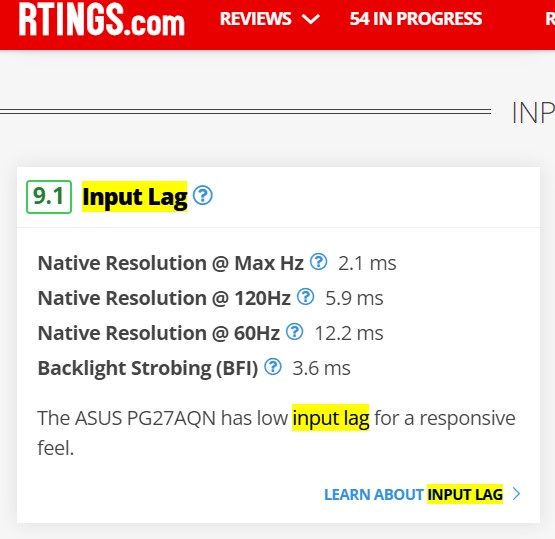

Hi,
I have a question on how to interpret input lag test result such as those done by RTINGS.COM, looking at the Asus PG27AQN's result for example
If I'm using the monitor with G-SYNC enabled along with a 60 FPS game like a fighting game, G-SYNC will match the refresh rate to the FPS I'm getting, does that mean that I will get the input lag of 12.2 ms associated with running the monitor at 60Hz or the 2.1 ms input lag as if I'm running the monitor at 360Hz because I'm using G-SYNC?

If you're running 60 FPS G-SYNC at a physical refresh rate of 360Hz, you'll get the input lag/processing latency of that physical refresh rate (aka the 2.1ms shown in the RTINGS review). You'd have to lower the actual physical refresh rate to 60Hz to get the 12.2ms.KALK4L wrote: ↑04 Jul 2023, 19:34If I'm using the monitor with G-SYNC enabled along with a 60 FPS game like a fighting game, G-SYNC will match the refresh rate to the FPS I'm getting, does that mean that I will get the input lag of 12.2 ms associated with running the monitor at 60Hz or the 2.1 ms input lag as if I'm running the monitor at 360Hz because I'm using G-SYNC?
G-SYNC controls how many times the scanout cycle repeats per second, whereas the currently set physical refresh rate determines how fast each of those scanout cycles complete.
So while 60 FPS 60Hz G-SYNC repeats the scanout cycle 60 times per second at 16.6ms per, 60 FPS 360Hz G-SYNC repeats the scanout cycle 60 times per second, but at a much faster 2.8ms per, resulting in an overall reduction of latency via faster frame delivery, regardless of framerate.
As @Boop already quoted, max physical refresh rate + lower framerates + G-SYNC effectively = a form of dynamic/auto QFT (quick frame transport) operation.

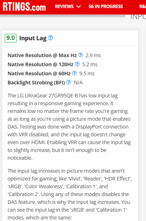

So, could we say that in practice while using G-SYNC with 60 FPS locked games the 360Hz IPS Asus PG27AQN could achieve lower input lag of the 240Hz OLED LG 27GR95QE-B (input lag results below) due to the higher refresh rate of the Asus monitor? (Asus 2.1 ms vs LG 2.9 ms)

RTINGs is testing specifically for monitor processing latency there, which can be separate/additive of system-side, sync, refresh rate, and/or framerate latency.KALK4L wrote: ↑04 Jul 2023, 23:52Thanks a lot, I have read your article before and it helped me a lot. I wanted to make sure I understood this correctly because I'm using this info with my purchase decision.
In other words, a 240Hz monitor can have less processing latency at 240Hz than a 500Hz monitor does at 500Hz and visa-versa, depending on the given monitor's display scaler, firmware, etc.
But yes, if the LG 27GR95QE-B has 2.9ms display processing latency (aka how much the monitor adds) at 240Hz, and the PG27AQN has 2.1ms display processing latency at 360Hz, then the AQN will have lower overall latency in your 60 FPS max Hz G-SYNC scenario in like-for-like scenarios, again, with the added benefit of a faster scanout/frame scan-in time (2.8ms vs 4.2ms); the higher the current physical refresh rate (assuming the display processing latency is the same or better on the higher refresh rate monitor), the lower latency lower-than-refresh-rate framerates will have with G-SYNC; 60 FPS 1000Hz > 60 FPS 500Hz > 60 FPS 360Hz > 60 FPS 240Hz > 60 FPS 120Hz > 60 FPS 60 Hz, and so on.
Also, different reviewers measure display lag differently. For instance, TFTCentral found only 0.6ms of actual display lag on the AQN not counting GtG transitions:
https://tftcentral.co.uk/reviews/asus-r ... g27aqn#Lag
Basically, the AQN is one of the lowest latency monitors currently available, and is reaching CRT-levels latency-wise (~0ms).

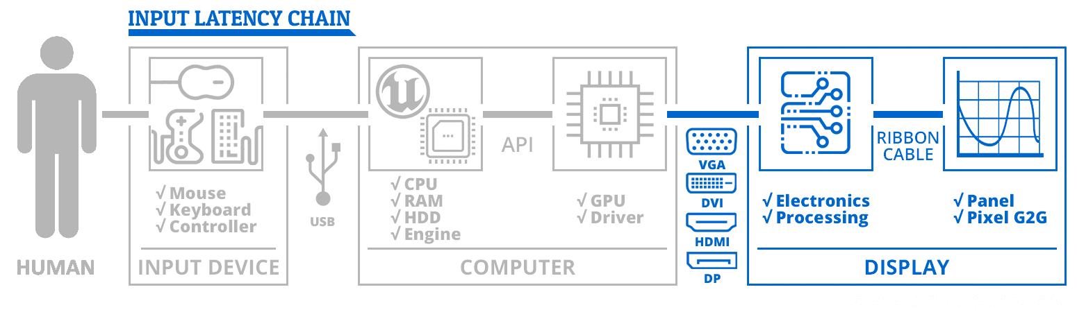

Monitor reviewers are attempting to isolate and measure display latency only:
RTINGS includes GtG transitions (aka pixel response times) in their total measurements, whereas TFTCentral separates the GtG from the actual processing latency, the latter of which is usually much lower (0.6ms at max refresh rate for the AQN in this case).
As for testing yourself, any easily accessible/affordable measurement tool you could get would require 1) training yourself to understand what you're looking for and how to interpret the results (you'd be surprised how relative and subjective latency testing can end up being depending on how you go about it), and 2) said tool would probably only be capable of recording the whole button-to-pixel latency, and not just the display latency itself, which will always give you a higher number.
For instance, I have an LDAT from Nvidia (photodiode with a built-in simulated mouse click), and I get as high as 25ms latency results on my AQN in certain scenarios because it's counting more than display latency in its readings.
The important thing to understand when testing general latency with photodiodes or high speed cameras is that how high the total latency number is, is less important than the difference between scenarios and that baseline, the baseline of which is going to be different for virtually every test configuration (given test device/peripheral + monitor + system + game combo, etc).
Measuring a near-instantaneous white flashing test square transition at the top left of the screen is going to have much lower latency than measuring a swinging hammer animation in the middle of the screen in Overwatch, and so forth.
What's important with display latency/processing is how quickly said display allows the latest pixel information in the very top left of the screen to start scan-in after it's been sent by the GPU.
The reviews? Honestly, many of the higher-end VRR-capable gaming monitors over the past few years have already been closer to CRT display latency/processing levels (at their max refresh rates) than not. The AQN is simply one of them.
