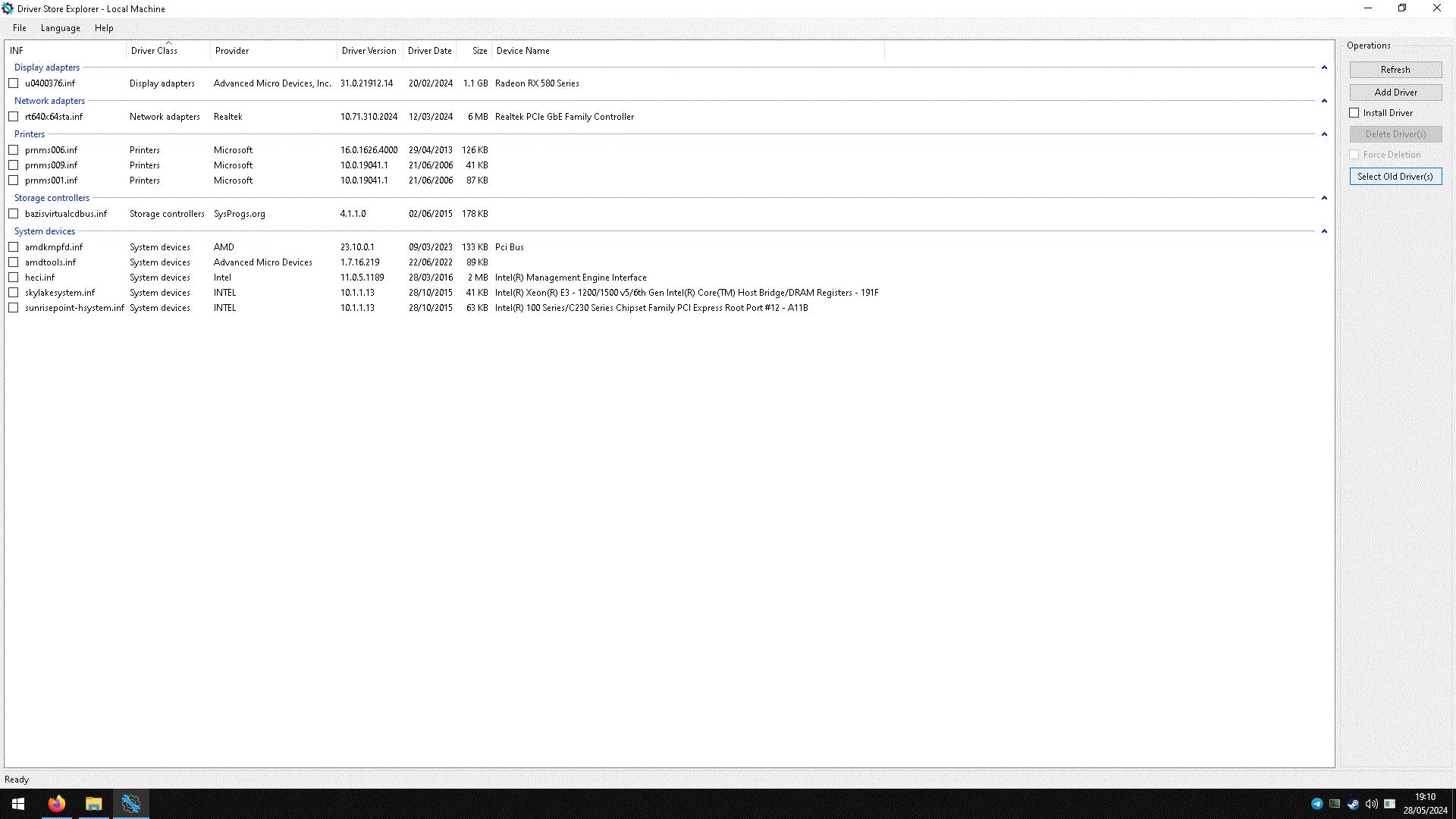

driverstoreexplorer to check for old drivers - can be a big difference if old driver is conflicting, seen a lot about this

Can you tell us what exactly you do with DriverStoreExplorer? I've never seen that mentioned before, thank you.
Re: Input / Fps lag / polling issue / latency fix vault (valorant based)
Basically same with DeviceCleanup, both can clean up unused drivers.rekaa02511 wrote: ↑20 Dec 2023, 10:08Can you tell us what exactly you do with DriverStoreExplorer? I've never seen that mentioned before, thank you.
rekaa02511
- Posts: 24
- Joined: 25 Sep 2023, 11:12
How do I know which ones are unsused?Kyouki wrote: ↑20 Dec 2023, 10:34Basically same with DeviceCleanup, both can clean up unused drivers.rekaa02511 wrote: ↑20 Dec 2023, 10:08Can you tell us what exactly you do with DriverStoreExplorer? I've never seen that mentioned before, thank you.
you have to tap "select old drivers" and if any drivers highlightened, these are old/unused, then tick "force deletion" and tap "delete drivers"rekaa02511 wrote: ↑20 Dec 2023, 11:05How do I know which ones are unsused?Kyouki wrote: ↑20 Dec 2023, 10:34Basically same with DeviceCleanup, both can clean up unused drivers.rekaa02511 wrote: ↑20 Dec 2023, 10:08Can you tell us what exactly you do with DriverStoreExplorer? I've never seen that mentioned before, thank you.
