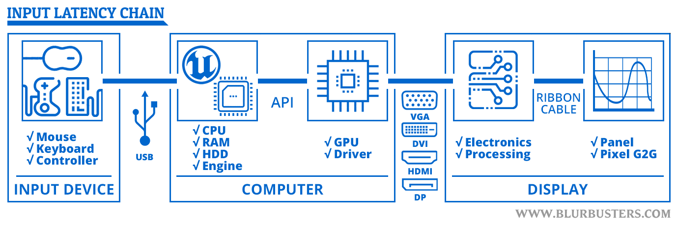

It's good to isolate stages of lag testing -- e.g. display, or the cable, or game engine only -- but for a complete human button-to-pixels chain -- it is extremely difficult to automate lag testing of the actual lag of a real complete, true, bona-fide "mouse+USB+game engine/OS+GPU/drivers+cable transmission+display processing+panel" chain.
Executing actual hardware and actual games through the complete chain is extremely hard to automate, which is why we are VERY interested in finding ways to automate high speed video lag testing of actual games better -- including writing software to automate processing of analyzing high speed videos of gameplay videos.
SMTT tests can isolate display differentials, photodiode tests can automate quite a lot of things, Leo Bodnar can test absolute display lag
(Leo Bodnar -- top edge is roughly akin to SMTT differential relative to CRT. However, DisplayLag uses center rather than top -- which results in different Leo Bodnar measurements -- which makes it hard to directly compare DisplayLag.com to TFTCentral.co.uk). On the other hand, if your goal is the complete eSports button-to-pixels chain that includes *everything* that creates lag, we've found it is hard to beat good high speed camera tests (at this time).
The lag testing method depends on if you're trying to isolate certain parts of the input lag chain, or the whole chain all at once.
One of our diagrams (semi-simplified), which I'll reveal now;
That said, we definitely have more lag features and lag testing techniques (including photodiodes). We're reluctant to reveal too much yet, to spoil surprises, but "Keep tuned". :D
