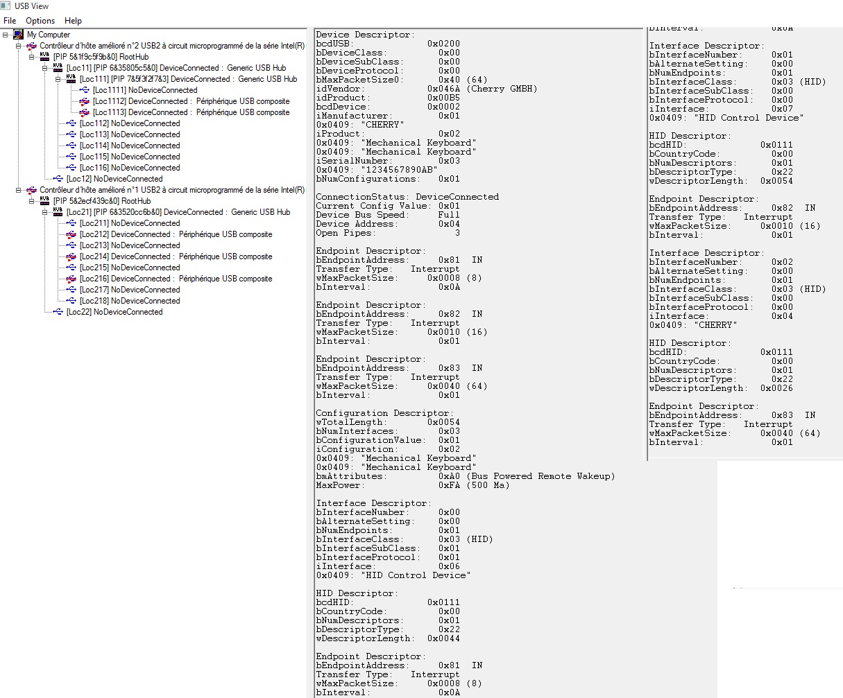

Can you check if the Cherry 6.0 is a low speed or full speed USB device? Windows doesn't follow USB spec on polling frequency for low speed devices.

how can I check that ?

USB Device Tree Viewer or USBView.

Device Bus Speed : 0x01 (Full-Speed)
for cherry mx6, bloody b640 and logitech g303 (all 3 at full speed)
keyboard and mouse is on same controller, i have another one but it's seems only for the front panel usb
is it true it's better to separate usb and mouse usb hub ?
is it true front panel hub is worse because it's mounted from an auxiliary panel ?

dhaine wrote:Device Bus Speed : 0x01 (Full-Speed)
Weird, what's the binterval field in the keyboard's interrupt endpoint descriptor?
I haven't been able to tell any difference, but you can't rule out some motherboard using a third party USB chipset with a poorly written driver, or some other confounding issue, like signal degradation or interference on a cheap cable. Best you can do is test whatever you have access to.

Post by Sparky » 16 Oct 2015, 19:29
So the keyboard has multiple endpoints, some are 0x01 (1ms) and some are 0x0A (10ms). It sounds like it's using the 10ms endpoint, which is also has a small packet size, so you might want to check if NKRO is working in that mode. (I'm guessing it just uses the third endpoint for NKRO, which might make windows think you're using two keyboards simultaneously).
Just looked at the manual, it sounds to me like they couldn't get the keyboard working acceptably with the fast response time, so they hid it behind a "performance" mode. Press the cherry key so the windows key turns red, then try testing latency again. http://www.cherry.de/files/manual/64406 ... ard6-0.pdf
It's also a bit concerning that it's possible to update firmware on the board, as that's a potential security vulnerability (difficult attack to pull off, but it lets malware reinstall it's self after a complete format and reinstall).

you are right having the cherry set to red lower input lag, bringing it very close to the g910, I still think the g910 is faster by a very few ms but it can be just a feeling and human error
they are both great keyboards (too bad the g910 can't have its palm removed...)

dhaine wrote:you are right having the cherry set to red lower input lag, bringing it very close to the g910, I still think the g910 is faster by a very few ms but it can be just a feeling and human error
Could you do some flick tests to see if debouncing is still acceptable in the performance mode?
