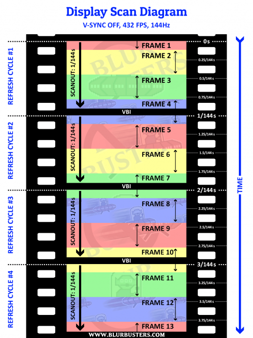

To understand how lag of frameslices work, see these diagrams.
Mind you, these diagrams are not perfect. It's extremely hard to explain lag mechanics of VSYNC ON versus VSYNC OFF, especially concurrently with modified gradient effects from asymmetries between cable scanout and panel/visual scanout.
