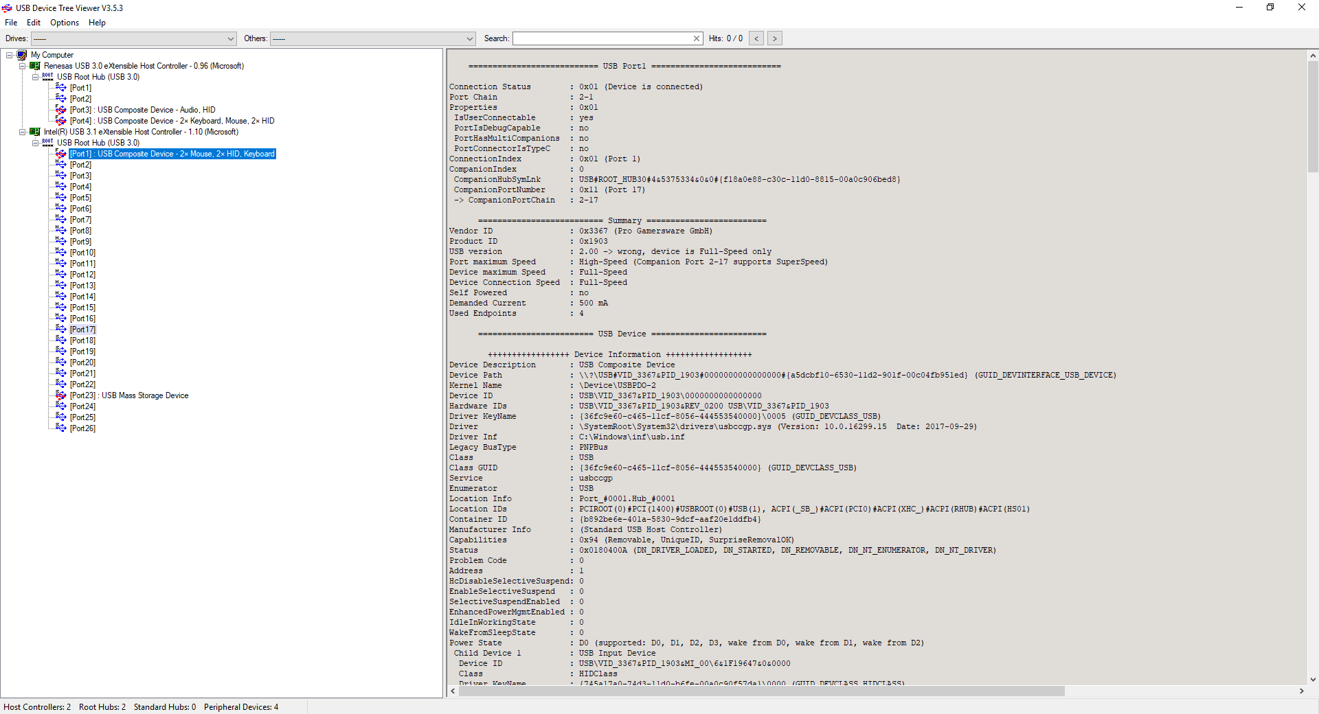

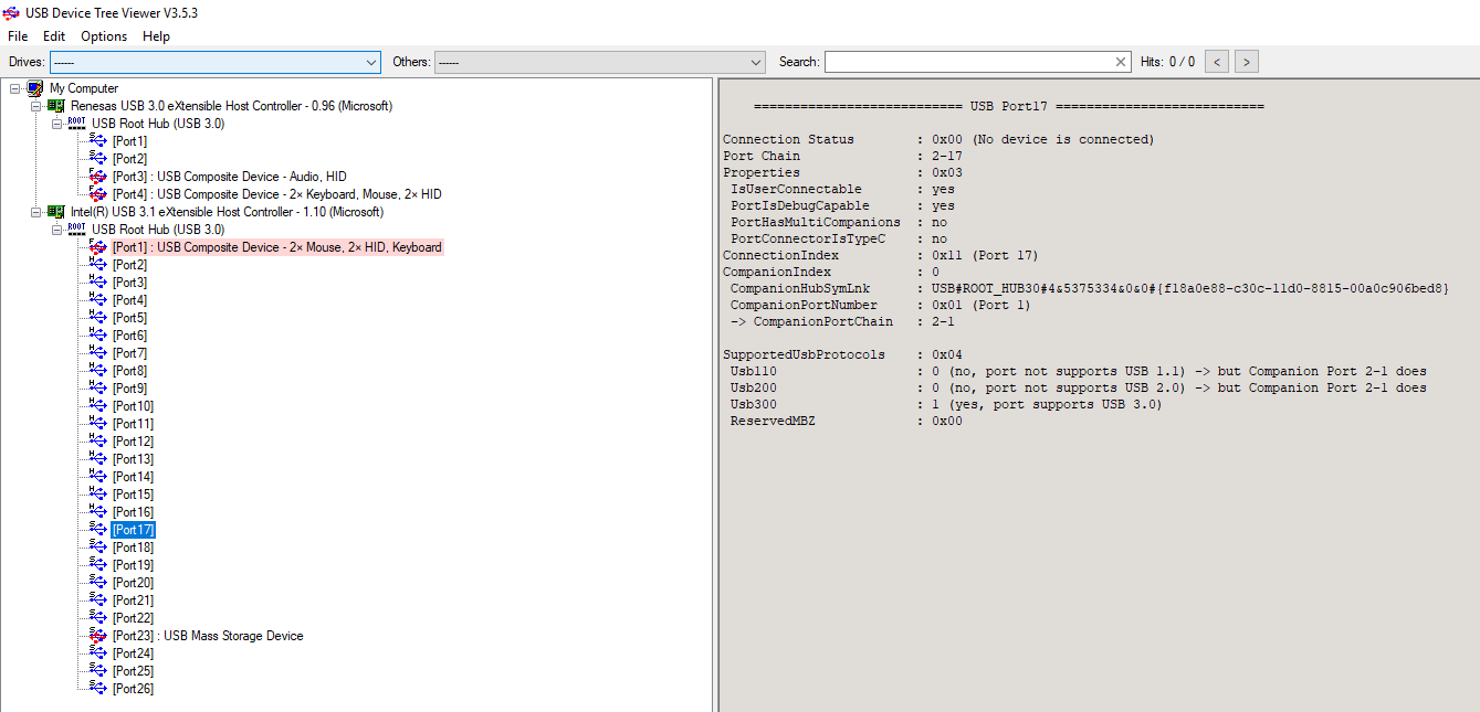

In the picture I showed how my usb tree looks now. I have a mouse connected to port 1 which shows port 17 as "companion?" I have a separate usb 3.0 controller for my keyboard and dac, which for some reason shows 4 usb, although physically it has only 2. So it is with the motherboard controller, why are there so many of them?
Mouse is registered as 2 keyboards for macro buttons also and keyboard also 2 times for key-n-rollover!
