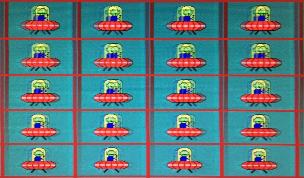

Here's an example of strobe crosstalk (Double image effect):
That's the typical before/after scenario when using a lower refresh rate + adjustments + large vertical totals.
