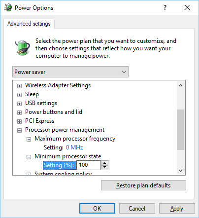

Fixing FireFox Stutters
Occasionally, there are situations where a specific computers only runs 60Hz Chrome but has correct Hz in FireFox. However, FireFox often stutters quite a lot at high refresh rates until you temporarily set minimum CPU to 100%. When adjusted this way, it successfully runs at all current refresh rates.

Test Balanced Mode or Performance Mode
Power-saving mode may force a browser into a 60Hz mode even with laptops connected to an external display.
