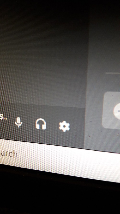

Another thing I want to touch on was that whenever I use a high refresh rate like 120hz I see these static horizontal scanlines (aside from the moving ones) visible on some backgrounds toward the left side of my screen more noticeably at the bottom, and when I increase it to 144hz the lines become more apparent and in the middle-left of the screen. The pixels basically start to look more like a grid.

Somebody else was having the exact same issue as I mentioned in my last post with the picture, except this is a post from last year with a different monitor: https://rog.asus.com/forum/showthread.php?91682. So yeah, looks like it's an issue with potentially all monitors with the same M240HW01 V8 as mentioned above, besides the moving (ground loop effect) scanlines issue.
