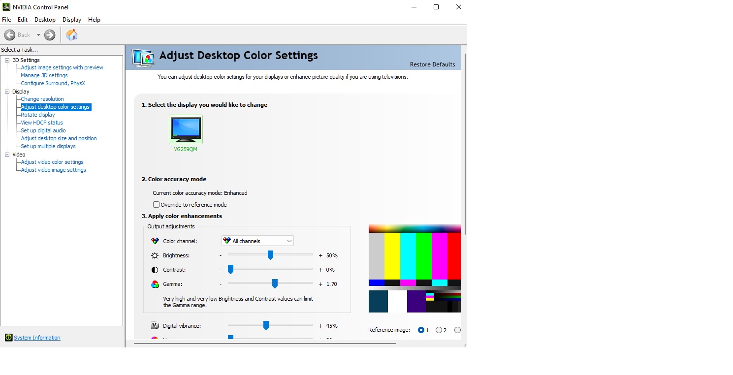

Bewst Settings to minimize the effect of crosstalk on BFI @1440p horizontal speed on UFO test:
280Hz ELMB on AS off racing mode brightness 10 contrast 70 to 80 Vivid pixel 50 to 75 Blue filter lvl 3 + high gamma low contrast Nvidia color tweak the nvidia color settings work best on FPS mode > RTS/RPG mode > sRGB, racing, Scenery mode. I don't really see the point of the MOBA mode? It only shows red. And Cinema mode, well...
Those settings minimize the effect of the overly strong overdrive on the crosstalk and optimize the details around the target to track at any speed between 960p to 1920p horizontal on the UFO test.
But... the low saturation is intended to mitigate the color clipping introduced by high gamma, but failing at meeting something even close to bareable when it comes to content consumption. After many trials with this monitor for the past 2 years, this is the best competitive settings I found, but terrible if you watch youtube videos, films, or any type of content.
I would like to ask if someone could try those settings and post pictures of default BFI settings and these BFI settings to compare because I didn't understand how to make them for best results (very sorry).
Second. I dunno if it's intended but I've found through reading many reviews on monitors with BFI that contrast has an effect on the quality of BFI. Is it on purpose that the best monitors for BFI show lower contrast results than others? Of course TN have to have it. But what about the XG2431 and it's <1000:1 contrast ratio as an IPS? is it done on purpose?

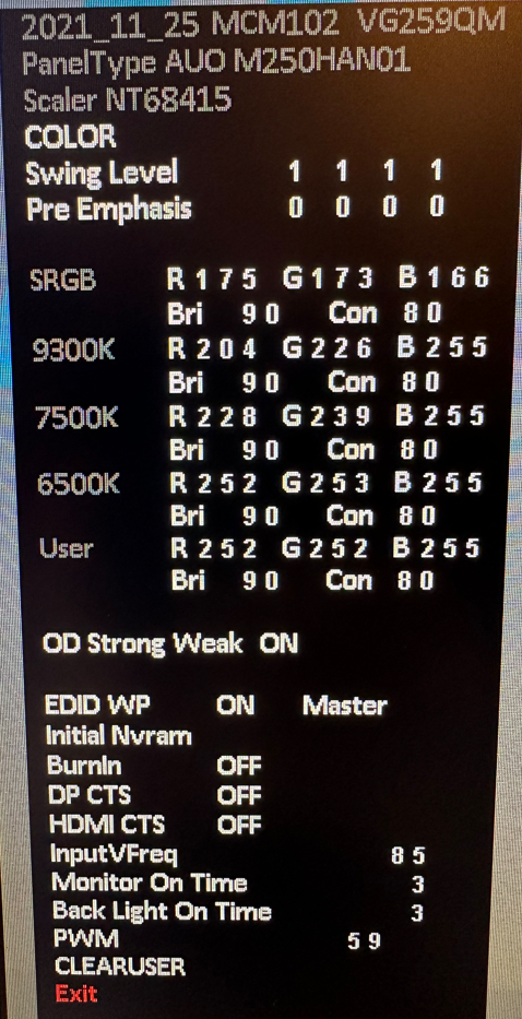

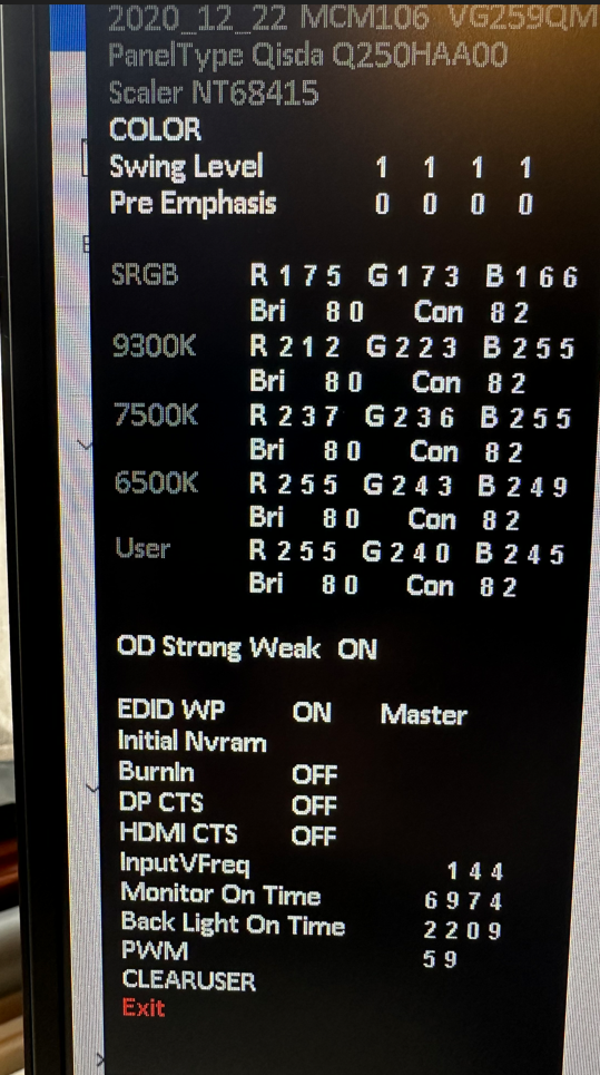

DO NOT BUY ANYMORE ! Asus is using lower quality display panels in more recently produced units while still using the exact same model name. In my opinion this is customer deception by ASUS.
I contacted Asus customer support, they said this is "normal" and if I'm not happy with the panel, I just have to return it to the reseller.
Poor resellers just selling the units Asus delivered them ... how rude from Asus !
When I insisted at Asus customer support, they said it is due to the chip shortage. What, well Asus, just don't sell the panel anymore! Or use another model number or revision number or whatever.
When I insisted again at Asus customer support, they said my first panel came from the NL while the second came apparently from CZ ... how can that be a differentiator ???
My first panel VG259QM was bought from a NL reseller.
I bought my second panel of the Asus VG259QM two weeks ago on amazon.de.
Very disappointed, the quality of the display panel is much lower then the one I purchased about 1 year earlier.
There is ghosting and tearing on the same settings.
The colors are inaccurate way off, after hours of testing, there is no possible setting to match the same color and brightness as the first screen.
The most annoying for daily use is the yellow in the panel which is overdominating.
There are still plenty of good reviews for the VG259QM on the internet.
I guess Asus just keeps using the same model name and number just to keep selling this for max profit.
Again, in my opinion this is customer deception by ASUS.
Panel references :
2020_12_22 MCM106 VG259QM PanelType Qisda Q250HAA00
2021_11_25 MCM102 VG259QM PanelType AUO M250HAN01

Could you please post some images to compare the new and old panel revisions?
My bad English :0
Yes.
Panel references and pics :

Yeah this is not cool from Asus.
There are identically specd VG259QMY and VG279QMY that came out much later. That could be it. But I'm just guessing. Can you check?
