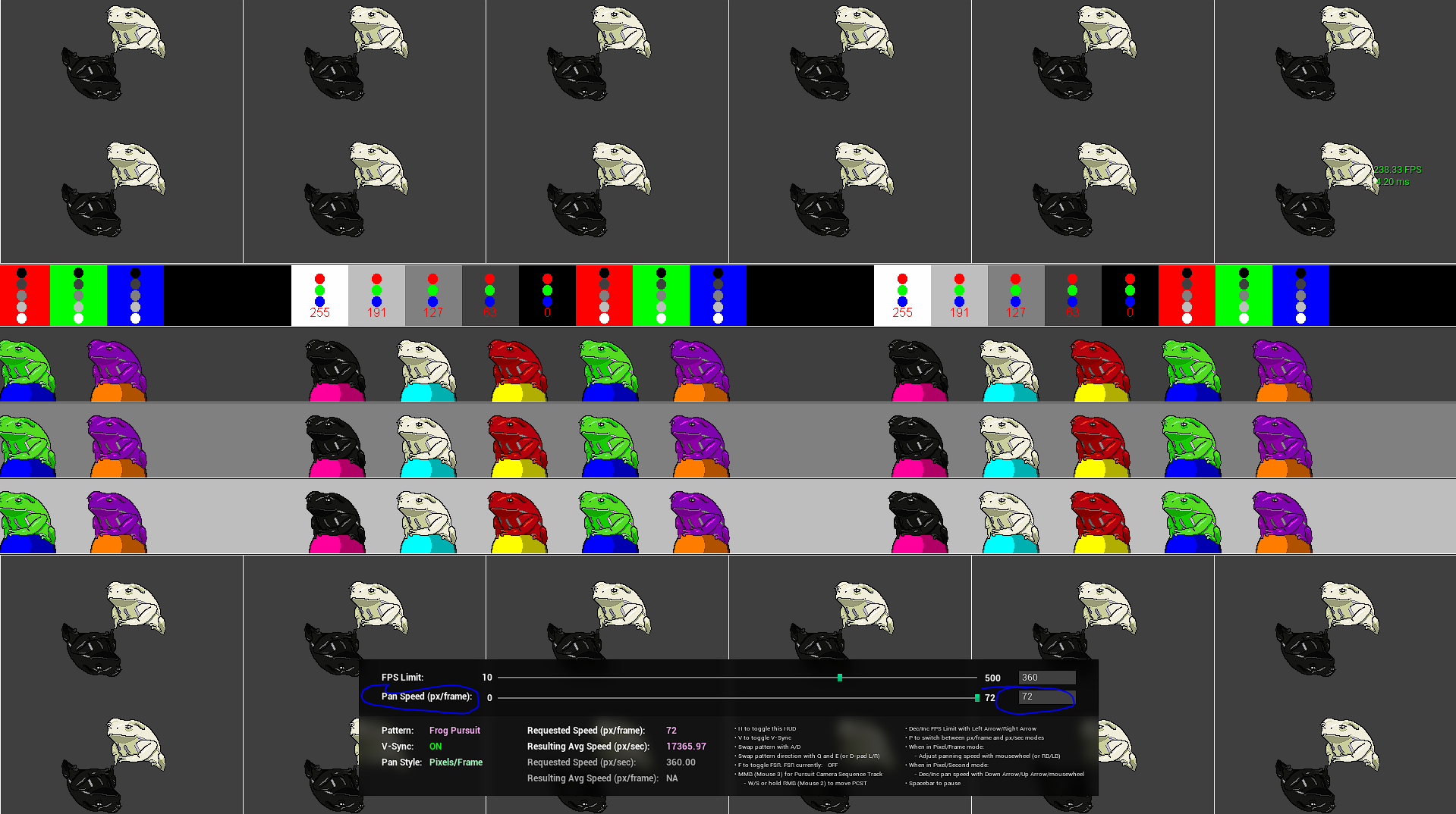

Good afternoon! Thank you for this information, it was very interesting to read it. But there is a question, above you write about the setting "use pixels/frame mode with ∼2000 moving speed" - I could not find such an option if you select mode pixels/frame there is a limitation of 72. Please explain
that moment.
- 1.PNG (231.92 KiB) Viewed 1598 times
Re: Forgive help in choosing a monitor 27'(for competitive games)
Sry, use any px/frame to achieve approx. 2000 px/second. Formula is X FPS * X px/frame = X px/sec.
You can use any speed u want actually, any thats comproftable to eye track. TestUFO's default speed is 960.
