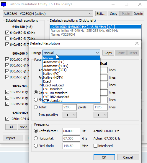

Please I need the expertise of some experienced people here on how to solve this problem because I just saw the tricks of this guy of how to set up overdrive to 120 which I successfully did. But what I did not was set up a 10 bit color in my nvidia panel which requires me to open CRU and set up a LCD reduced timing to a new detailed resolution and I can't.

Post by RealNC » 16 Jul 2022, 08:42
Read the version changelog here:
https://www.monitortests.com/forum/Thre ... tility-CRU
Changes in 1.5:
"LCD reduced" has been eliminated because it was too arbitrary and only worked for certain resolutions. Try "Exact reduced" for an alternative.

Post by vg259qm owner » 16 Jul 2022, 08:59
RealNC wrote: ↑
16 Jul 2022, 08:42
Changes in 1.5:
Thank you I didn't know that the previous version changed so much. Should I download the previous version like this guy have https://www.youtube.com/watch?v=kl-Ata9ql2A or it's the same to try the "Exact Reduced"?
vg259qm owner
Posts: 5
Joined: 15 Jul 2022, 23:00
Post by vg259qm owner » 16 Jul 2022, 11:09
I now have 10 bits on two different resolutions only possible with the creation of two detailed resolution (I did with the previous version). Does it have any downsides by using the previous version? And does 10 bit cause input lag? Thank you bro.
