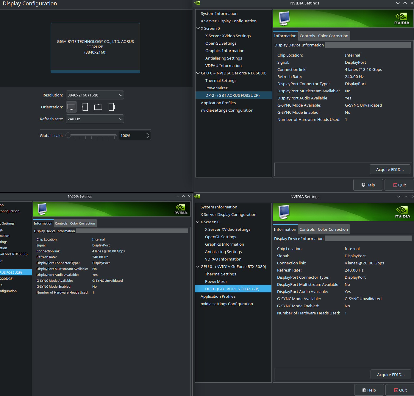

I just got this monitor and I have a 5080. I think it is a big deal that we can't disable DSC on the monitor because I have no idea if it is on or not. I want to test cables and see if it's worth using a Vesa DP80 certified cable, and I don't know because DP 1.4 cables seem to work fine but that's probably because it is enabling DSC with them.
I won't even know if DSC is still enabled when using a certified cable because there seems to be no way to see in windows or on the monitor. I don't know what the default Nvidia behaviour is either. Nvidia could be auto enabling DSC for all supported displays, and we just wouldn't know. This means I could just be wasting money getting the U2P instead of the much cheaper U2 and also wasting money on a cable that isn't needed.

Yes I think so. I read that it might not be possible to disable DSC except for in monitor firmware so it seems it is the Monitors responsibility and not something that AMD or NVidia can do even if they wanted to. Perhaps the monitor firmware does check if the link speed is sufficient and does disable DSC but without an identifier or toggle on the monitor it is not possible to know.
The monitor advertises "4K at 240Hz and 8K at 60Hz uncompressed images" so I have asked for confirmation from Gigabyte about this because otherwise it is false advertising.
A big issue is that there are cables for sale and the user can't determine if they are running with or without DSC so this allows unscrupulous sellers to falsely advertise cables as 80 Gbps, and most customers would never know.
I haven't found a way to see the link speed on a Nvidia GPU in any software on Windows but I was able to see the link speed of my cables in Linux. I can see that my new VESA Certified DP80 Cable is indeed running at the correct speed, but I don't know if the monitor is disabling DSC.
Top right = DP 1.4 cable 3m (4x8.1Gbps)
Bottom Left = DB 1.4 cable 2m (4x10Gbps)
Bottom right = Silkland 2M Display Port 2.1 VESA Certified DP80 Cable(4x20Gbps)

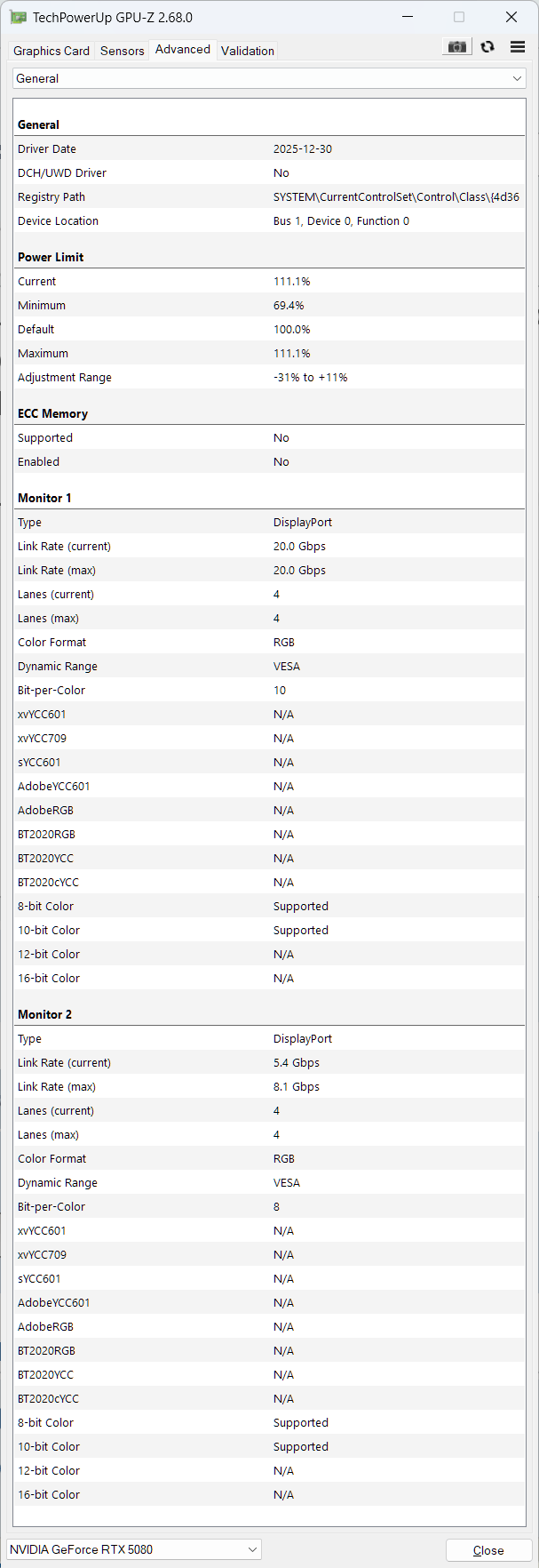

I am able to see this in GPU-Z in windows, however I am still not sure if DSC is enabled or disabled. I am running on the latest F06 Firmware and it doesn't have any toggle as such. There was a post on reddit which said the non-P version of this monitor got the F07 firmware which added the DSC toggle but I cant confirm.
The GPU-Z Screenshots say its 20GBpsX4 compared to my old LG 1440p144Hz IPS
GPU-Z 5080 Screenshot
If the link speed is correct, then I'd say DSC isn't active, otherwise the link speed would have been reduced.
