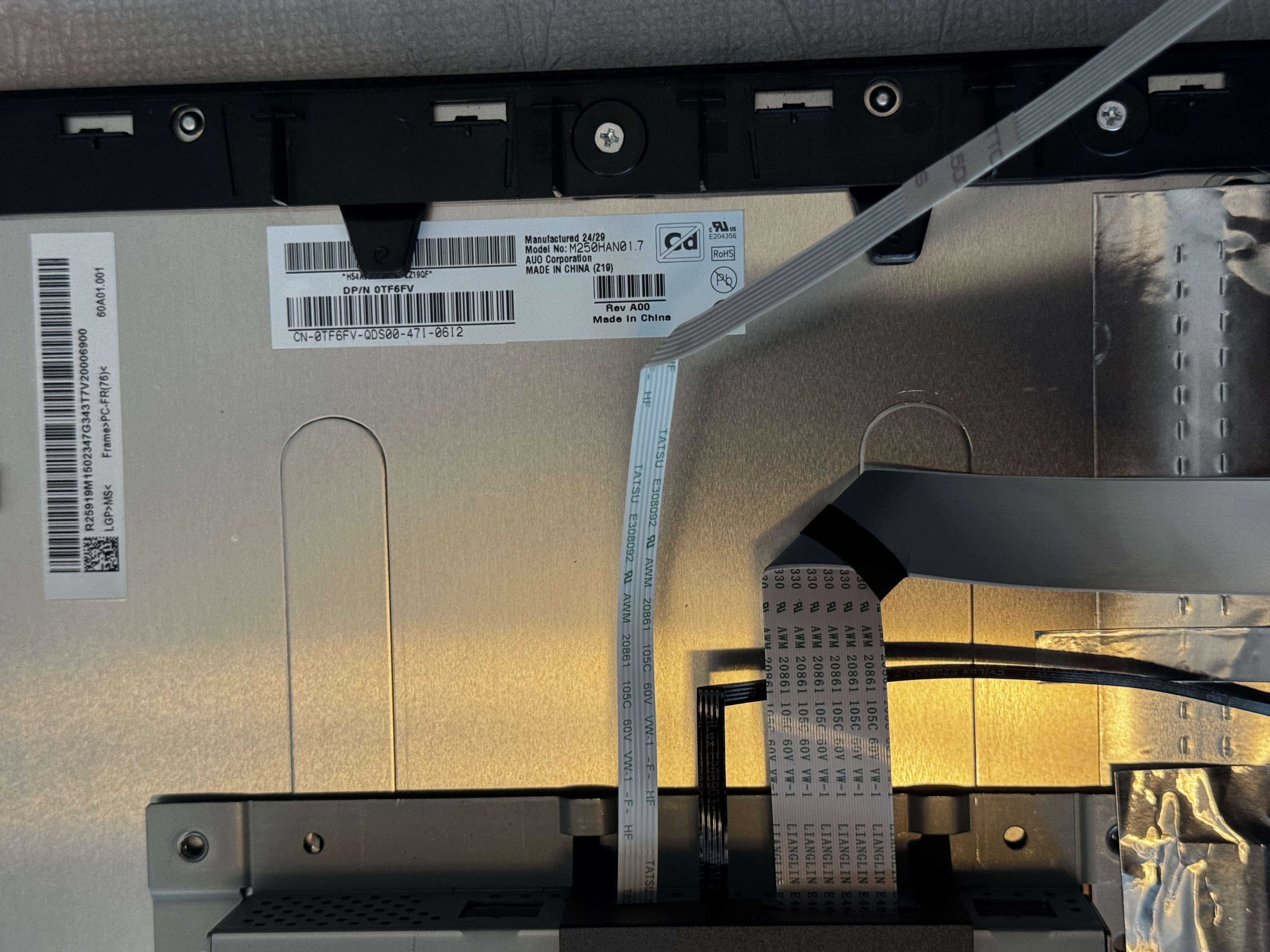

Currently, I'm using the Dell G2524H and I have had it since February. So far, I've had an okay experience with using it for a few months now, but to be honest, this monitor feels super basic. I really wish this monitor had at least backlight strobing. In my opinion, the panel feels kind of slow. It has an AUO panel inside (M250HAN01.7), which I can confirm because I took apart my monitor. I don't think there was a way to even access the service menu on this monitor. Sadly, I broke the back of my monitor when dissembling it :cry: .
Have you taken any photographs of the disassembly process and/or internals of the display? It would be valuable information.
What's interesting to me is that you mention that your unit came with the M250HAN01.7, which should be much faster than what this review claims

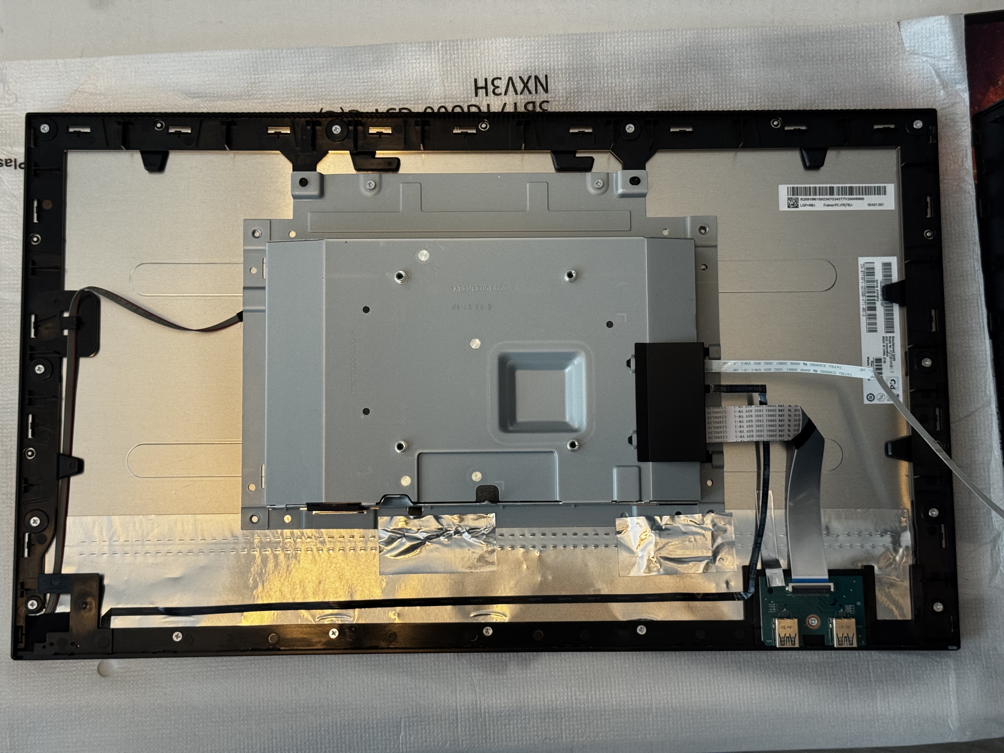

So far this is what I have taken. I got more pictures if you wanna see more of them.

thecelicalover wrote: ↑
07 May 2025, 15:28
These photographs of the dissasembly was done with scrupulous attention to detail, thank you.
It's always interesting to see the internals of different display models.
This LCD display seems to lack shielding of the TCON & scaler units, as it seems to employs plastic instead of aluminium or a stainless steel housing.
Have you taken apart the plastic housing & inspected the TCON, scaler & internal power supply? Curious who manifactures them & what capacitors were used inside.

thecelicalover
Joined: 25 Apr 2025, 09:24
Re: Recommendations for Good 1080/1440p 240Hz Monitors (2025)
Post by thecelicalover » 15 May 2025, 14:35
kyube wrote: ↑
09 May 2025, 08:17
Sadly, I didn't want to take apart the rest of the other components. I'm not much confident when it comes to handling those kind of things. I don't want to take risk of damaging anything of course.

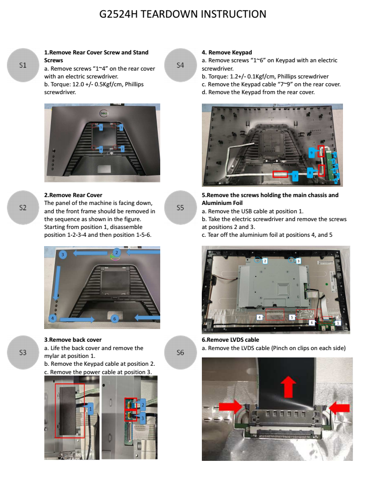

Also if you want to know where I got the source for the teardown and instructions, I got it from Dell main website.
The manual is pretty sparse when it comes to disassembling anyways. I had some trouble trying to pry the back cover out to look at the inside of the monitor. I thought I broke it at first :D .
kyube
Understandable. Regardless, thank you for providing photographs!
Great find! I was also on a journey on researching into internals of displays recently & noticed that Dell seems to provide diassembly guides on their website. A noble feat, in the age where disposable electronics & planned obsolescence are prevalent.
Just as a confirmation, is the middle section (shielding) made out of plastic or metal? I'm somewhat leaning onto the idea that it's plastic, but I cannot say for certain..
thecelicalover
Post by thecelicalover » 26 May 2025, 20:30
kyube wrote: ↑
16 May 2025, 12:01
As far as I know, I believe the TCON shield is made out of metal. I was touching the surface of the shielding, so I didn't believe it would be plastic. And close inspection of it appears to be metal.
