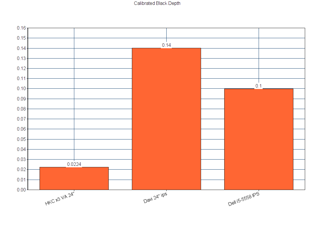

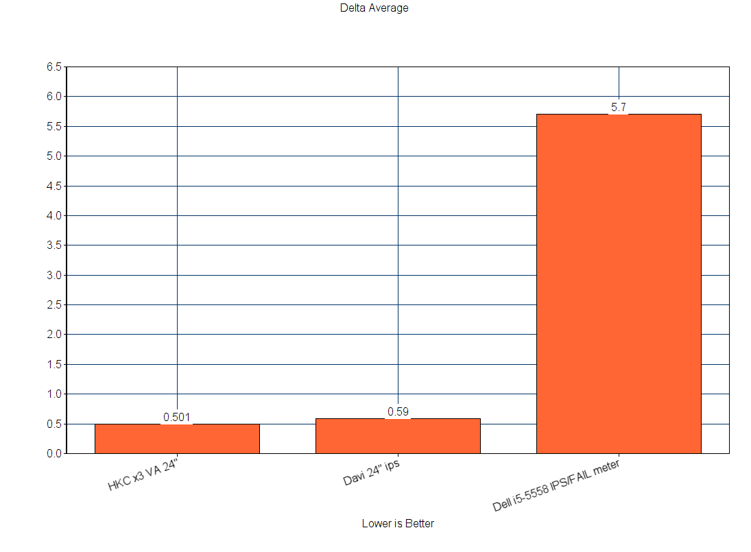

Fortunately, calibrating this screen twice brought this beast down to 0.42 deltaE!
While none of the calibrations from DisplayCal were bad,
SRGB mode came out least favorable, with BT 1886 as central and GAMMA 2.2 the best. Here I got the highest color accuracy and
contrast. The other two sacrificed a few % to either contrast darkness or color accuracy. I highly recommend using Gamma 2.2 in
Displaycal for i1 Dispaly Pro.

2016-06-12 22.59.43. 2016-06-12 23.00.16.
For Photography, its recommended to get a 27-30" Screen, or even bigger with a high PPI and a
glossy coating. BUT the color accuracy and contrast helps greatly to offset these limitations.
With DeltaE 0.42E (recalibrated 6/11/16).
This brings this screen down slightly more accurate than my Davi 24" IPS which uses the same
panel as the apple cinema circa 2010.
The contrast really does this screen a giant favor. Photos viewed are very rich with depth

+Highest contrast ratio ever tested (and I had the honor lol). 5312:1
+Very high color accuracy, IPS killer <0.42 DeltaE

-Poor factory calibration, just awful and almost resold it!
-Poor OSD functions: If using a Factory preset, it is defaulted to the first each time monitor sleeps/off
-144hz OD on my panel caused ufo test to vibrate/judder vertically, set to 120hz fixed this.
-No Gsync/Freesync/ULMB or 240hz black frame strobing from Eizo. But do you need it? I haven't
seen tearing once.
-A bit more narrow viewing angles than IPS and narrower than the best VA panels but its not bad.
Still better than any TN, just not as good as IPS.
-Probably no warranty overseas
Thoughts..
You can't have everything. If you were to raise the scores of movies and photos,
that would require
4k+ HIGH PPI and HDR. But there is no monitor out there in LCD Land that will also give you
high refresh rate/low lag AND very high contrast levels AND high color accuracy. The 4k monitors
out there only do about 800:1 contrast ratio. Then there's the plethora of 2560x1440 27" monitors
that are everywhere, but they do not scale well at 1080p material and aren't resolved enough for 4k
and do not exhibit the high contrast ratio.
4k is the new standard that won't go
away for Hollywood, so it's really a moot in between step. So a 27" 1440p scren wouldn't be "Better"
But simply a sidestep.
For 1080p LCDs, I also looked at the Dell U2417HJ, which has superior low inpug lag at <5ms smmt fast
pixel response, but also the best tested IPS for contrast ratio at 1228:1. However, you do not get
high PPI or glossy screen for photos here either, and the HKC and Eizo still shrug at that contrast ratio. I almost
bought that screen, but the HKC was already in progress so i just went ahead with it.
It also is just a 60hz monitor. The HKC seems like it has beaten Eizo in battle here, and is less
than half the cost so now that is no longer the best option.
This seemed like the best alternatives are few, mainly being sidegrades.
You will sacrfice
something, unless you wish to pay an arm and a leg
for the upcoming God of all monitors, the DELL 4k 120hz 0.1ms 30" OLED.
This indeed will make no compromise.
What changes I'd like to see on revisions:
-FIX the OSD! Really, this is what makes you look like an ordinary, sweat shop Chinese company.
The settings don't stick once the monitor powers off on standby. Thank God for calibrations
that do stick!
-Try to make at least "useable" pre set calibrations for people who aren't gonna buy a calibrator ever.
-Fix your manual and print it out in different languages.
-Slim down the bezel and use a nicer osd control pod like Dell.
-Consider using low reflective 3H glass similar to Plasmas.
REALLY consider exporting after the fixes are in place. Gamers are dying for a monitor this nice
I don't think t hese revisions will cost a great deal of money, you still gotta pay people's salaries. But no
excuse for basic quality!
I went well above and beyond what a normal person would do when buying a monitor. I bought an entirely
unknown brand in the US, went through the hassle of navigating and registering on a complicated Chinese website
and communicating with agents of broken English and more google translate. I then had it shipped for nearly the cost
of the monitor. BUT you know, shipping and export fees are added to monitors in the US anyways as hidden charges?
For example I paid $277 total for this monitor, a TN panel would cost around $300 after taxes but the Eizo FG2421, which is inferior
would cost you $610 after taxes. I then went through the trouble of buying a calibrator and learning how to calibrate my screen.
This is something else that 99% of monitor and TV owners will never do. The Chinese pay only a small fraction for monitors over there!
You pay for advertising and marketing as well here.
So I would be really surprised if one of you guys who aren't living in China decide to buy one! Post your thoughts if you do!
GAMING: 4.5
MOVIES: 4.2
Office work/typical usage: 4
Photography usage: 4.2
Build Quality: 4/5
RECOMMENDED: 4.4/5
Price at time of review: $133usd, +$142 to ship to USA. Got discount and paid 0% fees/taobao agent
