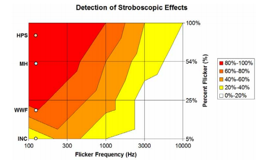

That said, the Nature "possible to perceive up to 500Hz" is quite correct.
And it is possible to perceive up to 10,000Hz indirectly via phantom array effects.
(From lighting industry research but also applicable to display PWM-dimming too)
