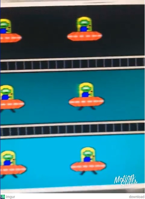

Postby taisel » 07 Mar 2018, 15:20
I'll add more videos or stills as time goes on, the more the merrier with inferring true display capabilities.
Camera is the back camera of an iphone SE, no fancy slide rails.
https://imgur.com/a/odrD3 240hz w/ "fastest" overdrive setting.

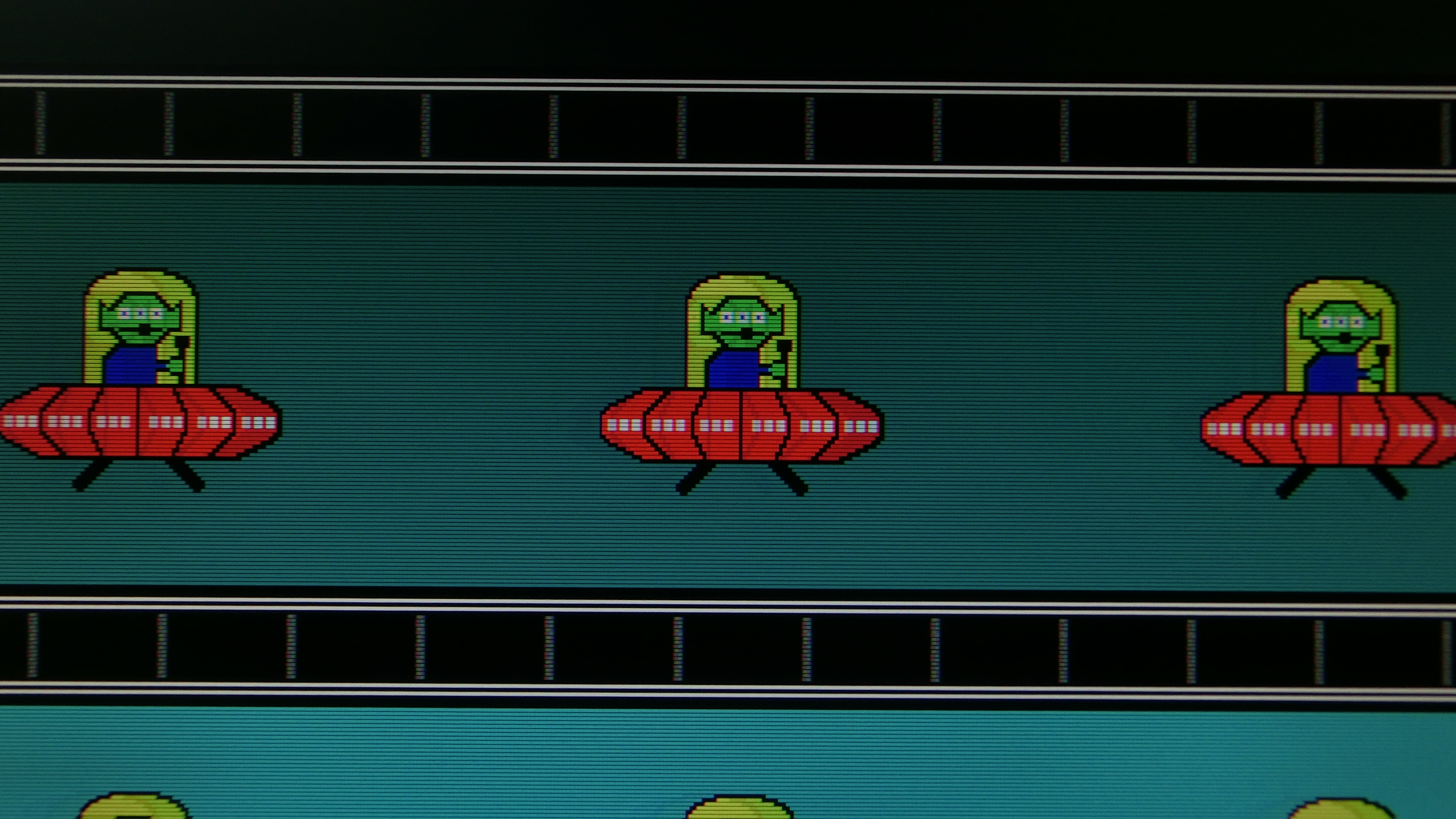

P.S. Tips for hobbyist smartphone pursuit cameras (using your iPhone or Android):
Video pursuits can also be done with http://www.testufo.com/ghosting and attempting to make the ladder-track look good too. That said, that pattern doesn't have the stars texture of this one. (Perhaps I should also add a stars texture mode to Ghosting, too!) Freezeframes of video pursuits on that test (with fully intact Sync Track ladder) becomes the WYSIWYG display motion blur reference.
Example1: Sync Track get 'broken ladder' artifact
This is what happens when you pan your camera imperfectly at http://www.testufo.com/ghosting
(LightBoost strobed mode, VG278H)
Example2: Sync Track looks correct
This is what happens when you pan your camera at the correct speed at http://www.testufo.com/ghosting (darn near exactly matching screen motion):
An intact ladder being photographed (Sync Track) confirms you tracked your camera at (darn near) the exact speed of the moving UFO, and confirms that the amount of motion blur is exactly WYSIWYG.
When doing video pursuits of the Sync Track, the ladder will tilt/skew/break, but a few freezeframes will often essentially look perfect or nearly perfect. Meaning video makes easier pursuit camera photography (no sliding rail needed).
For everyday users, simple video pursuits are easy, and can capture a reasonable captured approximation of human-perceived display motion blur.
Display review websites, bloggers & more advanced users will probably want to study Pursuit Camera Instructions.
However, end users can just wave a smartphone camera just like what the original poster did above! Just simply videoing TestUFO motion via hand-waving a smartphone video recording along the motion of TestUFO -- can produce usefully shareable motion-blur results.

Postby taisel » 07 Mar 2018, 21:06
More gifs:
https://imgur.com/a/jjHR8
https://imgur.com/a/vZeWV
https://imgur.com/a/4TSUJ
Still using the shaky iphone SE camera. Trying to do better. The phone is definitely adding blur to this due to autofocus and slightly mismatched speeds.

Postby Chief Blur Buster » 07 Mar 2018, 21:11
From your video at https://imgur.com/a/jjHR8
Is a good freezeframe:
Nice intact ladder!
That said, camera focus and exposure is off (blurred, overexposed).
If you plan to do more, here's some tips for the future:
To solve focus/exposure problem, prefocus your camera (while holding iPhone still at a specific planned distance from monitor) via tap-and-hold. That way, focus stops hunting and quality is much better.
After that, then begin your video pursuits. You can even wave your camera multiple times before stopping the video, then trimming your video to your best hand-wave (or few).
While landscape pursuits are preferred, it's understandably easier to hold an iPhone in portrait mode. Single-stepping through the video and finding the clearest freezeframe (intact ladder, sharpest focus) is something that can be done as easy end-user pursuit camera photography-by-iPhone.
Usually, generally, original .mp4 files are preferred, followed by YouTube (since it's embeddable in posts via [video] tags), but imgur is fine for quick and dirty.
Readers, pursuit camera photography doesn't have to be complicated camera rails -- it can easily be a hand-waved iPhone.
