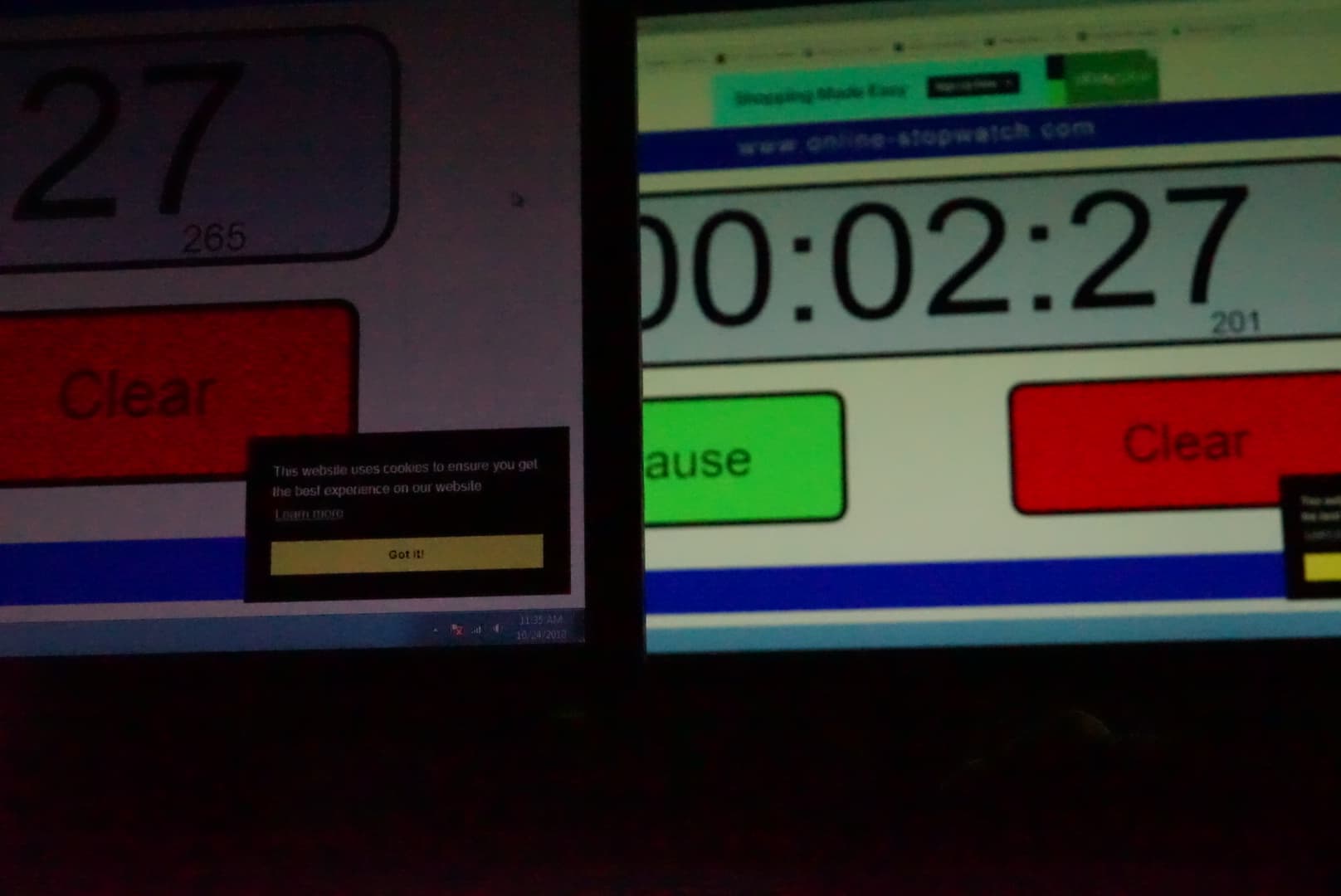

I had wanted a 240hz monitor to gain an advantage (reduced input lag) over others in fps games and I since I constantly read from online forums and heard from youtube videos that all 240hz and 144hz tn panels come from the same korean manufacturer, I figured they would all have the same quick input lag regardless of price and went ahead and purchased the cheapest 240hz I could find. The acer KG251Q is significantly cheaper at approximately $370 AUD versus your flagship benq xl2540. The colours are surprisingly better, and the clarity when in motion is a step up from my previous benq xl2411z 144hz monitor. But for some reason when playing counterstrike I noticed I would be killed before I had time to react, this did not happen when playing with the 144hz. Up until a few days ago I thought I was losing my mind until I did some comparison tests taking shots with a sony A7 camera at a shutter speed of 1/8000. I think my testing methodology is correct, all I did was clone the benq 144hz in nvidia control panel and then took photos of both monitors with a displayed stopwatch side by side. I also tested cloning the 240hz (idk if that matters). Benq 144hz on left, cheap acer 240hz on the right. I did not hand pick the images honestly chose 3 random ones sometimes it would have the exact same input lag as the benq but no lie majority of the time it would show these massive 50ms variances.
I have read some bad things about this monitor after I had already purchased it, so I just want to raise awareness and let people know to spend a bit more and not make the mistake like I did.
I also would like to know which 240hz monitor has the lowest input lag as I will be purchasing a new one and I want that leading edge. Please provide articles, thanks!
- 44782607_2247323035551204_5226902373766529024_n.jpg (77.55 KiB) Viewed 19409 times
- 44668886_719559911742199_1964358354306334720_n.jpg (75.97 KiB) Viewed 19409 times
- 44653851_319966328819413_6388194623604391936_n.jpg (70.12 KiB) Viewed 19409 times

Span your displays and find a stopwatch that you can split on both monitors simultaneously, it is more proper techinque to compare them side by side. At your pictures, right display is around 60ms behind the left one, but it doesnt neccessary means that input lag of the right display is 60ms worse then left.
Display cloning adds its own delay. Also, since you are measuring in windows browser, both displays are running with vsync on, also having different refresh rate, and vsync is definitely adds its delay to the whole chain.
That's why generally any browser-based timers are not ideal to measure and compare input lag. There is a tool SMTT 2.0 that can run in fullscreen exclusive mode with Vsync off.

Thanks for your input I'll redo the test sometime today and post here. I still think the 144hz will be at least slightly faster.k2viper wrote:Span your displays and find a stopwatch that you can split on both monitors simultaneously, it is more proper techinque to compare them side by side. At your pictures, right display is around 60ms behind the left one, but it doesnt neccessary means that input lag of the right display is 60ms worse then left.
