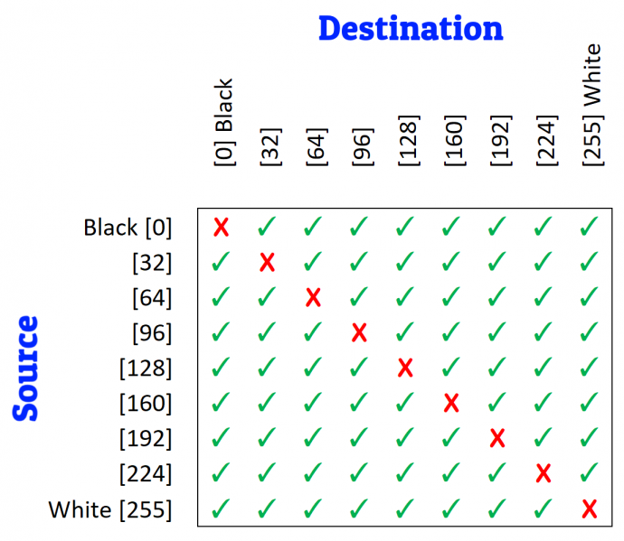

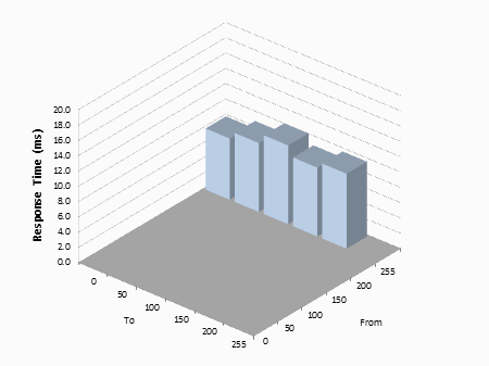

This is very true, see Pixel Response FAQ. You could choose the fastest GtG of the Grid.
Now, first, most manufacturer GtG is VESA standard from 10% to 90% point:
For an 8-bit panel, there are (65536 - 256) different pixel transition combinations, all of completely different speeds. You can shortcut this and simply use a 5x5 measurement grid or 9x9 measurment grid
And then you 3D graph it, like some websites do (TFT Central, etc)
A manufacturer could cherrypick the fastest one, or an average, or VESA standard colors. Beyond a certain point, the human eye cannot see the GtG (e.g. 99% -> 99.9%). And measuring equipment has noise margins, so often a standard of 10%->90% is measured, rather than GtG up to 10%, and the GtG after 90%. However, parts of the GtG can still be human visible before 10% and above 90% -- the cutoff points are arbitrary, however, they can still contribute to things like ghosting.
GtG is a complex topic... Read Pixel Response FAQ.
