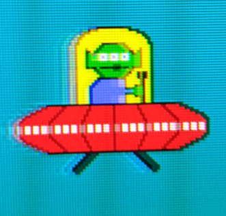

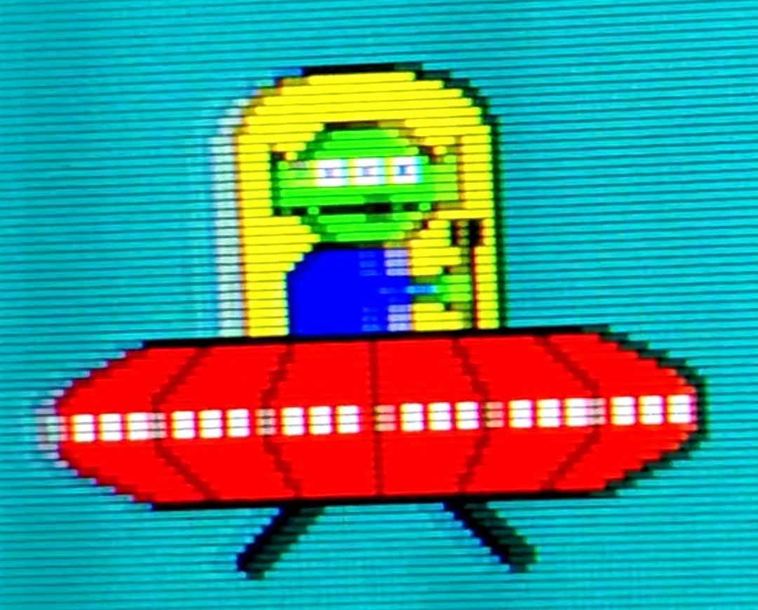

ELMB-Sync UFOTEST
VG259QM 280hz ELMB-Sync ON (Adaptive Sync OFF) - Reference Ufotests Results
Immagine 2022-01-13 122851.png (232.05 KiB) Viewed 242951 times
ELMB-Sync with Shadow Boost 3, slightly better results
