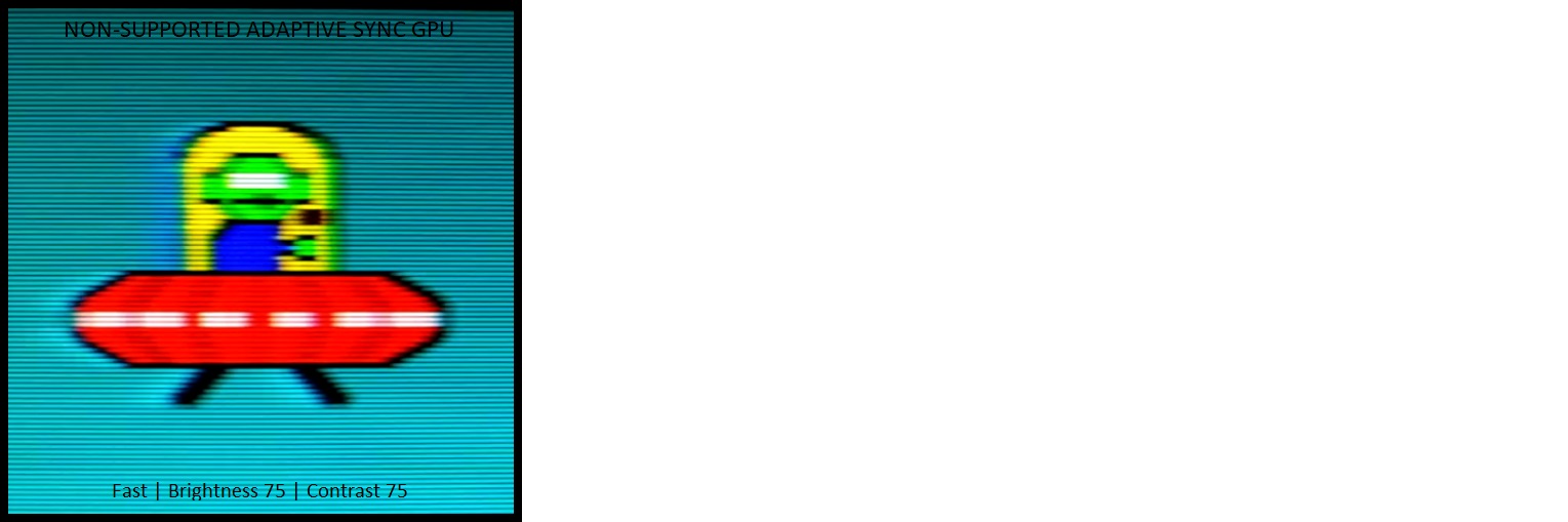

Images below compare how differently AW2518HF (freesync monitor)(and probably on some other monitors too) behaves on AMD vs NVIDIA GPUs.
Many people on Internet reported they have corona/white trail artifact with AW2518HF but my experience was very different and better. I figured researching this might be helpful for potential unsecure G-SYNC Compatible buyers. So I did it and this is how you can fix it by using settings from best result ufos:
AMD GPU: (tested myself with RX 580 and RX 460)
Over drive modes didn't do anything for me. "Normal", "Fast" and "Super fast" modes looked the same, no changes whatsoever, thats why only "Super fast" is included. But what did remove the ufo trailing dramaticaly is lower contrast. Reducing it removes trailing completely but the overall motion blur still felt the same with either improved or default osd settings.
The thing is, with this specific monitor contrast acts the same as brightness so you can change it as much as you want and you wouldn't be able to tell whether the brightness or contrast is changed.
NVIDIA GPU: (ufos from The Solid Lad, unknown nvidia 10se gpu)
Default OD mode for the AW2518HF is "normal" and it looks the same as improved contrast settings on amd gpu. When u change from "Normal" to "Fast" or "Super fast" it introduces corona/white trailing behind ufos. I don't know if reducing contrast fixes this artifact but I believe it does not.
NON-SUPPORTED ADAPTIVE SYNC GPU: (tested myself with R7 370)
The corona on "Normal" mode is slightly visible but noticeable. "Fast" is very present (same as nvidia gpu "Fast") and "Super Fast" is extremely distracting and unusable (worse than on nvidia gpu "Super fast"). But this time over drive modes felt slightly less blurry in games wich means response times are reduced unlike with rx 580 od modes. Reducing contrast also did not change the corona artifact.
I do not know how monitor behaves on non-supported AS nvidia gpus, probably the same.

Fascinating pursuit camera work -- I assume you did the pursuit camera -- very good job!
(Would it be possible to link to the originals? I love seeing the original sync track -- the "horizontal ladder" you see at www.testufo.com/ghosting -- because the photographed sync track (to me) is literally almost as golden as a cryptographic certificate of pursuit camera accuracy)
It's also a known strobe-crosstalk-reduction fix too on some models of gaming monitors -- the contrast-ratio reduction trick. Old LightBoost monitors did this partially to reduce 3D glasses crosstalk. This technique still works today when done manually via reducing contrast while simultaneously using slightly stronger overdrive (since the reduced contrast makes stronger overdrive work better and more cleanly).

Thanks. My test were only the top 3 and last one. Nvidia's ones I found on yt.
Here are the originals (22MB "png"):
https://mega.nz/file/o4RkyShB#8Bf5g_SUw ... 6Jtnu-OdQ8
I thought people should know this. They might see online that the monitor has this artifact and then avoid buying it. But in fact monitor is extremely good.
Another interesting thing about this monitor; Reducing the gain for green color (customizing colors in osd) from default 100 to 99 also removes the ghosting significantly. All other settings are default. Same thing with contrast even from default value of 75 to 74 does the trick. By going lower ghosting keeps improving.

Neat to cross-compare your pursuit camera test to a somebody elses' test results!
(In this case, A Solid Lad's YouTube freezeframes. That YouTuber is a forum member here, too)
Good image-colors equalization & alignment job for easier visual comparison of WYSIWYG ghosting artifacts.
So great job, I've seen worse error margins in same-reviewer two-display comparisions before...

Back on topic -- mind if I ask what camera you used, and did you use photo technique or freezeframe-from-video technique?
I presume you used the easy rail-less hand-wave pursuit camera for your top 3 and the last one?

Its just a basic smartphone camera (ZTE Blade A610), hand recorded and freeze frame technique used. So all 3 are same. It kinda worked pretty well. There was no color eqing needed. Just had to scale it properly. "Home made" ufos would probably be just fine for most people. Something is better than nothing.
