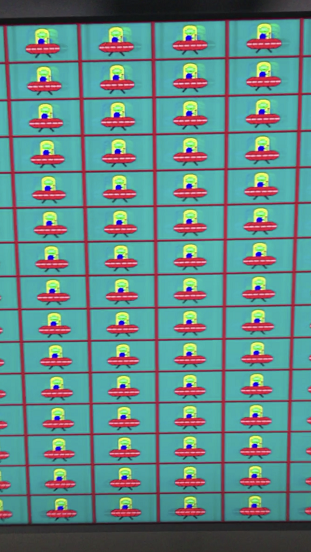

Better Glimpse at 60hz Single-Strobing Scan-Out Behavior on Vizio P65-F1
This is only at 240fps and the iPhone 7 gives me no other info as to shutter speed or the likes. My more advanced camera app doesn't have a slow-motion option either. I was going to post this much sooner but I really wanted a 960fps camera. One day, one day...

Re: Vizio P65-F1 Pursuit Camera Tests and Review, 60hz Single-Strobing, 100hz, 120hz, TV BFI Discussion
Fullscreen Crosstalk: 120hz on P65-F1(top) vs. 119hz on XG270 for reference(bottom):
Source: Blur Busters User Ansive - viewtopic.php?t=5998&start=220
I used pursuits because the rolling-strobe makes pictures nearly impossible to take. I think the XG270 with pureXP does a little better, but the fact that they are this close is very impressive, especially considering the Vizio is at its maximum refresh rate. The Vizio struggles a little bit with the 100% response time so you can see extremely faint crosstalk even in the sweet spot.
P65-F1 at 100hz might be better if you're sensitive to crosstalk: MPRT is still ~1ms 100nits.
