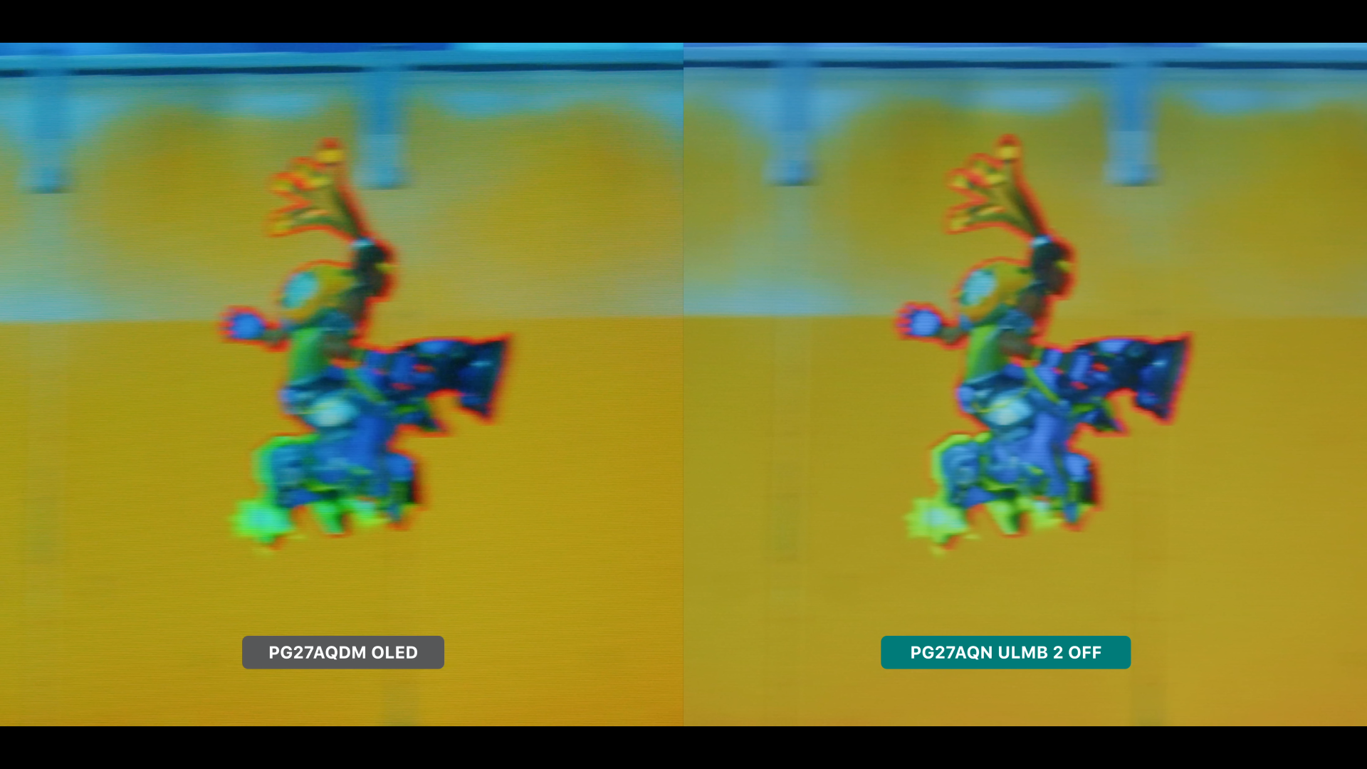

Why does the Asus IPS 360Hz here looks like it's outperforming the OLED 240Hz though? Isn't the OLED supposed to at least match performance of a 360Hz IPS panel if not achieving better results? Or is the Asus PG27AQN just abnormally good IPS monitor? (Picture taken from Optimum Tech's video)Chief Blur Buster wrote: ↑12 Mar 2023, 23:40240Hz OLED already has less motion blur than 360Hz IPS LCD.

(A) There is enough error margins between all the 360Hz models to slightly outperform/underperform the OLED.
(B) Also, there's camera tracking error margin. Also, since there's no sync track, it's hard to accurately pursuit game motion -- there is no proof of camera tracking accuracy.
(C) Even when the 360Hz LCD outperforms, you need to pay more to upgrade your GPU to allow 360fps instead of 240fps. If your existing GPU can only do 240fps, then a 240Hz OLED still outperforms the 360Hz LCD "at the same frame rates".
So there's a lot of error margins involved. But yes, some 360Hz LCDs (at 360fps) can slightly outperform a 240Hz OLED (at 240fps). But you need to pony up the 1.5x frame rate in order to barely do that. And you won't be able to on all 360Hz LCDs -- only the best ones. If your game can't do 360fps -- then ask yourself, is it worth paying extra for a faster CPU and GPU, to get the 1.5x frame rate performance, necessary to get these two side by sides?
Both have their pros/cons but they are quite subtle.

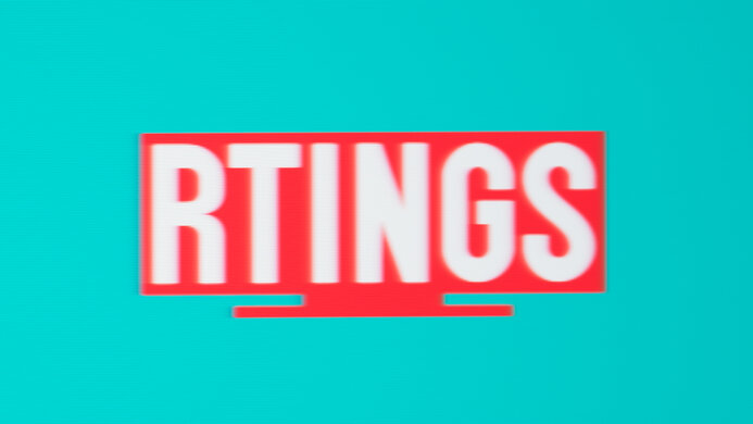

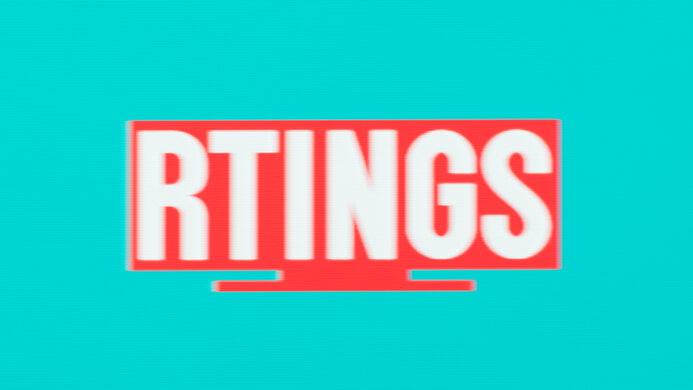

Re: 240hz OLED vs 500hz IPS advantages?
asus 360hz IPS
lg 240hz OLED
also has to be some human error element to these rting tests, i guess its up to the guy doing the tests to find the clearest image from several images
