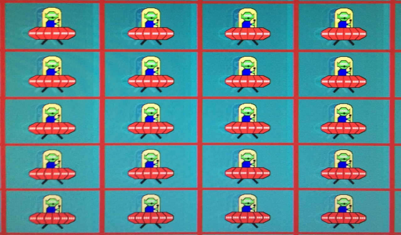

Note -- static photography isn't accurate as they can phantom-array with slower exposures. Even hand-waving an iPhone/Android to chasing the motion can capture motion artifacts more accurately. Unless that photograph shutter is a faster speed than refresh cycle (e.g. 1/240sec), the photo will usually show copies of multiple refresh cycles. So that photo is hard to interpret without knowing camera exposure length. (For a accurate capture of strobe crosstalk, we need to verify (A) camera shutter speed is much faster than one refresh cycle, or (B) if using a slow shutter, pursuiting the camera along the motion) Alternatively, I'll ask questions:
So a new question:
When you see http://www.testufo.com/crosstalk
Does it look closer to this:
(Two full-strength images in addition to faint images) (This is very abnormal)
Or closer to the below:
(One strong image, one or two faint images) (This is quite normal, IPS is usually slightly worse than this but not nearly as bad as above)
Head of Blur Busters - BlurBusters.com | TestUFO.com | Follow @BlurBusters on Twitter!
To support Blur Busters: Official List of Best Gaming Monitors | G-SYNC | FreeSync | Ultrawide
Posts: 3757
Re: 1440p Advice, XL2730/35 blur reduction. Best options?
Postby Coexist » 16 May 2017, 18:36
yes its definitely the exposure time on the camera making it look worse.
So I gave quake a go @ 144Hz no ULMB and no g-sync (minimum frame rate is about 160 anyway) and hmmm now I am very confused.
The image was more hazy and for want of a better word; blurry. BUT, once my eyes adjusted after 1-2mins playing it felt a lot easier to track players and felt sharper with less ghosting. Overall a better experience than ULMB mode.
I note the Overdrive is set to Normal when not using ULMB. Enabling ULMB turns OverDrive off.
Now I feel like with my old BenQ I had the clarity of blur reduction AND no(limited) ghosting, best of both worlds except for the washed out colours. But hey I guess that's the trade off.
UFO test without ULMB, 1 strong fuzzy image and 1 faint fuzzy image.
UFO test with ULMB, 1 strong clear image and 3 faint images.
