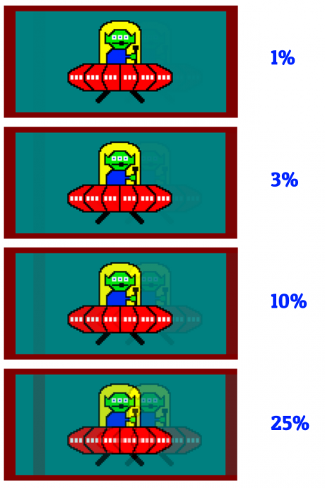

Let's consider how necessary/unnecessary GtG100% becomes.
GtG90% = creates 10% crosstalk, much like greylevel(255) versus greylevel(230)
GtG99% = creates 1% crosstalk, much like greylevel(255) versus greylevel(252)
GtG99.9% = creates 0.1% crosstalk, less than 1 shade apart in 8-bit spectrum (256 shades).
At one point, GtG completeness becomes below human detection.
Here's a chart:
Fact:
-- Obviously, VESA GtG90% (see Pixel Response FAQ) is not enough, but most people are fine with GtG99%.
-- Right now ViewSonic XG270 screen center can go better than GtG99% screen centre for 100Hz for most colors. Top/bottom edges are slightly crosstalky but majority of screen is crosstalk free.
-- Personally, I don't mind gaming at 3% or less (tantamount to GtG97% hidden in the black period between strobe flash, and the black period can be several milliseconds long), while others are super picky at 1% or less (=GtG99%)
-- GtG99% can occur several milliseconds before GtG100%, making it easier to hide in the black phase of the strobe flash cycle
-- GtG99% is a comfortabe threshold for most people. During high detailed scenes, the ultrafaint crosstalk disappears below noise thresholds except for scenes with lots of solid colors.
