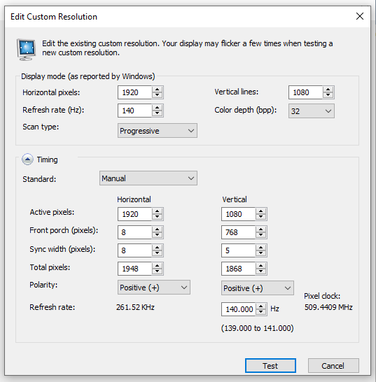

2. Create a Custom Resolution
The ViewSonic XG270 with the new firmware + PureXP™ enabled work best with 120Hz (Welcome "CRT IPS" style!)
so, simply choose this frequency in NVIDIA Control Panel or similarly in AMD Radeon Settings.
Now play your games with V-SYNC enabled (better if forced through NVIDIA or AMD Panel and disabled ingame)
or use the Low-Lag V-Sync trick, very well explained here and achievable thanks to a software
called Rivatuner Statistics Server enhanced by Guru3D.com and all the people around it!
In any case remember to have a frame rate equal to monitor herz (120fps=120Hz) with strobe enabled.
If you want to understand why, give a look here: As mentioned above by the Chief you can stop here and jump to Section #3, however if you're capable to handle all the power of that monitor, thanks to a modded GPU in the Section #1 or with a new/compatible GPU, we can make a special refresh rate
used in combination with Rivatuner Statistics Server: a large total vertical lines
to speed up the frame delivery from the GPU to XG270 (Quick Frame Transport Hack).
Note: new custom resolution info near the end of Section #2
Let me explain step by step: a proper way to manage and mantain clean all the info inside the monitor "driver" is possible via the Custom Resolution Utility made by ToastyX: Custom Resolution Utility (CRU)
After the extraction of the compressed software in a folder, launch CRU.exe
As you can see there's a lot of resolution and frequency combinations.
My suggestion is to clean and maintain only what you really need to easly select inside your games or applications.
In the Standard resolutions section we can remove all the things inside by pressing the Delete all button
Same in the Established resolutions section by pressing the None button
Now let's focus on the Extension blocks section by selecting the preconfigured
CEA-861 block and press the Edit button
Here, in Data blocks, we can select TV resolutions and remove them with the Delete button
Optionally you can remove HDMI support, because technically we are using the DisplayPort.
In Detailed resolutions section remove all with the Delete all button and next press the Add button
Look in the Timing section and choose "Automatic - LCD Native"
In Refresh Rate type 240 and confirm by pressing the OK button
Select the new resolution and press the Edit button
Click on Pixel Clock and Total then let's focus on the Total Vertical Lines:
To get a QFTx2 we have to do this calculation: (Total Vertical Lines x Refresh Rate) ÷ Target Refresh Rate
so, calculate (1125 x 240) ÷ 120 = 2250
Write the new Total Vertical Lines and looks at the changes in Refresh Rate
Enjoy the "overweight" 120Hz !
Continue to press all the OK buttons to close the utility and confirm all the changes.
To see the changes you have to reboot your computer or run the restart64.exe (64bit)
to restart on-the-fly the video driver.
Thanks to Chief Blur Buster we have received another great info about this monitor, capable to drastically reduce the input lag!
I have decided to leave the custom resolution on top for teaching and as reminder, but the preferred way
is to make the special 120Hz resolution with the exact parameters shared by the Chief
Use the NVIDIA Control Panel to create it (same if you're on the AMD Radeon Settings)
Lastly select Change Resolution from the left pane and choose the 120Hz refresh rate.

For those of you who want higher refresh rates but tuned in the same style of Chief here is mine at 140hz.
New Bitmap Image (15).png (25.18 KiB) Viewed 19778 times
You have to decrease the front porch in the same amount that you decrease the VT.
Here is what I did for 140hz.
Chief used 2180VT@120hz so I calculated 2180*120÷140=1,868.571, so I chose 1868 for my new VT.
I then calculated the difference between the VT. 2180—1868=312
I then removed that much from the front porch of what chief used. 1080—312=768

How is it possible to add this resolution settings in CRU? CRU marks vertical setting 1080 as red if you set it that high and doesn't allow to save the value. Is there any workaround? The reason why I want CRU is because using NVCP custom resolution prevents using 10 bit colors.
