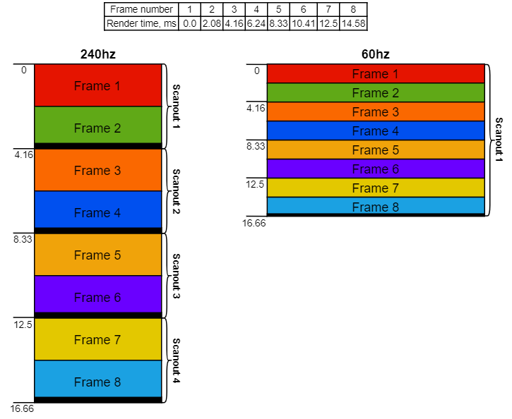

Let's step from another angle. Suppose that we are connected to 60hz and 240hz monitors simultaneously. Every frame is different color and as soon as frame is rendered it is being scanned out. Would this picture be correct? If so than what if now the frames are the CS:GO test and we know for sure that exactly at "Frame 7" the position of camera has updated. Wouldn't seeing "Frame 7" being scanned out happen at the same time for both screens?
EDIT: forgot to mention - the framerate in the picture example is 480 fps.
This is not something that occurs across multiple scanout cycles. The sample only appears within one cycle, and is positioned proportionately to the time span of the display's scanout:
^ There's you're possible max difference with the same positioning of the same sample right there.
In fact, in the context of our conversation (e.g. difference in possible max readings between the two), the amount of "input" lag doesn't even matter, just at what point in the scanout the sample ultimately appears.
Also, regarding your latest image, you can't quite "scale" 240Hz to 60Hz literally like that in this context; there are 180 more refreshes occurring per second. There's a reason they call it a "higher" "refresh" "rate."
The difference between the two isn't height, it's time.
So the frame count in the below image in this context for 240Hz would actually not be frame 1, frame 2, frame 3, etc. It would be frame 1 (or more accurately, "tear slice" 1), frame 2 (tear slice 2), frame 1 (tear slice 1), frame 2 (tear slice 2), repeat, as again, the sample we're taking with this "first reaction" method only occurs in one scanout per, thus each scanout is a reset in this context; a new opportunity for a new sample to appear:
As for how to compare a single 240Hz scanout against a single 60Hz scanout proportionately in this visual format, the above isn't right.
This isn't right:
This isn't right either:
It's more like this (like my example depicted at the top of this post):
E.g. if you have two identical 1920x1080 monitors running next to each other, but one is in 60Hz mode and the other is in 240Hz mode, they're both refreshing the same amount of pixel rows (top to bottom, left to right), but 240Hz is completing each cycle faster, so the physical "height" of the display the scanout occurs across is the same between the two.
The only difference is time.
So if everything but refresh rate was equal in the last image (which isn't quite logistically possible in reality where aligning the individual cycles of the two refresh rates is concerned, as 240Hz is always "ahead" of 60Hz, but let's go theoretical here), and a "bottom-of-frame" sample appeared within tear slice #8 at 60Hz, an identically positioned sample (in direct, proportionate relation to the given scanout time of a single cycle at the given max refresh rate) would instead appear within tear slice #2 at 240Hz.
And thus, in this particular case, the 60Hz sample would appear at the ~15(ish)ms position, while that same sample at 240Hz would appear at the ~3(ish)ms position. AKA, you see that same sample at 240Hz sooner.
TLDR; When compared to lower refresh rates, individual updates, at higher refresh rates, regardless of framerate or sync/no sync have the potential to be seen sooner within the individual scanout cycle they appear in, as individual scanout cycles become progressively shorter in duration the higher the refresh rate becomes.
Anyway, that's all I've got. Hope it's clearer for you.

No, and correct me if I'm wrong here, but I think I now know what you're misunderstanding...
Am I right in assuming you think since four 240Hz scanout cycles can fit in the span of a single 60Hz cycle, that this is what the two refresh rates look like when directly compared?
Because if so (as I hinted in my last post), that's not correct; just because four 240Hz scanout cycles can fit in the span of a single 60Hz scanout cycle doesn't mean they scale that way in practice.
So what does it actually look like then? Well, while the below isn't 100% accurate/to scale (none of this is really, just a conceptual visual aid), it's more like this, and should give you better idea on why 240Hz (or any higher-than-60hz refresh rate) has less delay and a lower min/max average than 60Hz, even at the same framerate with V-SYNC off:
^ 240Hz has already had nearly four complete scanout cycles before 60Hz is even on its second.
And then we're back to why 60Hz has a higher possible min/max reading range (along with higher averaged readings) when the sample finally appears (using the "first reaction" method):
Does that make it any clearer?
Again, the point is, both refresh rates in like-for-like situations are showing the same information in sequence, but one is behind. It's similar to how V-SYNC with framerate above the refresh rate causes increased delay; you're seeing the information in perfect sequence, but it's more behind your input than if you had V-SYNC off.
E.g. scanout time can also ultimately be considered a form of additive latency when directly comparing a lower refresh rate to a higher one.

First, thank you for your answers, jorimt, Chief! I apologize if the reply was late, that was unintentional. So I think I got it. jorimt's final explanations almost made me understand however only after Chief's answer I understood what was exactly going on and only after that I finally got what jorimt was trying to tell me (rereading answers now and it's clearer where my misunderstanding was).
jorimt wrote: ↑
25 May 2020, 19:28
pic
Yep! That's exactly how I imagined it.
jorimt wrote: ↑
25 May 2020, 19:28
pic
I understand now what this picture was about but first time I saw it I couldn't wrap my head on the scales. The problem was that I didn't understand that "16.6ms" was about cable scanout and that panel in this case was scanning out at 1/240s speed.
28 May 2020, 11:45
I would bottom-align the 60Hz like this, however:
pic
Scaler/TCON scan conversion "compresses the scanout downwards" towards the time delivery of the final pixel row. So about 3/4ths of 60Hz scanout is delivered before the panel begins refreshing at full 1/240sec velocity.
So this is what made my mind finally click. Thank you. By the way interesting read as always.
That said, to be clear to @hmukos and others reading this, 60Hz still typically has slower overall delivery (and thus higher possible min/avg/max readings using the test method in the article), with or without sync, when directly compared to 240Hz at the same FPS (more or less depending on the cable method) due to the raw difference in scanout time between the two.
Yes, I understand now. So I assume it is correct that the 12-13ms Min and Max input lag variation comes from mismatch between cable scanout and panel scanout? Would Min and Max be much closer if the test was made on pure 60hz monitor with 1/60s cable and panel scanout?

Post by Chief Blur Buster » 31 May 2020, 16:09
hmukos wrote: ↑
31 May 2020, 15:25
jorimt wrote: ↑
25 May 2020, 19:28
pic
Yes, normally scanout is identical on cable and panel. It's the divergence that muddies the confusion.
Glad I helped clear this up!
28 May 2020, 11:45
You're welcome. Probably going to convert this into an article as soon as I have spare time.
28 May 2020, 11:45
For VRR 60Hz on 240Hz, the interactions get a bit complex since we're now doing three interactions (sync technology versus cable scanout versus panel scanout).
But yes, for 60Hz native, Min/Max will narrow for VSYNC OFF latency, since no buffering is occuring, the frame will tear-into the scanout at a constant time offset from the signal (tiny, sometimes sub-1ms), for realtime cable-to-panel scanouts. With tiny rolling-window buffer processing.
