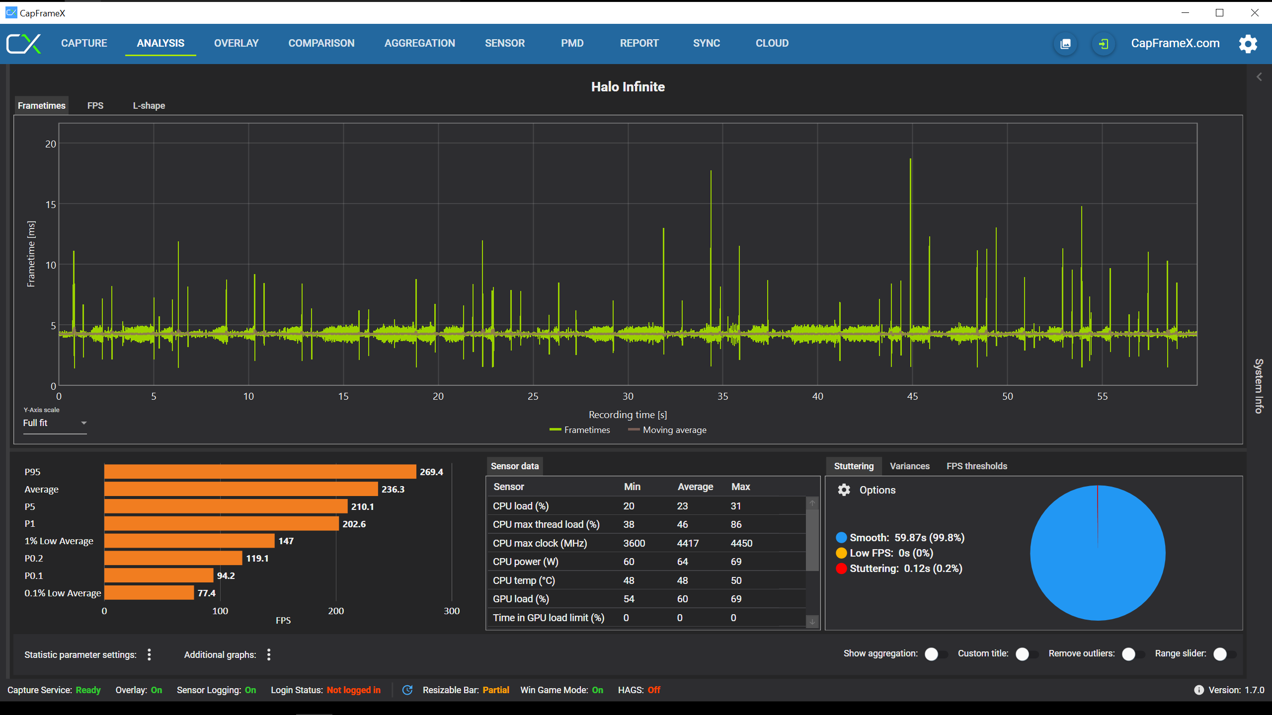

However aside from screen tearing I’ve been noticing micro-stutters and sudden frame rate halvings while camera panning on the three games I’ve tested, which are Apex Legends, Destiny 2, and Fortnite. My fps is stable with no drops whatsoever when it happens.
I did thorough stress testing on my CPU (5800x3d) and GPU (4090 FE) and they’re both perfectly stable. Also formatted every drive and did a fresh windows install with a USB drive but I’m still getting the visual glitches. I did some troubleshooting with an Nvidia tech and they had me change NVCP power management to prefer maximum performance. After doing so the visual glitches were gone temporarily but came back the following day. I also tested a different gaming mouse and installing the games on a different SSD drive but the problem wasn’t resolved.
Can you think of anything else that can be causing this? If you have any suggestions it’ll be much appreciated.
