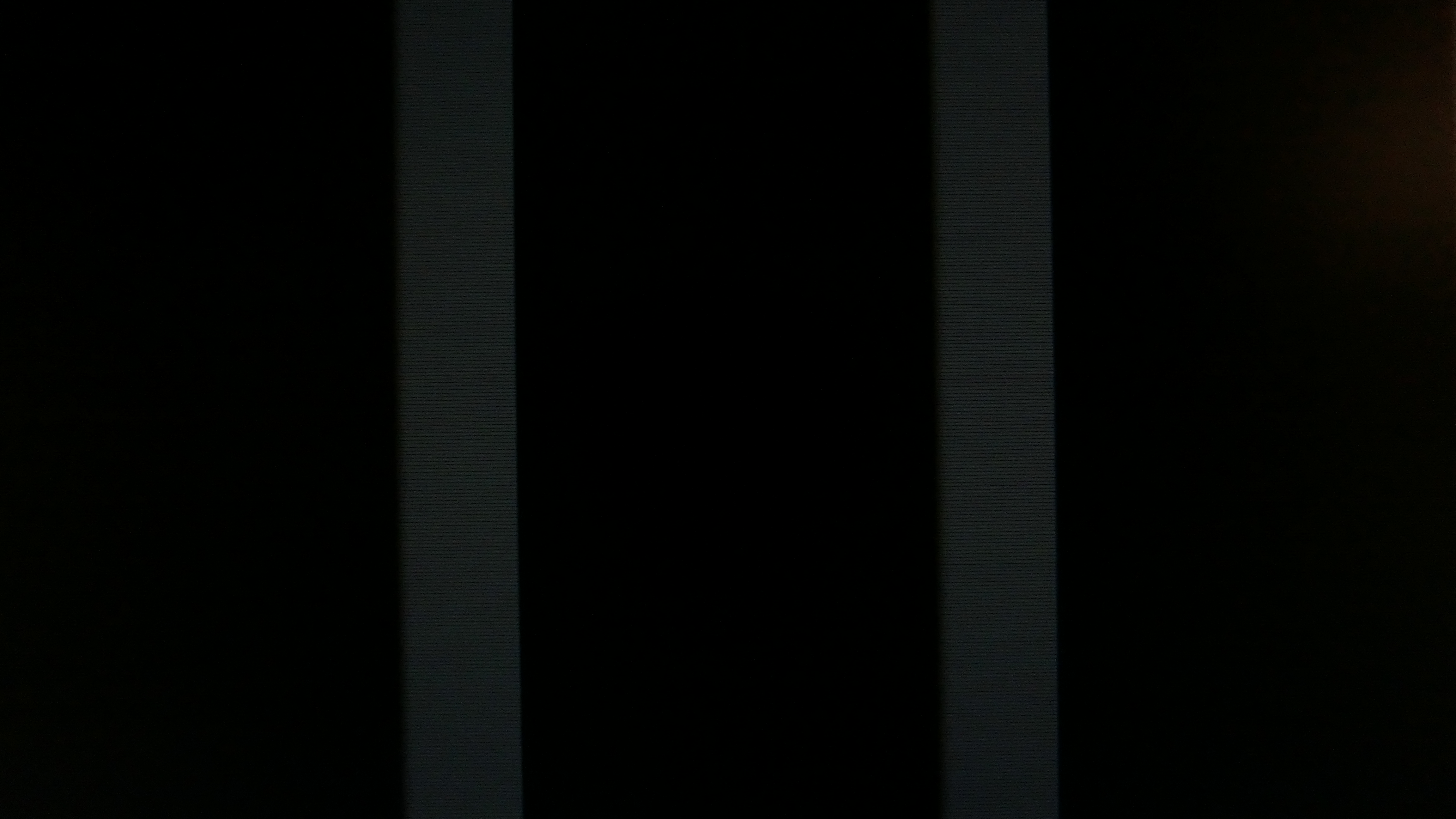

Camera proof of ASUS VG248QE monitor being PWM-free, via TFTCentral moving camera method.
Photography Info: Casio EX-ZR200, 1/125sec exposure, non-strobed mode, camera sliding very fast horizontally on a Drylin W-1080 Camera Slider Rail (which I use for pursuit camera tests) at approximately 1 meter per second slide speed, from a focus distance of about 4" away from the monitor plane. The horizontal lines are the unblurred screendoor effect (gaps between pixels), due to the high precision of the camera rail (and confirmed not a rolling-shutter effect on HiPWM).
Without sliding:
Camera sliding very fast at 1 meter per second:
Zero PWM. At 1 meter per second, a 1/125sec exposure (one refresh cycle) blurs the one-pixel thick line by more than 20x width. I've been able to detect 10KHz PWM using a 1 meter/second camera sliding speed, but I see zero PWM in this photo.
Without sliding:
