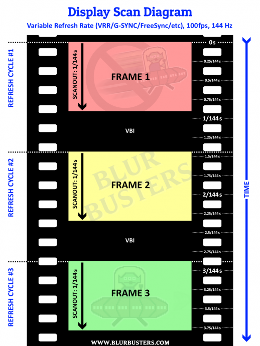

First, get familiar with Understanding Display Scan-Out Lag With High Speed Video, and realize that not all pixels refresh simultaneously. Now, after playing those high speed videos at the above link, come to this post, and study this graph:
What happens is that when a refresh cycle occurs on a VRR monitor
1. Not all pixels refresh at the same time.
2. It takes (1/Max Hz)second for a monitor to finish refreshing.
3. Monitor is "busy" scanning out a refresh cycle for (1/Max Hz)second.
4. Therefore, your monitor is busy for 1/75th second once it's begun a refresh cycle (whether a fresh one or a repeat-refresh one)
5. Repeat refreshes occur automatically when your frametime exceeds (1/Min Hz)second -- In your case, 1/52sec.
6. If your monitor is below VRR range, your graphics drivers will automatically begin repeat-transmitting a refresh cycle no longer than 1/52sec.
7. During this time your monitor is automatically busy for 1/75sec right after that, which means it will "block" the next frame (ala VSYNC ON behaviour) until it's finished that repeat-refresh scanout pass.
8. That length of "blocking wait" creates a stutter + slight amount of lag. The wait length will depend on when the next frametime is between (min-vrr duration) thru (min-vrr duration + scanout time). For you, that's a time range of (1/52sec) thru (1/52sec + 1/75sec). That's a range of 19.2ms frametime through 32.5ms frametime for your specific monitor (1/52=0.0192sec) and (1/75=0.0325sec).
9. If the new frame arrives between those two frametime (e.g. exactly between 19.2ms and 32.5ms), your monitor will block the next frame (next refresh cycle) until 32.5ms after the last successfully-begun refresh cycle. Because the monitor is still unfinished scanning out the repeat-refresh.
Low framerate compensation requires a wider VRR range, more than 2:1, so that the monitor/drivers can intelligently repeat-refresh quickly enough not to collide with an attempted frame delivery while the monitor's still busy refreshing the previous frame. You need at least 2:1 for LFC (Low Frame Rate) compensation algorithms, preferably 2.4:1 because repeat-refreshing essentially doubles Hz, e.g. 24fps LFC is 48Hz on a display that has a "30Hz-144Hz" VRR range. Now if your range is not big enough, that means LFC is impossible, and you're permanently stuck with a narrow VRR range.
