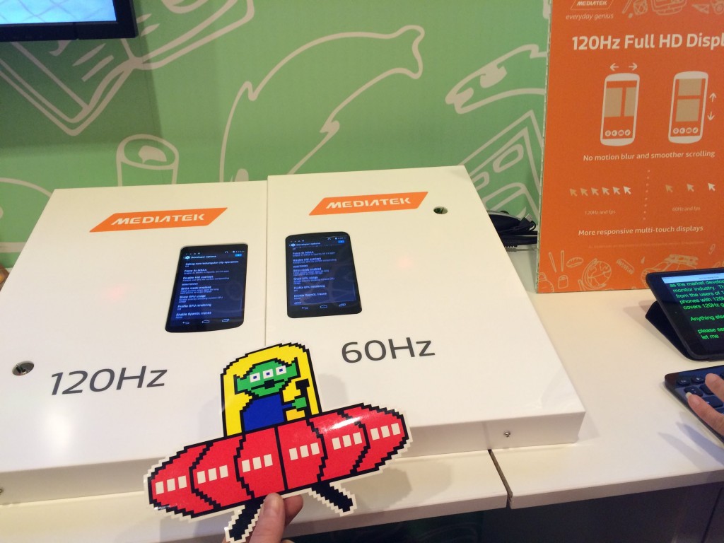

At CES 2015, I saw 120Hz LCDs being tested with in smartphone factor:
From what I know, several 60Hz LCDs can be overdriven to at 120Hz frequency with few effects. Someone overclocked a 60Hz laptop LCD to 180Hz successfully in an unmodified way.
