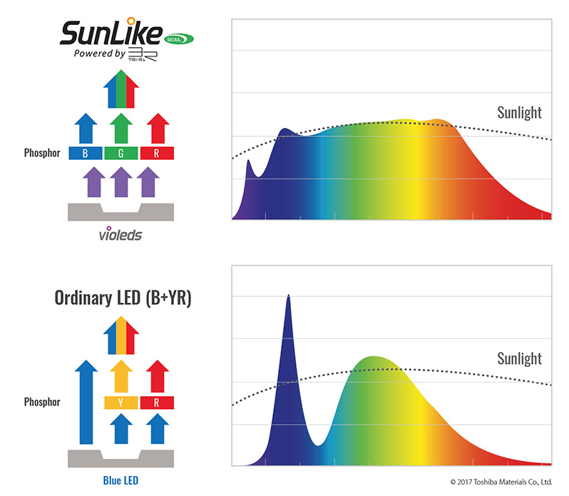

A whole 1000 inscandescent bulbs? Wow. I would think that CRI 97 LED would do you fine (the ones with violet chip that illuminates a more incandescent style blue/green/red curve from advanced phosphor mixes). Those new LEDs are amongst the most incandescent-looking LEDs I've seen. A 5 meter of true CRI 97 LED ribbon cost about $100 at the moment. Daylight 6500K is a common doctor recommendation but is not nearly incandescent looking. Some LED lightbulbs with CRI 95 and up can cost about $20-50 dollar each which is about 20 to 50 times more expensive than Walmart LED bulbs. Just pair those up with really, really good LED dimmers. Currently I use cheaper CRI 90 IKEA LED light bulbs (vastly superior to cheap $1 CRI 80 LED bulbs all over Canadian Tire / Walmart / Home Depot / Rona / Lowes / Etc) but the CRI 95-97 stuff that use those new "violet" LED chips produce quite luxuriously incandescent-like light. The amount of violet emitted from those is actually really negligible (compared to the amount of blue light in today's LED) when converted quite fully by a modern efficient multiphosphor mix that mimics an incandescent curve.
Look ma! No blue peak, no blue pain. The violet peak is piddly in comparision, being converted to great, wonderful, natural looking full spectrum LED light. The holy grail of replacing the incandescent bulb, it's so amazing pleasing to my eyes. The new CRI 97 lightbulbs are the bee's knees if you can afford them, though you still have to order them online, as they're not in your Canadian Tire or Walmart store.
Once these new LED chips are used in monitor backlights, then monitors will become much more eye-friendly. Hopefully. Though, other factors remain (e.g. blur, stutter, brightness, etc).

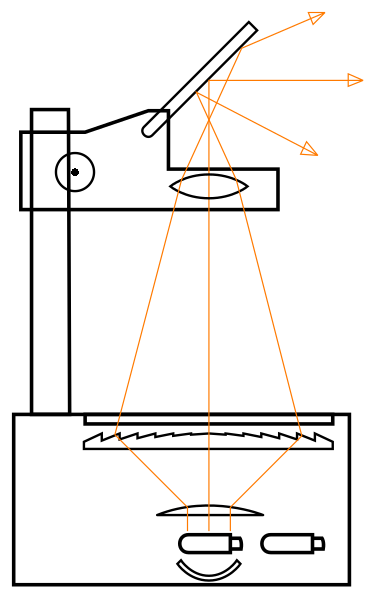

There is another inexpensive option. You can completely replace the backlight of the LCD monitor with incandescent or gallagen lamps.Jason38 wrote:I own over a 1000 incandescent light bulbs.![]()
Any help would be greatly appreciated. Thank you.
example https://www.youtube.com/watch?v=b7lWqKHpGuc
in my country, a used overhead projector costs about $ 30, size from 13-19 inches LCD+special reflective fabric on the wall.
Believe it is not so terrible as it seems at first glance.The only problem is that it will take up a lot of space. But in your particular case, this could be one of the acceptable solutions.

I find it hard to imagine how far a person can go who keeps a stock of 1000 lamps.
But if you still like this option. No problem to collect your own box for any size of the monitor matrix. By purchasing a suitable sized Fresnel lens.
- Overhead.svg.png (22.21 KiB) Viewed 24551 times

Yes, I have heard of incandescent-backlit LCD screens. Including 4K. You buy an old 1970s slide projector, remove the LCD from a monitor very carefully, and mount it on top of those old school classroom projectors. Incandescent backlit LCD!
Or you can use other high-CRI light sources. Most LCD backlights have long been crappy CRI 70 or CRI 80 LEDs with massive blue peaks, and the sooner that goes, the better. Good violet-chip LEDs are much more eye-friendly, but are way more expensive. Theoretically you could retrofit an ordinary CRI80 LED edgelight with a CRI97 LED edgelight, but it's very hard to replace an edgelight because it's often a custom circuit along the edge of a screen, and can be easier to just do the "overhead projector hack" for your LCD screen.
