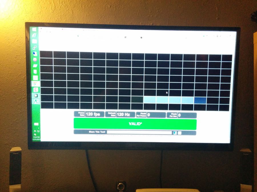

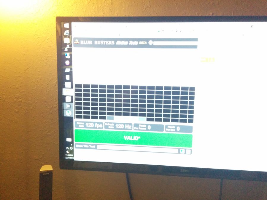

p0ser wrote:For those interested, member @chuckfagan
 has discovered that flashing the 50" firmware on the 39" solves the frames kipping @ 120hz.  I can independently confirm that it works as well (1920x1080 res)
leeleatherwood wrote:I just flashed the 50" firmware on my 39", it works.
EDIT: Sharpness setting in the menu doesn't function, you can change the setting but it doesn't change the sharpness at all. (correction, it seems to work over HDMI but not DVI, wierd)
I was using the sharpness setting as a form of pseudo anti-aliasing at 1080p to make text look better, but I cant do that anymore. 4k reso is fine obviously.
EDIT: Mouse lag at 4k is MUCH improved with the 50" firmware. With the 39" firmware it was pretty unbearable to me and I found myself using 1080p constantly. Now I have no problems running 4k.
leeleatherwood wrote:My 39" @ 1080p 120hz, no frame skipping with the 50" firmware.
