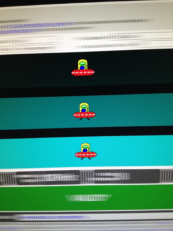

Post by Denonic » 01 Jun 2016, 04:11
AMA is most definitely doing something for me through displayport with ULMB off while G-Sync is off.
Off I have a clear yellow streak behind the UFO cockpit, High - its gone, Premium - I have a blue streak.
After turning G-Sync on the AMA menu gets locked (I can't push the right OSD key to get to the off/high/premium options) but the setting I left it on still remains applied.
Not sure if there is a different firmware or if the settings are different based on gpu. I'm using a GTX670.
ULMB on @ 120hz for me looks like its stuck with inverse ghosting and switching AMA settings does nothing for it.
Trying to take photos but all I've got is my phone and it can't capture it. Will borrow an SLR sometime and take photos.
Not doubting that yours doesn't do anything but mine definitely does and my ULMB has terrible ghosting. I'd just like to figure out why.

Unfortunately not =( my whole screen has an even dose of bad ghosting during ULMB over displayport that looks similar to your first image on the OP. Not sure why it's so different. I've tried to put phase down to 0 and it helped a tiny bit but nowhere near your example.

Haven't gotten a hold of a DSLR yet but this is the best image I could take with my iPhone of the ghosting. I had to my my hand with the screen but it turned out a bit better than I expected.
This is with ULMB on the displayport. The ghosting is similar to the BBR comparison pics and I've changed settings relentlessly to try and get it looking like yours. Seems like there may be hardware discrepancies in the display chain somewhere.. What graphics card are you using lexlazootin?

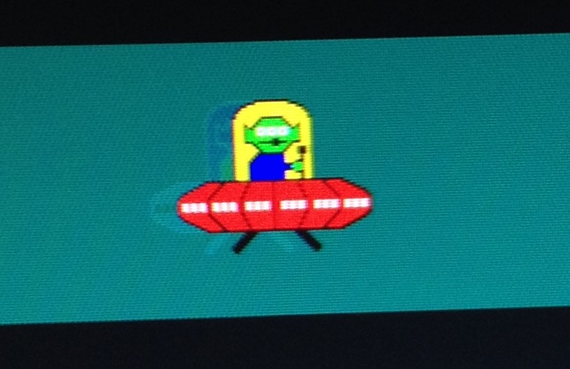

Post by Denonic » 04 Jun 2016, 23:16
SUCCESS! I tried it on a different computer, different GPU and it looked completely different with vastly less ghosting.
Plugged it back into my original computer with the GTX670 and it now looks perfect... Lesson learnt.. check cables. Must've not been fully seated in the first place and during replug ended up sitting correctly.
Heres the image after I replugged (still no DSLR but I'm getting pretty good at pursuit shots with my iphone :D ):
Friggin perfect overdrive and motion.

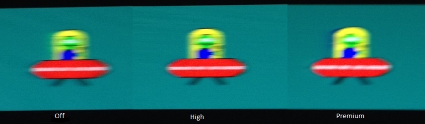

Just for kicks heres an AMA overdrive comparison without ULMB in GSYNC mode @120hz (144hz is probably cleaner):
AMA comparison.jpg (46.82 KiB) Viewed 9887 times
High AMA puts out a near perfect overdriven image whereas the off/premium settings have ghosting and inverse ghosting respectively.
Theres pretty much no reason for me to use the classic mode now as I can't feel the <1 frame input lag difference.
