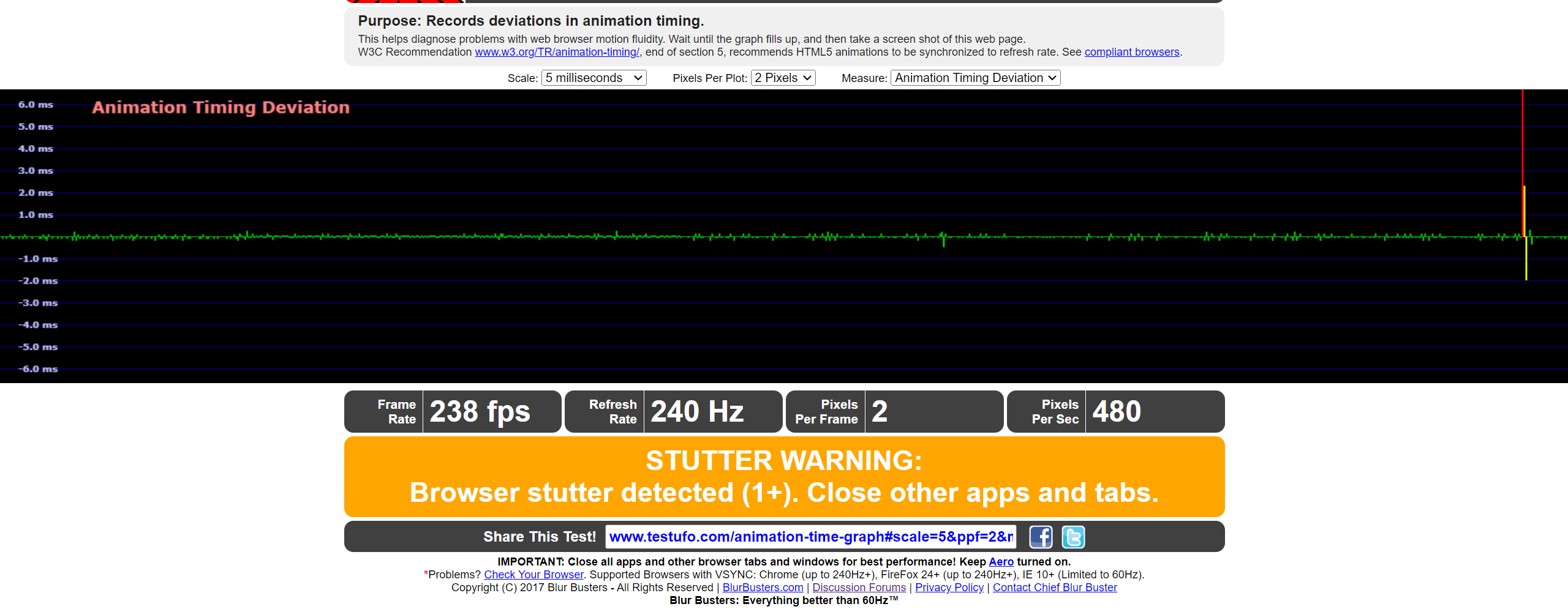

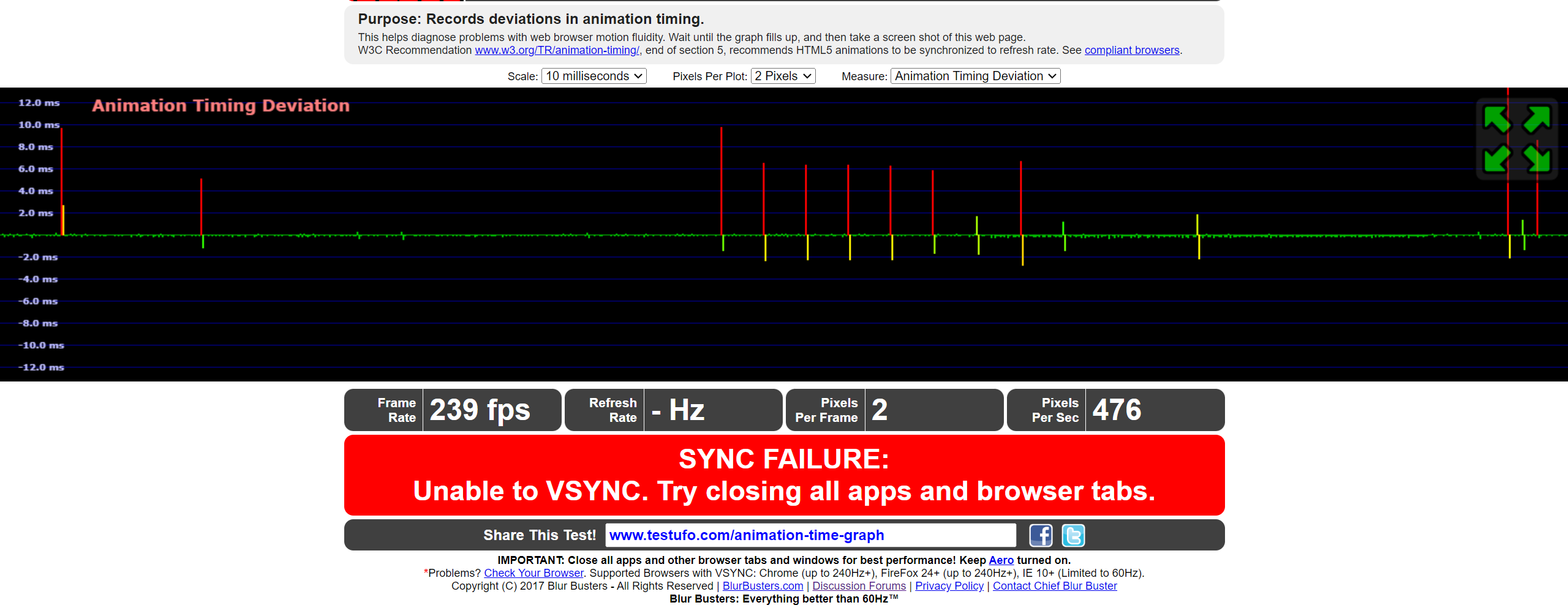

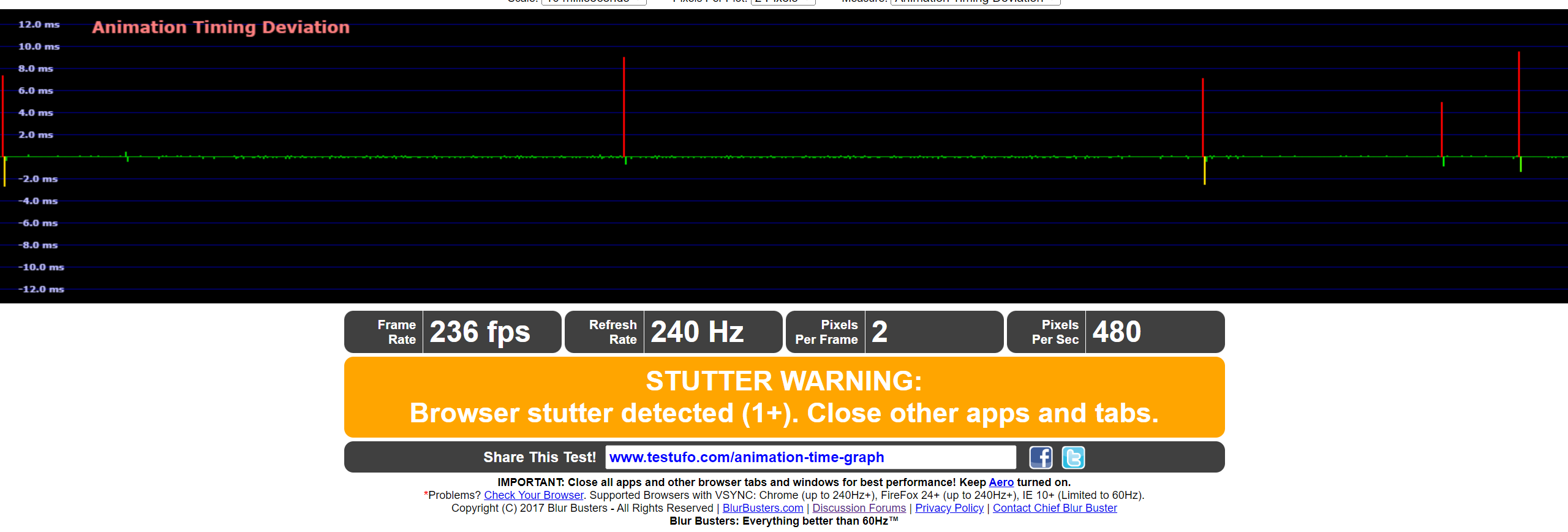

Somewhat systemic stutters, but NOT with integrated graphics
- NVcleanstall
- ufo debloated.png (183.55 KiB) Viewed 6295 times
- those are very frequent, but not consistent at all
- ufo bad 2.png (141.73 KiB) Viewed 6295 times
- those are happening not all the time, but once like 10-20-30sec.
- UFO bad.png (195.51 KiB) Viewed 6295 times

This is usually simply to background processing, and this is quite normal for an average gaming laptop.
Browsers are much more sensitive to stutters than games are.
Are these causing any problems for you outside TestUFO?
If not, this type of very occasional stutters is usually not a cause for concern, it can simply be security checks being run by Windows in the background, to other things. You say that it runs smooth for 5-10 seconds. Even things like mouse movements going over a button or title bar, can cause these stutters in browers that never appear in games.
Browsers can be great troubleshooting canaries in coal mine for stutter problems elsewhere in the system, but sometimes they're just generally harmless if it's only affecting TestUFO and no other software. Often a lot of threads in a web browser is running at low system priority compared to other things in a system.
Now, if you have a persistent cyclic stutter (e.g. once a second) and you do feel a tiny stutter in games every second, then you definitely can use TestUFO as a canary in coal mine to try to troubleshoot that out. Even things like running Task Manager can add stutters, since Task Manager queries the system once a second to get data, and the process of system self-troubleshooting itself can add stutters. Even Dropbox/OneDrive/Box/iCloud/etc syncing can add background stutters.
That being said, those are quite large spikes, and there MIGHT be something wrong, but it is not a specific systemic pattern. Does this still happen excessively frequently when you are running in full screen mode with no keypresses/mouse movements, and in Performance Power Plan?
If these stutters are injecting in games even in low-CPU/GPU-utilization games (old engines, etc), then additional diagnostic utilities might help track these down to a specific background software app or service. Temporarily turn off your RGB software and cloud-sync software, as well as other things that automatically run in the background, and see what happens.

Re: Somewhat systemic stutters, but NOT with integrated graphics
Thank you for the info! The only reason I noticed something isn't right is because youtube is dropping frames and the whole system doesn't feel quite responsive. Haven't tested a lot in games so I cant say for sure if it's affecting them. And clean drivers fix youtube stutters and system feels better (although it's subjective and I might be wrong). I'm just gonna dig deeper and if I find anything related I'll post here.
