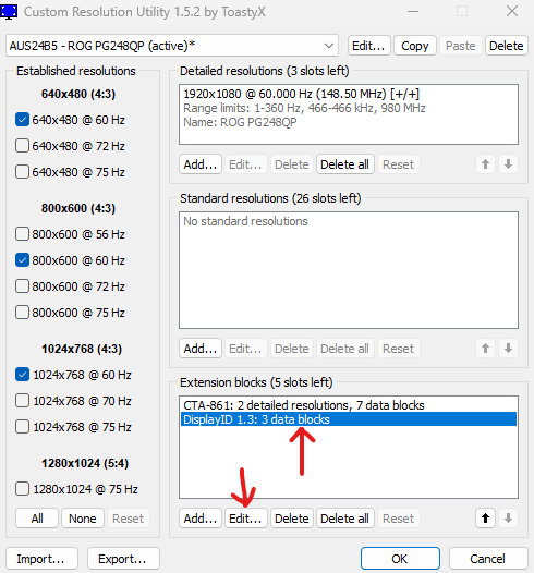

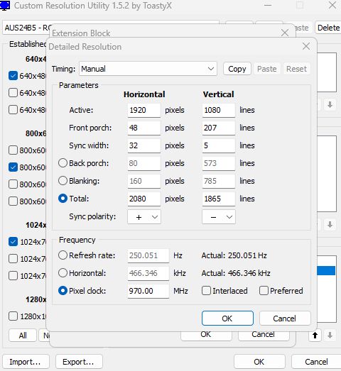

This ULMB hack works for refresh rates below 360Hz. I was able to make a custom resolution at 250Hz and enable ULMB.
UFO Ghost Test is night and day difference at 250Hz no ULMB vs ULMB enabled with custom pulse offset in the OSD menu.
I'm still experiencing the light colored vertical line artifacts on my screen at certain pixels/sec of motion. I'll probably RMA my monitor to see if maybe a newer unit has it fixed.
I follow the guide also. I put Total 2000 Horizontal pixels. Vertial 1195 lines.
Pixel clock 597.78 Mhz
Actual: 250.117 Hz
Actual: 298.890 kHz
Press Ok then restart64.exe in Cru.
Black screen for 15 secs. Cannot choose 250hz in Change Display Settings -> Display adaptor properties:
Can u tell me your settings please?

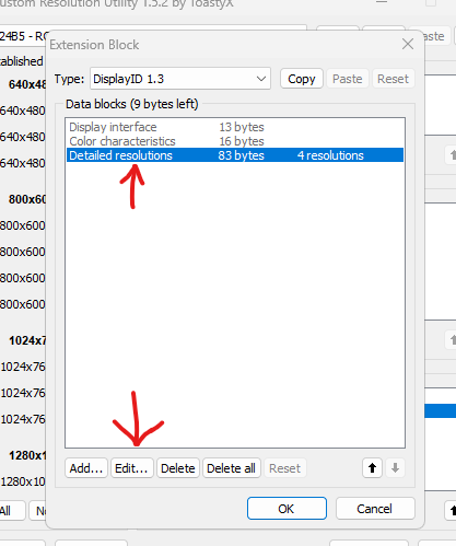

daviddave1 wrote: ↑
17 Feb 2024, 08:19
Turn off Overclocking in the monitor OSD, apply these CRU settings, and then run Restart64.exe. After that just select the 250Hz refresh rate like normal and turn on ULMB. The monitor OSD will report 360Hz (if the OSD is glitched looking, pull the monitor power plug and plug it back in) but if you run the UFO Ghost Test you will see it's actually 250Hz. Don't forget to adjust the ULMB 2 Pulse Offset to your liking in the monitor OSD while running the UFO Test.
Once you've got all of that done, see this post from the Chief about the QFT 250Hz + Quadruple Motion Sync in 250FPS locked games.
viewtopic.php?p=99425#p99425
step 2.png (26.52 KiB) Viewed 64357 times
step 3.png (41.41 KiB) Viewed 64357 times
