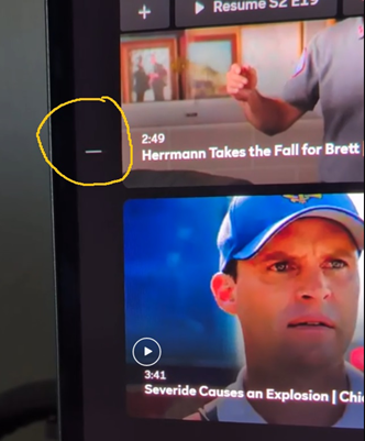

What causes horizontal white line flicker?
Post by Dreamic » 01 Mar 2024, 22:36
I have this issue and can find numerous reports on all kinds of displays from QDOLED to WOLED, LG, Dell/Alienware, MSI 27" and 32", etc. But I never find an explanation or a real solution, I don't know if people give up, get a replacement, or it magically disappears and they don't say anything. The only "solution" for my MPG 271QRX so far seems to be lowering the refresh rate to 240Hz from 360Hz. Why would this be? I tried experimenting with CRU, but with this display specifically it seems to completely ignore it. Seems this may be because DSC seems enabled at all refresh rates and resolutions. Maybe it could be DSC artifacts at 360Hz and its somehow stable at 240Hz? Supposedly MSI will be releasing a firmware allowing DSC to be disabled, but even with its full 48gbps HDMI 2.1 port this won't allow 360Hz 1440p atleast at 10bit. The included cable is certified by the way, and the issue still exists regardless of monitor port or GPU port, same applies for DisplayPort. Also not VRR related, same issue on or off. The lines can go minutes without appearing, and appear in random locations, and vary in left to right width. I don't know if there's a specific way to trigger it. I'm also on the newest version of Windows 11 and Nvidia drivers (3080) and monitor firmware. I don't know if there's much else I can add

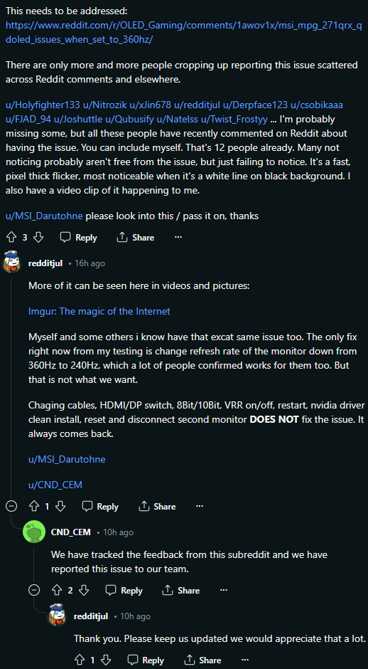

Me and another guy have been trying to brainstorm possible solutions and try things one by one, at this point I @'d MSI on Reddit with basically everyone I could quickly find so far who have reported the issue in various places there, 12 people.

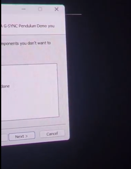

Screenshot 2024-03-04 103139.png (82.55 KiB) Viewed 17256 times
I also submitted a ticket to MSI etc. So hopefully something comes from this, they're easier to reach than Nvidia or Microsoft (if it was one of their issues) and if it were, MSI would have an easier time with whatever connections they have.
Also, they have previously said they're working on a firmware update to disable DSC, which I think would allow CRU and custom res in NVCP to work. However, 360Hz 2560x1440 at 10bit still wouldn't work without DSC even with its proper full 48gbps HDMI 2.1 so... You would have to lower refresh rate, run 8bit, or hopefully they just get the full potential working flawlessly with DSC.
Don't think there's much more I can do, got MSI's attention as much as I can.

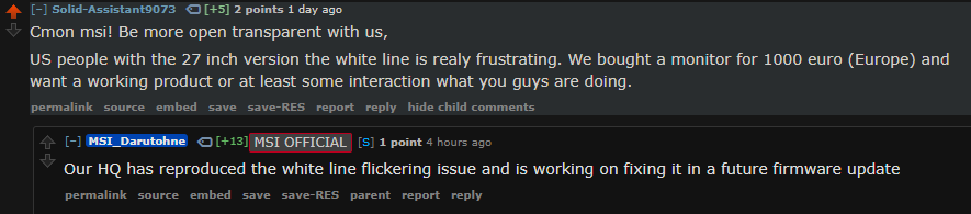

I've been hoping for a firmware fix, even though it seemingly doesn't seem exclusive to this panel or even Samsung/QDOLED somehow... MSI seems to have said they're replicated the issue and are looking how to solve it, which hopefully they can.

Anyways fingers crossed. MSI probably also doesn't want to say this is a known issue that affects all panels until they are sure they can fix it... imagine acknowledging that publicly and then not being able to figure out or fix it.
