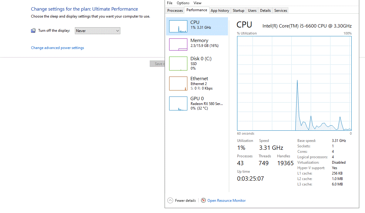

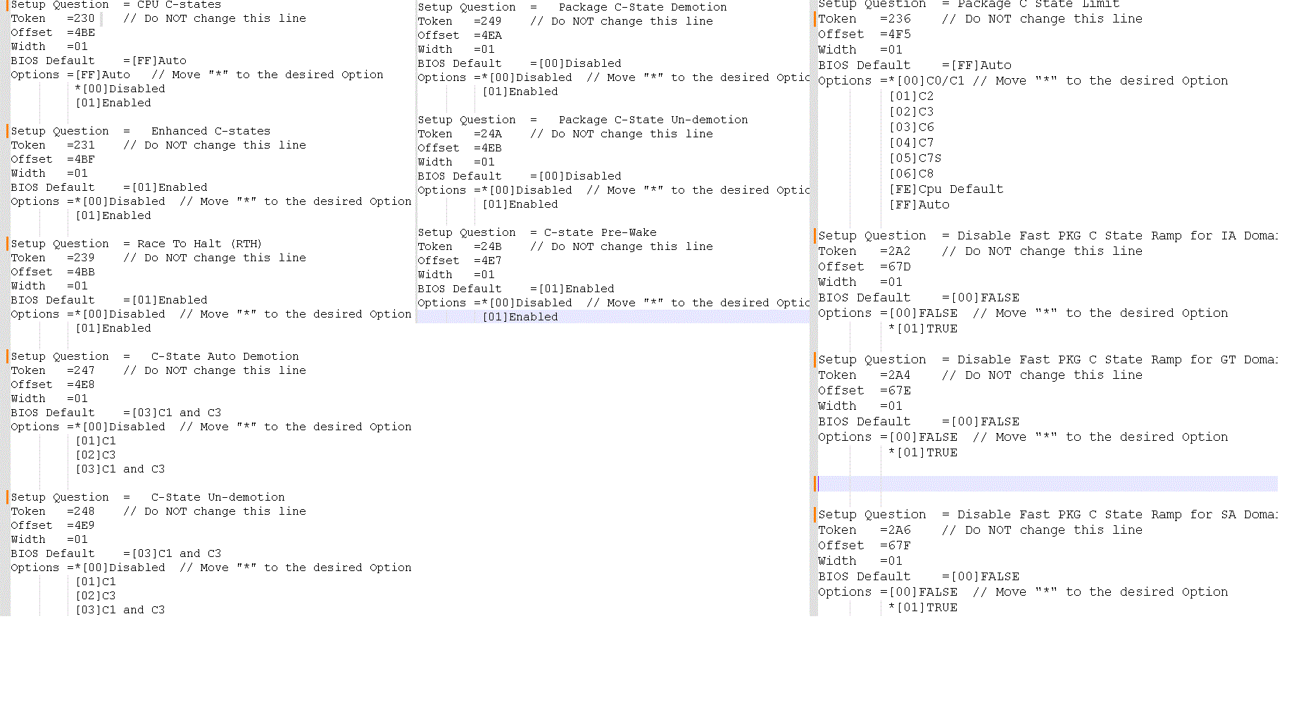

So guys i did not get anything,so i have i5 6600 in the intel site it says "Intel® Core™ i5-6600 Processor 6M Cache, up to 3.90 GHz" i have it for 2 years i have never seen go above 3.3GHz,so guys how can i test and see if i must disable all c-state like show on the picture,and then just enable "Intel Speed Step Technology".Because right now all the c-states are off and "Intel Speed Step Technology" is off.And it task manager says 3.31ghz.
3.9GHz is only when 1 core is being utilized but for all of them it should be 3.6Ghz make sure you on high performance power plan
i am still no diffrence.
